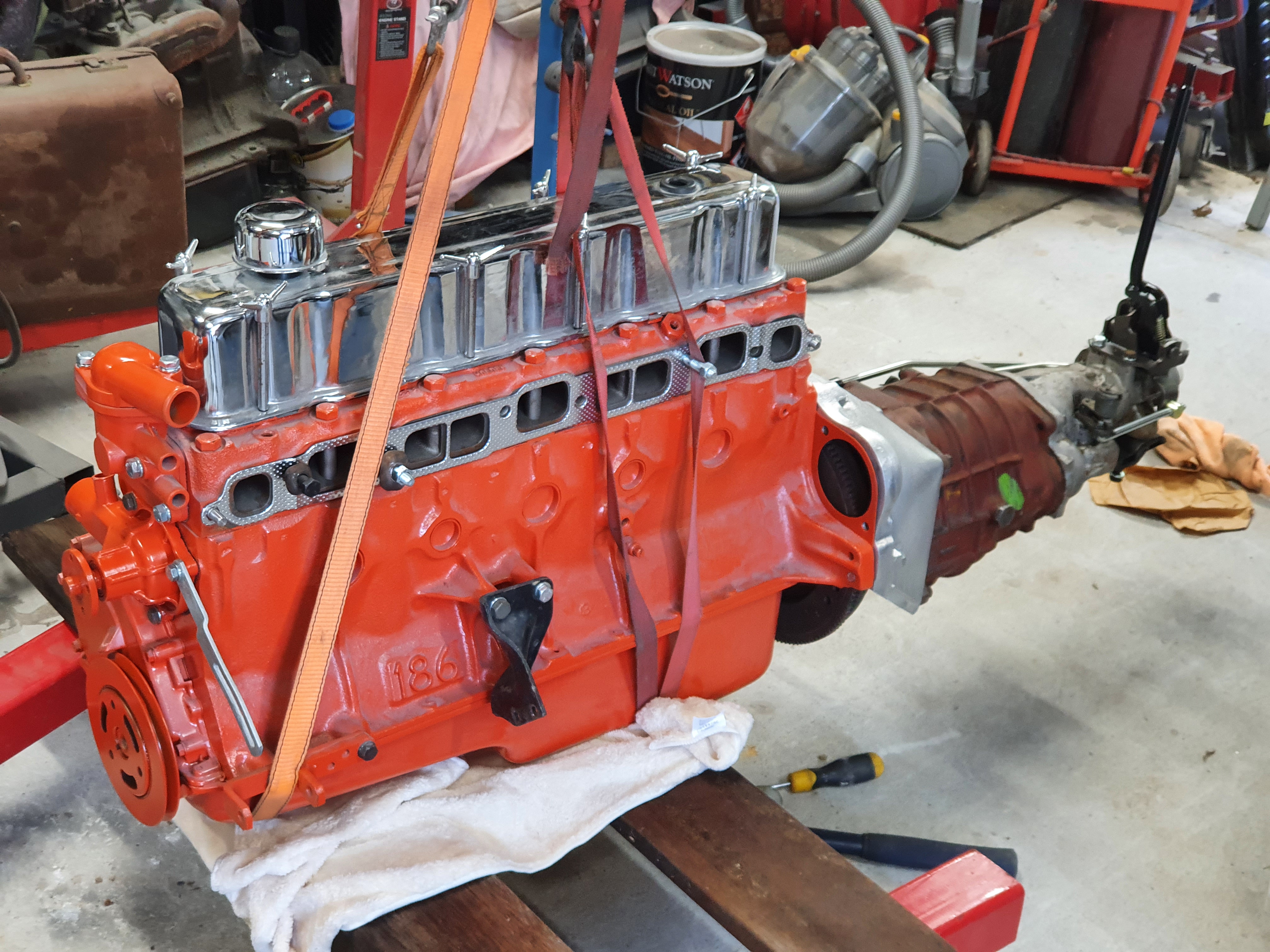

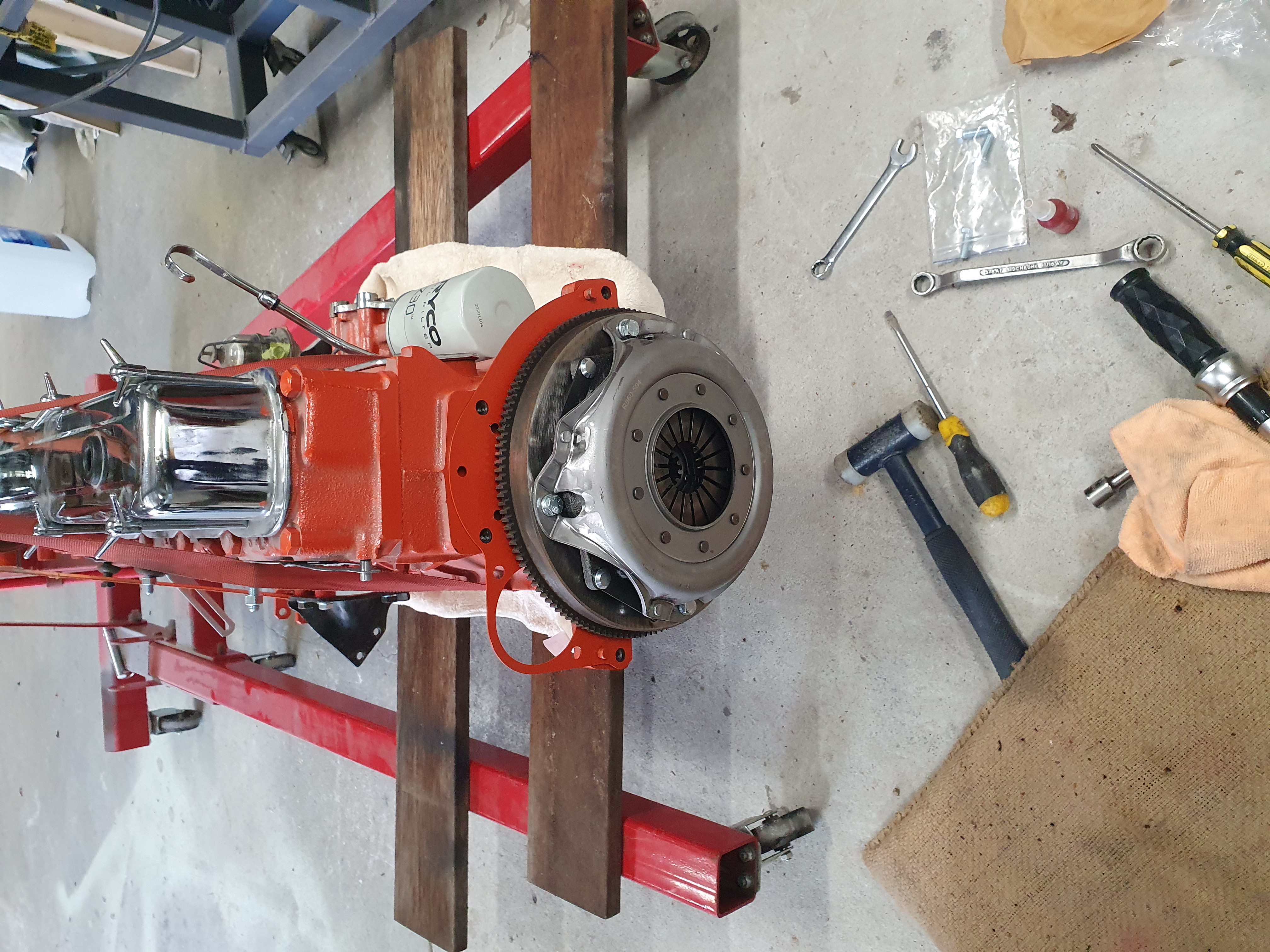

Flywheel and clutch thingys on, connection with the mighty 186 and lunch. Linkages will have to come off for install but needed to adjust them up a bit today.
Waiting to do steering column stuff next and then, in it goes. Hopefully next week sometime.
The almost beating heart of Project2
Posts: 11258
Re: Project 2.
Paint on the gearbox looks factory M20

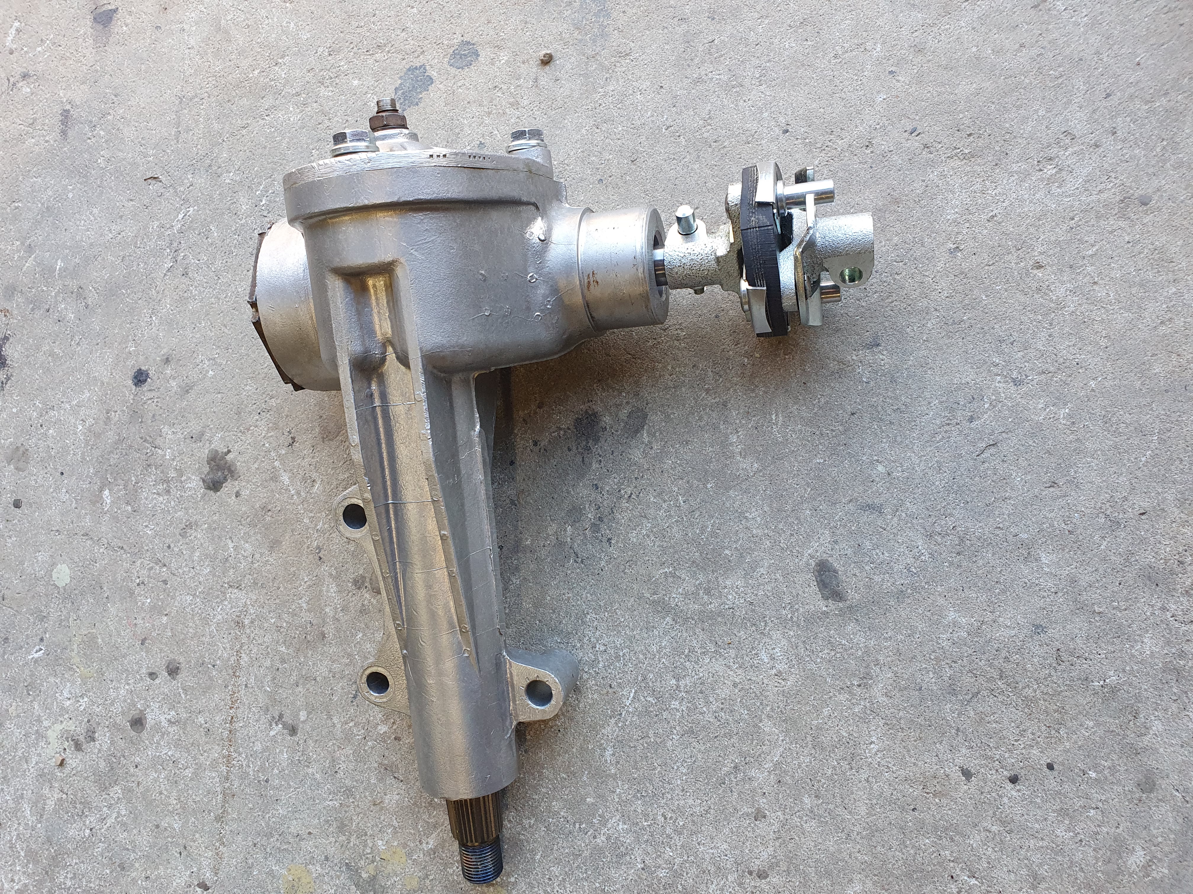

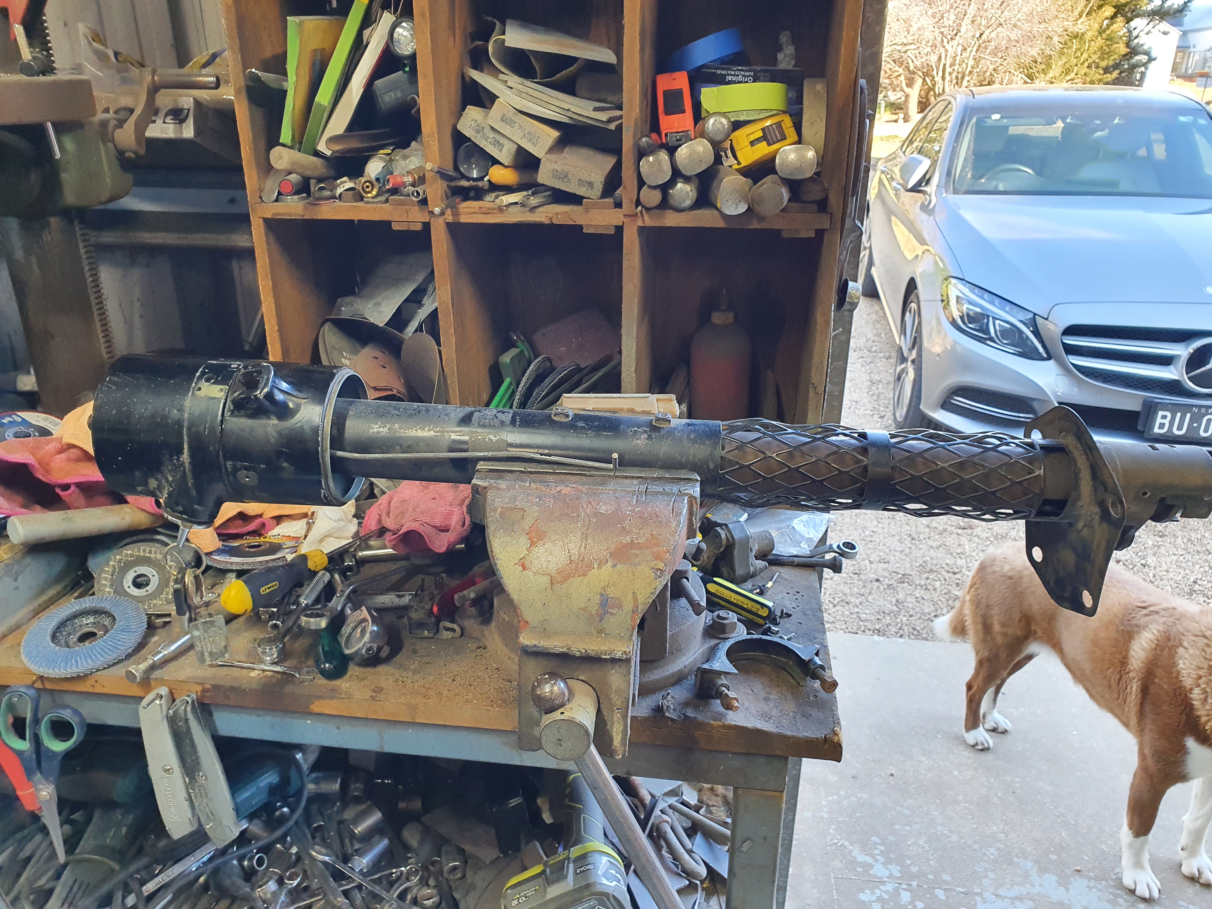

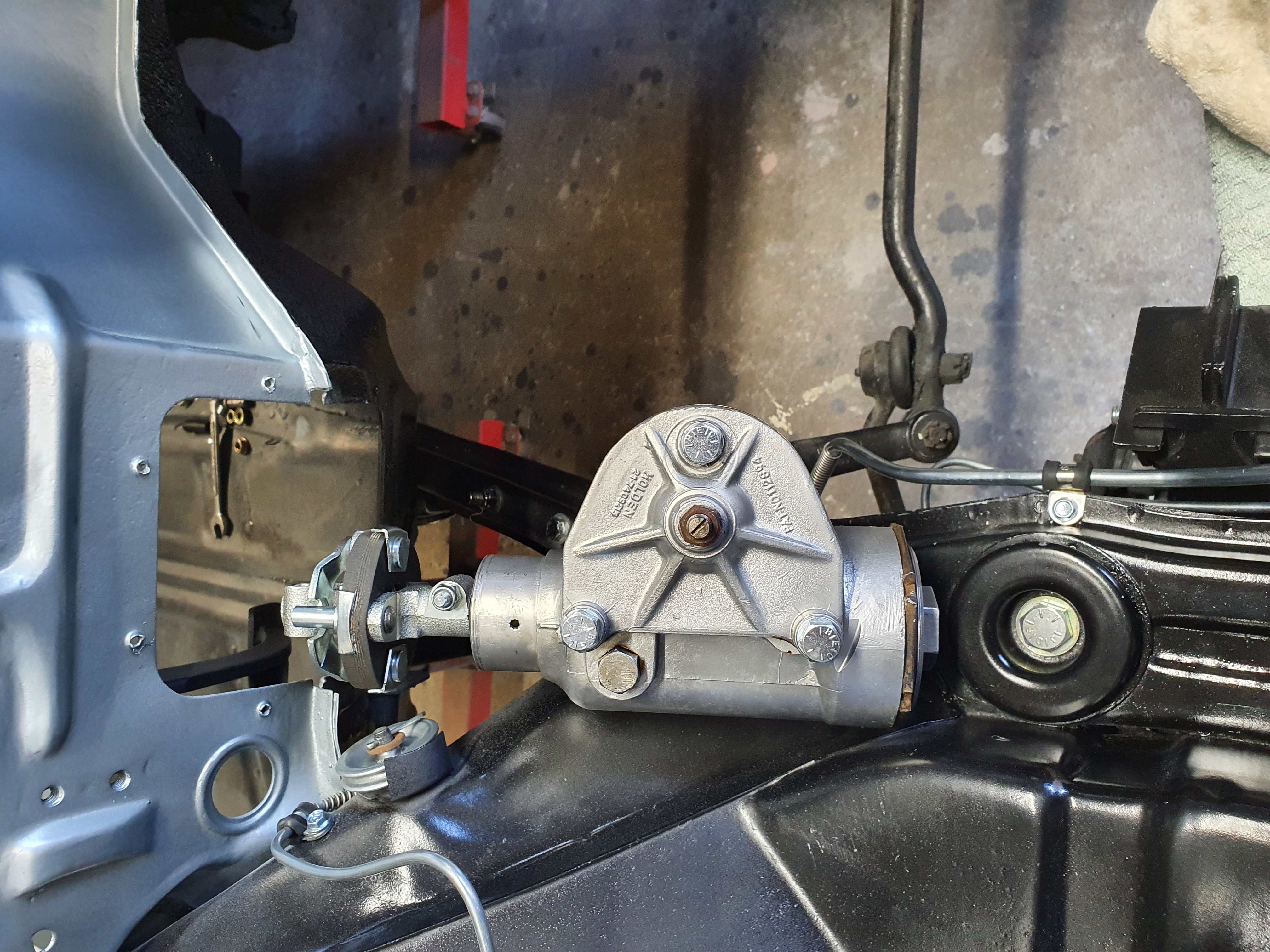

Steering started today. Reconditioned my nice shiny box with new Rares kit and then cut my brand new shaft up and mounted torrie cloth drive thingy. Next job is to make firewall bracket ( engineer insists on 3mm thick) and then make either original torrie breakaway bracket match to EK pedal box, or weld a bit on to outer column and mount a purchased 2 point breakaway on original dashmount. Whatever is safest and practical.
Also, column is for auto, so have to get rid of those bits.

Sweet, what did you do for a seal between steering shaft and box where you chopeed the outer ???
Posts: 2450
Re: Project 2.
There is a felt seal in there at the moment Blacky. If that isnt enough I'll machine out a bit of the housing and use a single lipped seal. Should be ok though. Best part of this is I can drop the box out without all the hoo ha of taking out the column and vice versa.

I like your approch Brett. Bucking the "trend" to r&p. Rag joint. Torana
mod boys ditch them for a solid, would it be rose joint?
Posts: 13793
Re: Project 2.
Rag joint will help take any vibration out of the steering wheel - at the expense of a little bit of feel. Its not a race car so I reckon its a better solution.

Very neat job on the rag joint 8)

Errol62 wrote: Fri Jul 29, 2022 6:28 pm I like your approch Brett. Bucking the "trend" to r&p. Rag joint. Torana
Engineer was adamant that geometry would not work with r&p on HR front. I had the r&p there and he saw it and said no - better off using the original box if you can tidy it up. His will is my command 😉

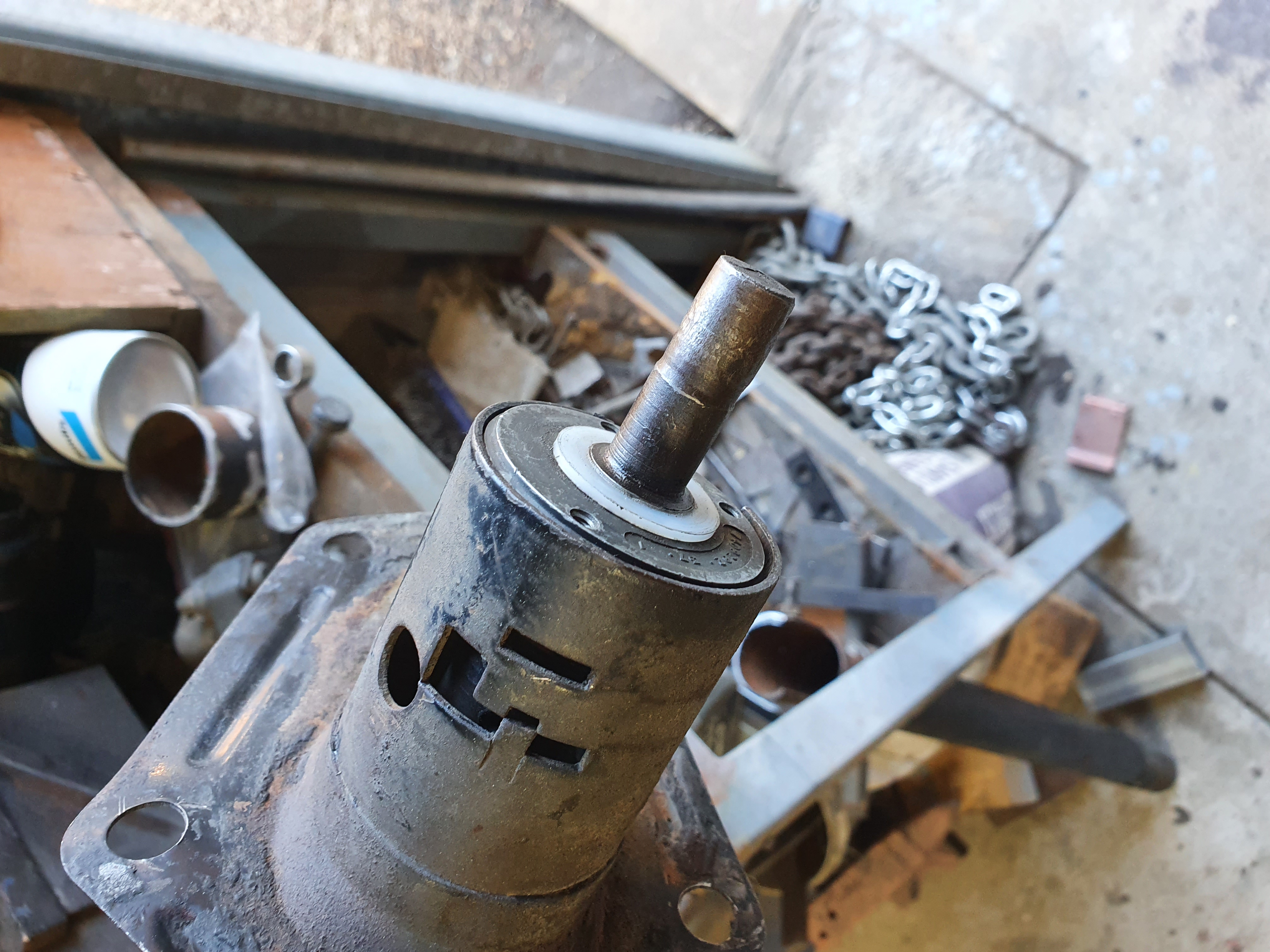

Enjoyable morning. A little bit of lathe work to convert an FB steering column top bearing holder to fit onto torrie steering column bottom and make an HR top nylon bush the new bottom bearing. This work is to lose the column shift tube which unfortunately houses the bottom bearing in torrie world.
