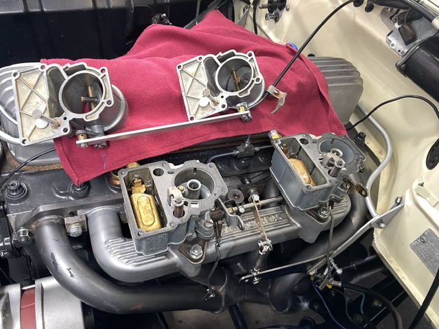

In regards to carbs it runs twin strombergs.
Timing is set at 12 degrees at idle
Idle revs approx 600 - 650 and lower and it starves of fuel
Carbs balanced with bubble tool to suit ideal revs.
Venturies fitted
48 main / 70 power jets
Float levels even at 17mm (just under 11/16 & within spec)
Accelerator pump plunger stroke is even on both carbs at 5mm. Book spec is 17/64 (6.7mm) to 19/64 (7.54mm)
- desirable stroke is 9/32 (7.1mm)
How much of a concern is the 5mm plunger stroke when the book say 7mm?
Venturies fitted
- IMG_8614.jpeg (129.58 KiB) Viewed 7874 times
Drew

Re: FB Standard Wagon
Pump shot is tuneable to some extent using the three pump arm holes.
When you rev the throttle, does it:
a) miss, then catch up again (too little pump shot)
b) bog down and poof black smoke (unlikely - too much pump shot)
If the answer to these is no, I'd be happy with the pump stroke.
The Clive 82 cam is fairly hairy for a non-race car. Comparison table here:
viewtopic.php?t=22653&start=180
I put one into Grace's ute... it is waaaaay overcammed with a standard head and single strommie (dammit... did I just say that?) There are trippples and a worked head to go onto it, but haven't found the time yet.
