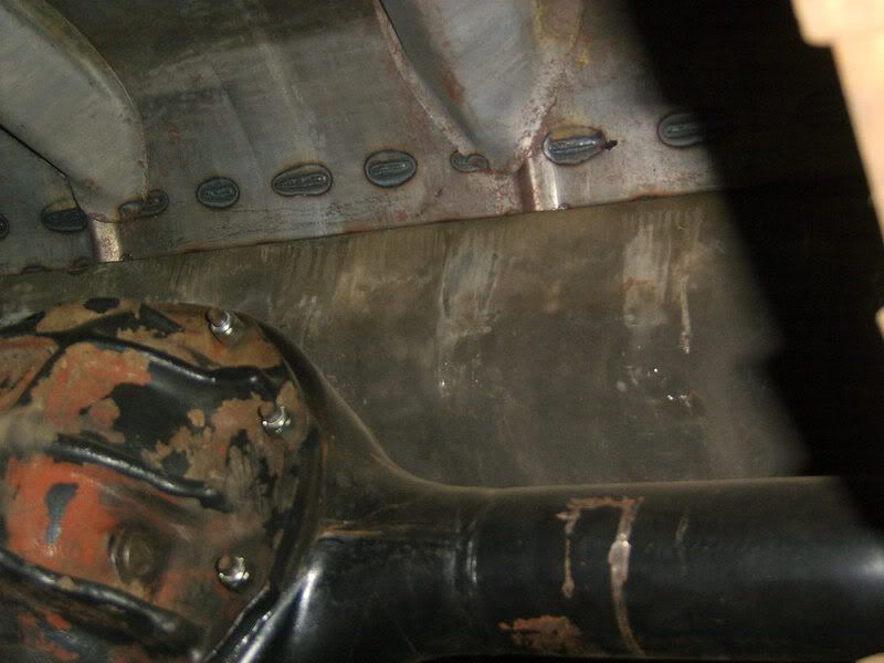

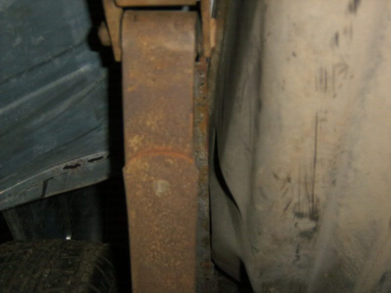

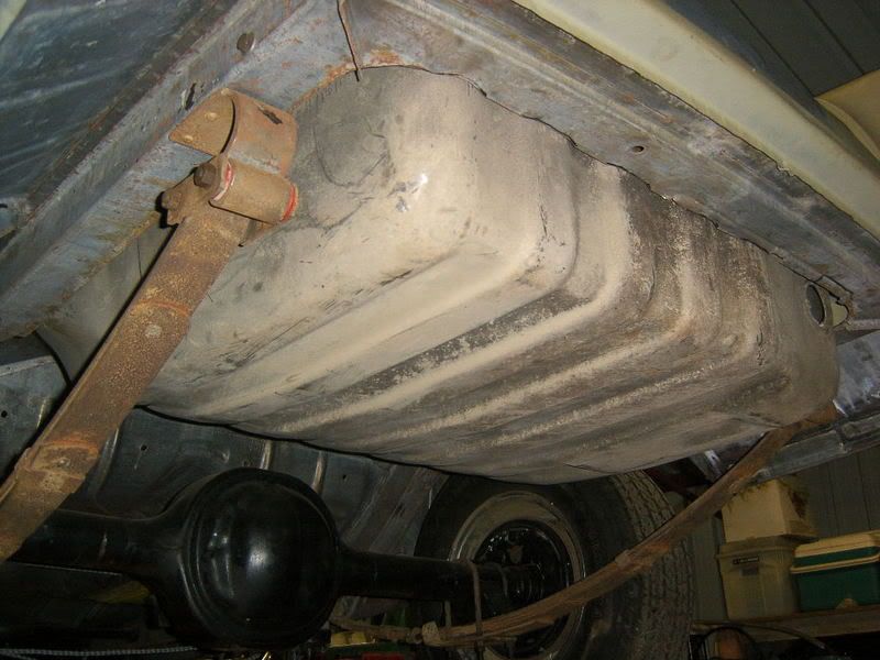

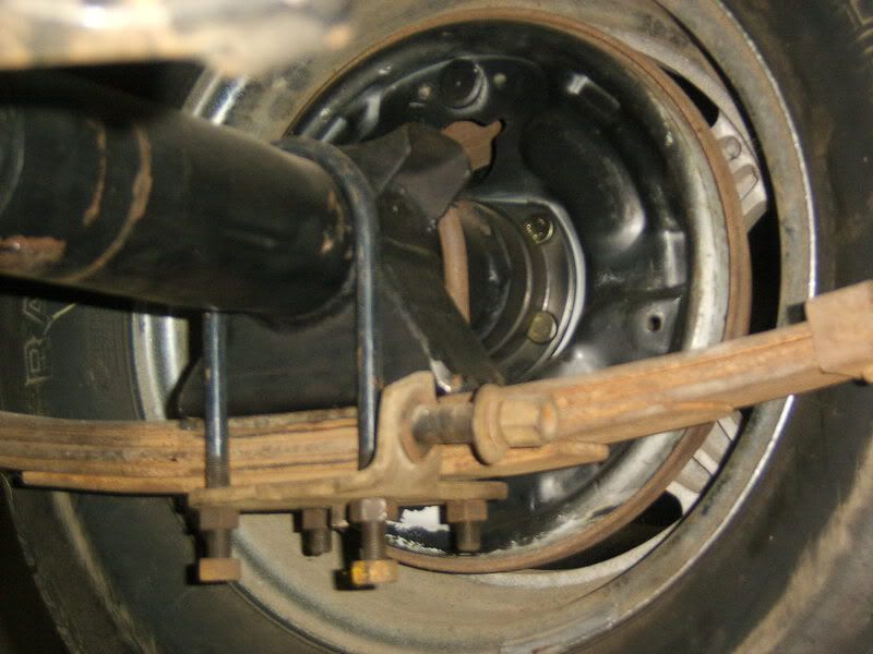

Any way back to the EK. Here are some pics of the tank for mattymartin
I cut the boot out and used an angle on the inside to support the tank, then folded 10mm of floor back inside and welded it to the angle this is the result from underneath.
I made up some deep saddles for the diff, this eliminates lowering blocks.
