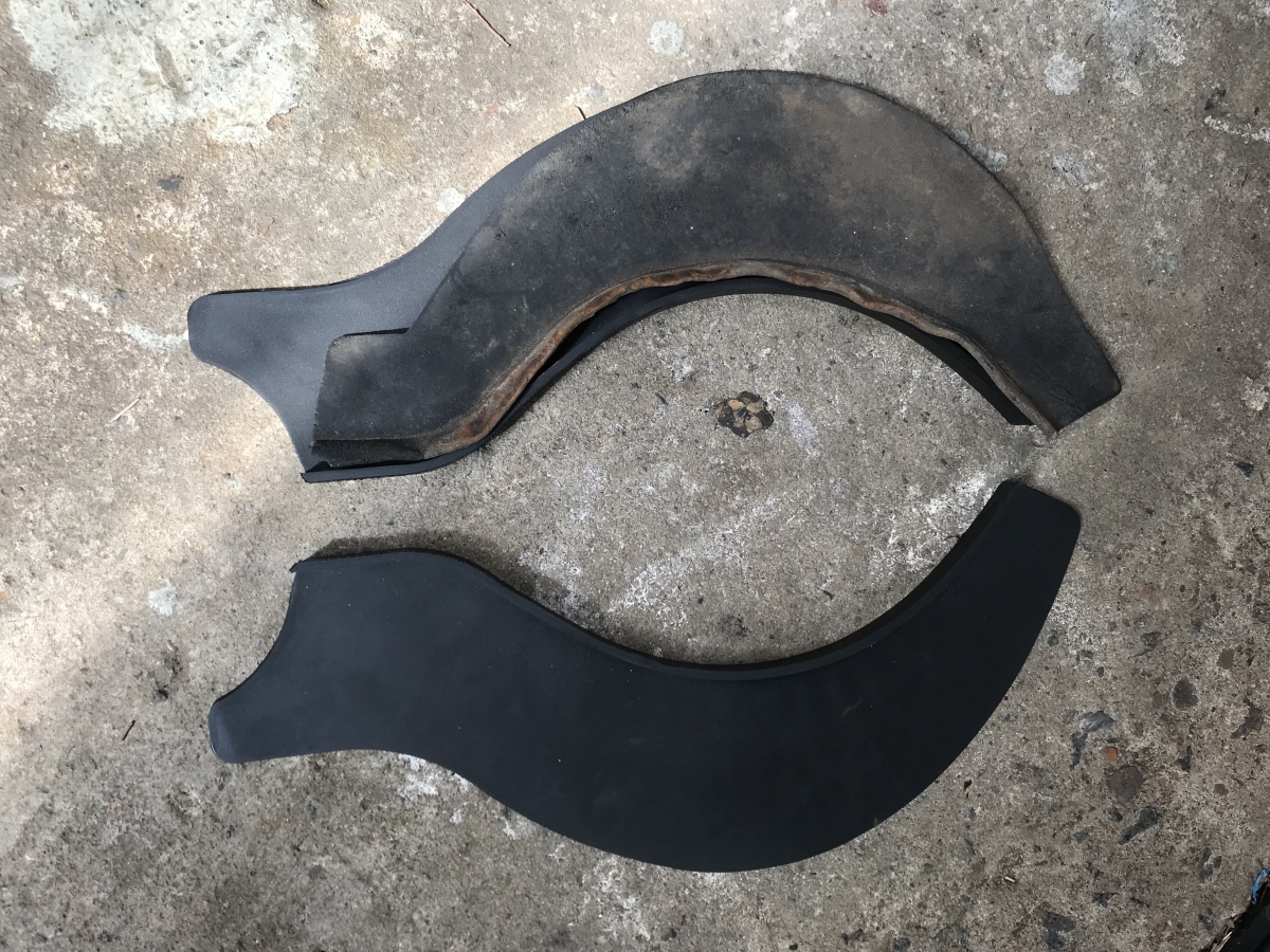

Just a quick note for the ute owners. The utes (just like the sedans, wagons and vans) originally had a rubber moulding that sits inside the rear bumper bar ends. It mounts to the body, and seals the bumper ends.
The FE/FC boys are making reproductions here: http://forum.fefcholden.club/index.php?topic=16530.0. The reproductions suit FE/FC sedans. I bought a pair of rubbers, and checked them against my EK wagon - they do not match, as the EK rubber is very different. They cannot be readily cut-and-shut to suit the FB/EK. However, they are a very close match to the EK ute rubbers - see image below, which shows my crappy old original EK ute rubber sitting on a pair of John's repros:
Optimized-bumper rubbers.JPG (928.99 KiB) Viewed 1255 times
With a little cutting and shutting, they will fit beautifully. The repros are available from Maco (John) on the FE/FC forum at the thread above. John is a great guy to deal with.

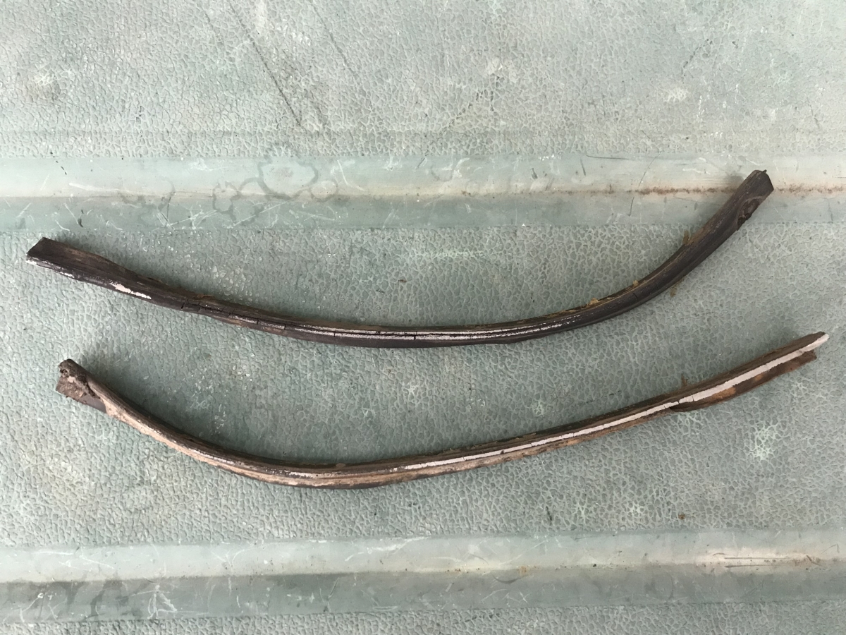

Going through all the odds and ends, and realised I had these two rubbers left over:
They are hollow section, though seem pretty flat. Any ideas where they came from? The ute was in pieces when I bought it, so they may be random strays.
Posts: 11680
Re: Harv's (Grace's) EK ute
They look a bit like the rubbers which go between body and front guard tops where they butt up to the plenum cover.
