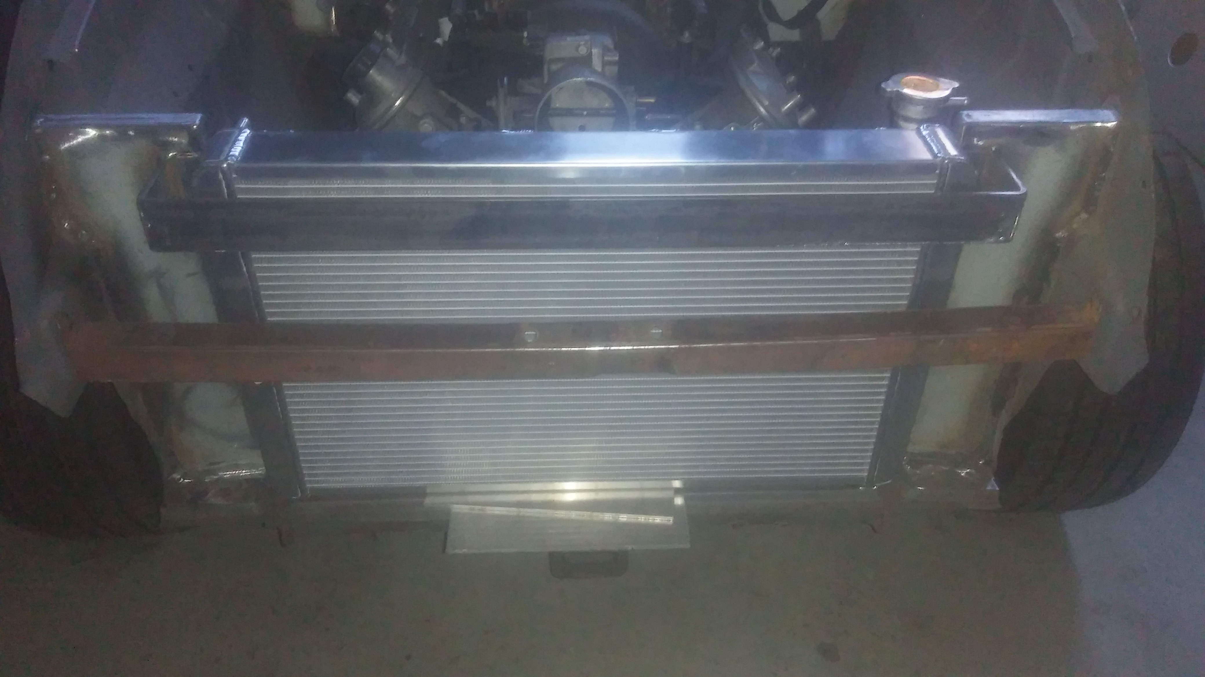

Started fitting the radiator, i think everything should fit :roll:

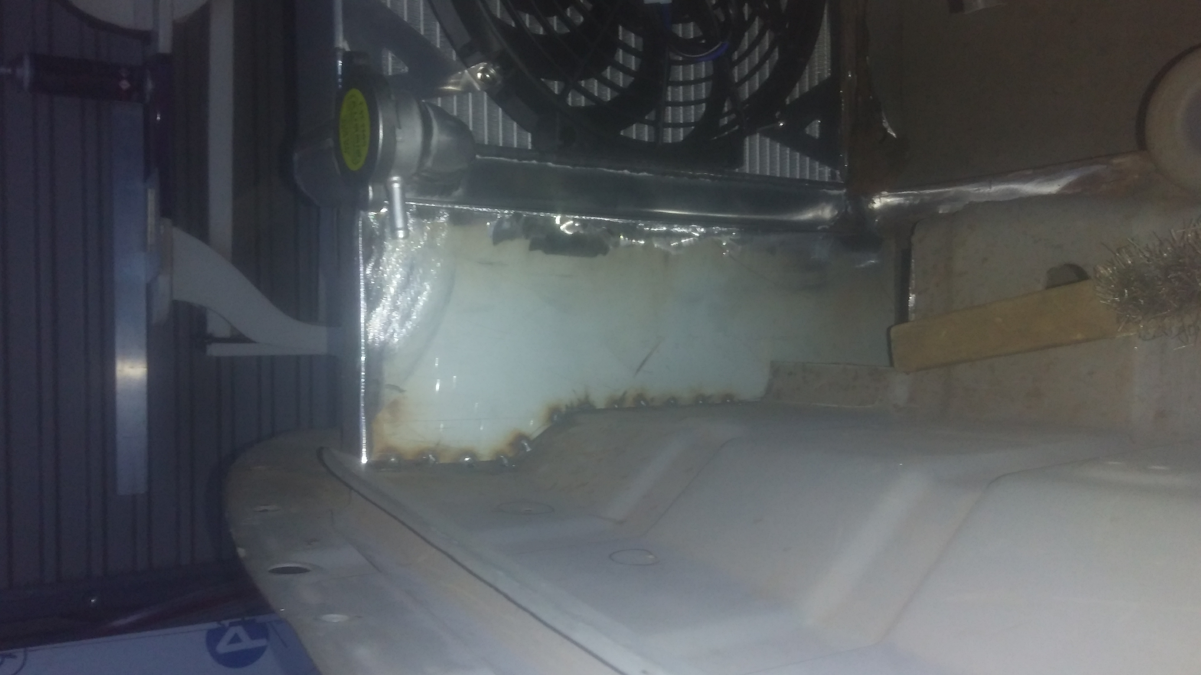

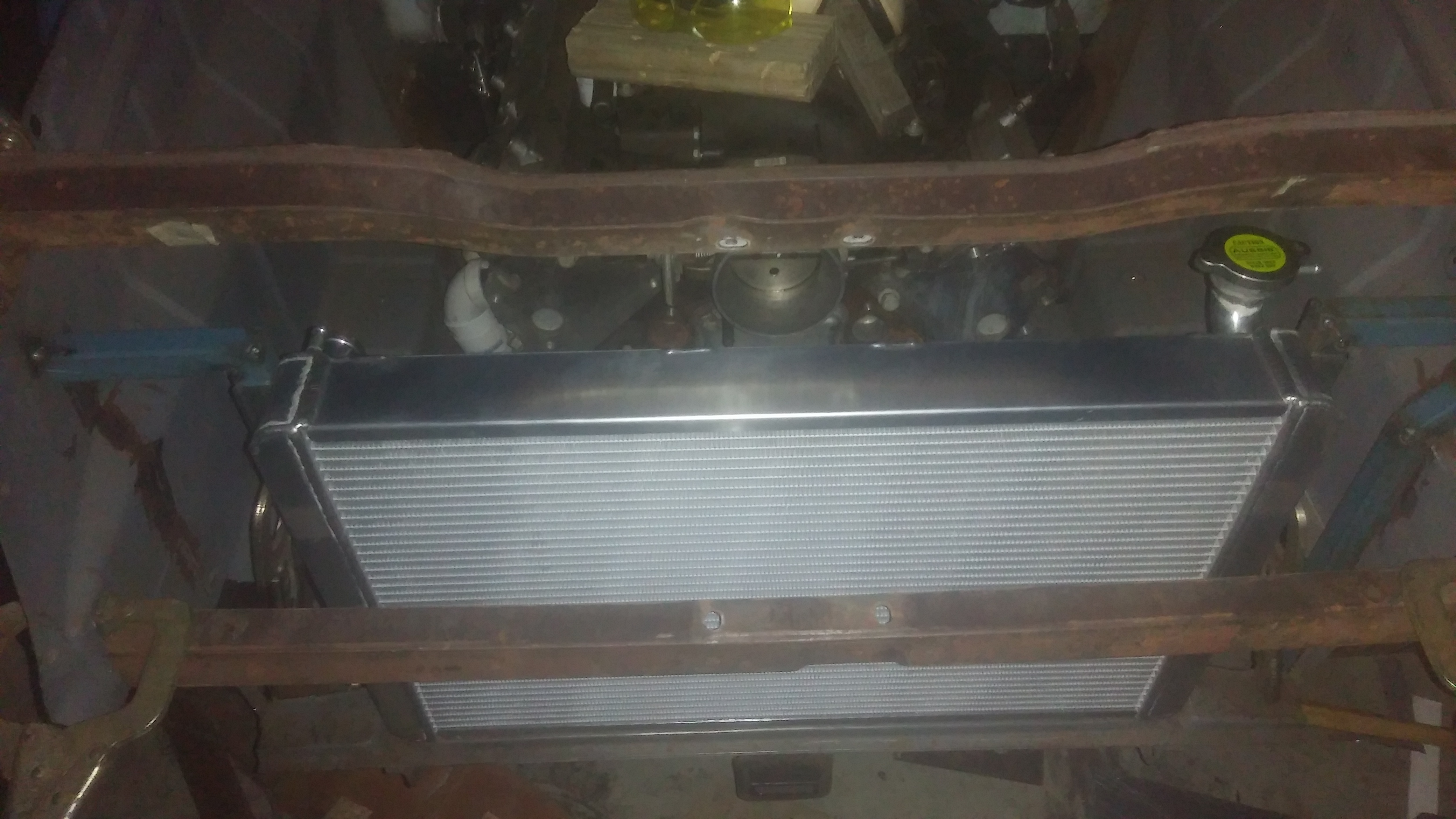

Post by TAZ »
So a few hours spent today finishing off mounting the radiator. Bit more welding to do etc. but will do that when its on the rotisserie.
