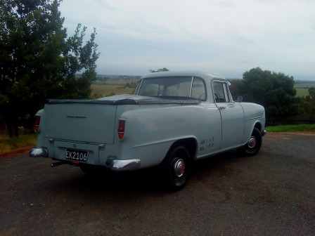

Getting close, still got interior bits and pieces to do. Went for a few squirts around the block and it looks like I've got the same clutch problem I had with the FB. May have to pull the engine. Bugger. Anyway she got a tub....first for few years!

Craig that looks Killer - what is the clutch issue your having?
My motor is out now also is there any clutch kit that is better than others to put in?

G'day Wally. When at rest with the engine running theres a slight ticking/rubbing noise in the bellhousing. Usually only when the car is pointing up hill. Put the foot on the clutch and it goes. These new "upgrade clutches" have a different housing cover and have lugs that hang out on the pressure plate straps. All it takes is a little end float on the crank and the whole assembly floats backwards and rubs on the gearbox housing at any high point. My FB is at the limit with end float .008" and it was bad. Had to pull it and grind down all the high spots and dress back the edges on the pressure plate lugs. Go a standard one if you can get it.

Any thought of installing a 0.025" spacer gasket between block and bell housing?

Well done Craig! Good times. :thumbsup: I remember when we got the wagon on the road there was a ticking noise and we thought was coming from the clutch / gearbox. Luckily it turned out to be the fan was flexing.
