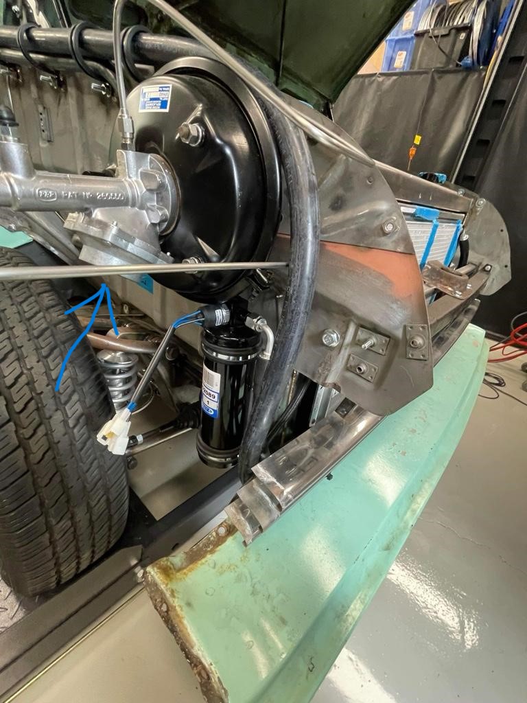

While the cooling system was being nutted out it was becoming apparent how quickly we were running out of realestate.
It was at this point where we could see the subframe would need a trim in a few places to satisfy the required clearance for engineering.
The commodore water pump was going to not be ideal so it was swapped for a heavy metal garage billet job, the castle main rod shop alternator mount was not going to work (ended up being a good template though….), the ac compressor would need some clearance around it so all these little things added up while sorting out the clashes and what got priority.
To make some room in the bay we ended up remote mounting an astra power steering pump and brake booster under the guards.
The springs on the factory bonnet hinges hit the master so I pulled the trigger in the V6 conversion ones which need the lip trimmed of the subframe. This looked a bit dicky (and triggered Tims OCD again) so we removed the whole section after figuring half of it was missing and wouldn’t really be functioning as designed anyway.
Lots of little clashes that needed to be sorted to get everything to fit and functioning properly but still allowing as much serviceability as possible with limited space.

not sure if you know this but protect the part i have the arrow pointing at on the booster from dirt and moisture, it will destroy the booster in no time flat apparently

It's the breather, which allows air in/out of the booster guts (not into the engine!) as the diaphragm flexes. With the booster under the guard, a remote breather is reccomended - see here for what they look like:

Thanks Mick and Harv for the heads up. The plan was to shroud the booster, power steering pump and other bits and pieces I’ve had to put under the guards to protect them a bit. I’ve also ended up running fenderwall headers (pics to follow shortly)so I wanted a bit of heat protection also but I might double the security of the booster filling up with shit and run a breather as well.
