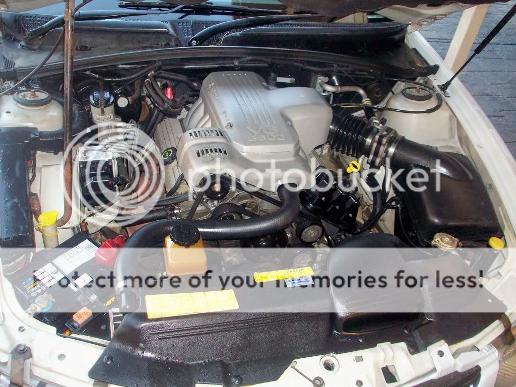

got a vt wagon 7hundred tranny oil in the coolant :o :o , they replaced the radiator :o sticky crappy shit all through it.
REMEDY
take out the thermostat and flush with garden hose yuck looks like vomit
go to supercheap get 6 cans
spray 3 cans of degreaser,fill with water
run for 5-10 mins
undo and flush
repeat
