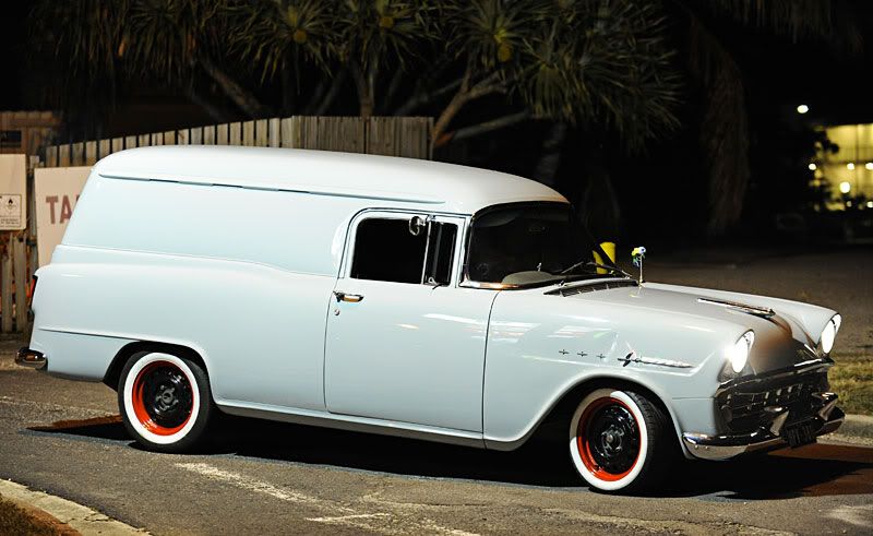

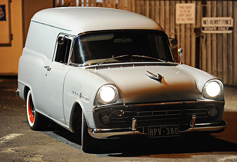

thanks vintageholden, i thought about that for a bit then decided to get the nut welded back on, it would be to difficult to get inside the spring to stop one end of it spinning.
here's an update pic, i've put some lower profile tyres on the front and an adjustment of the front springs dropping the height about 60mm. also taken a leaf out of the back to soften the ride, that dropped it 30mm, i plan to flip the eyes on the springs and put some blocks in the back and drop the front another inch once mods plates and Qld rego is sorted.

after a little lowering it's still riding like a tractor, got the 80's rake

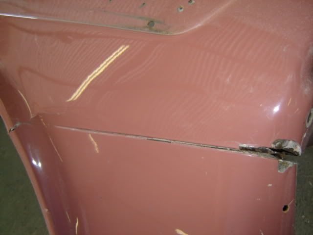

the damage is from a wallaby i hit on the way up from vic, i was asleep in the back about 1hr north of dubbo and woke up at 3am almost suffering hypathermia, i had to get the heater going so got back on the road heading home, this fat bastard appeared in the headlights and i couldn't avoid him. now i'm trying to find parts to have it repaired.

Man that guard is nothing like what I thought it would be like! Just have it beaten, no need to replace it. looks an easy repair. I still got those grill bars when you need em and the indicator fitting.

the wallaby damage doesn't look too bad in these pics but the indicator is pushed through the guard and the impact has bent up the side of the guard and its all cracked over the arch and crunched near the drivers door. has cracked the eyebrow above the indicator and pushed that part of the guard up to the headlight and a little damage to the bonnet chrome. hopefully get a few other things done while its at the beaters.

I did a similar thing but with a driveway bolard!! I pulled the guard and took it to the beaters, They fixed it up great but the painter must have been colour blind and couldn't match the paint!

damage is similar to yours on the side Theo, same dent above the wheel arch, my special badge snapped in half from it. your hub caps are real cool, where did ya find them?

My car has HR front with heavy duty lowered springs with 1 coil cut off and the rear is the old 1 leaf turned upside down and 1.5" lowering blocks, I load myself the wife and 4 kids plus a boot chokers full of luggage and it doesn't bottom out Too much, only over big bumps :wink: , Trev 8) .

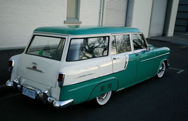

Bloody nice van, but your fc wagon is really sweet. Any more pics of it?
