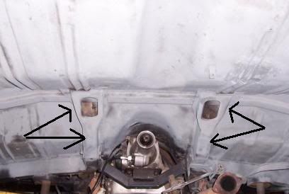

I would say he means something along these lines (thanks Blacky - and i know this is a Commodore Conversion)...
pick up that floor brace...

OK J that makes it easy!
Go to a local wrecker and grab a crossmember off a LH Torana (tri and Aussie 4 speed the same)
the ends are different mounting and hang out past the floor bracings, these can be cut off with to the width of the rails that come back for floor support on your body shell, where the gearbox will sit.
Weld four flat pieces of steel (two each side on either side of the crossmember forming a U shape) that will fit up over the floor brace.
drill through floor bracing and fit crush tubes in the floor braces horizontally to mount gearbox, use standard crossmember rubber mount and bolt it up!

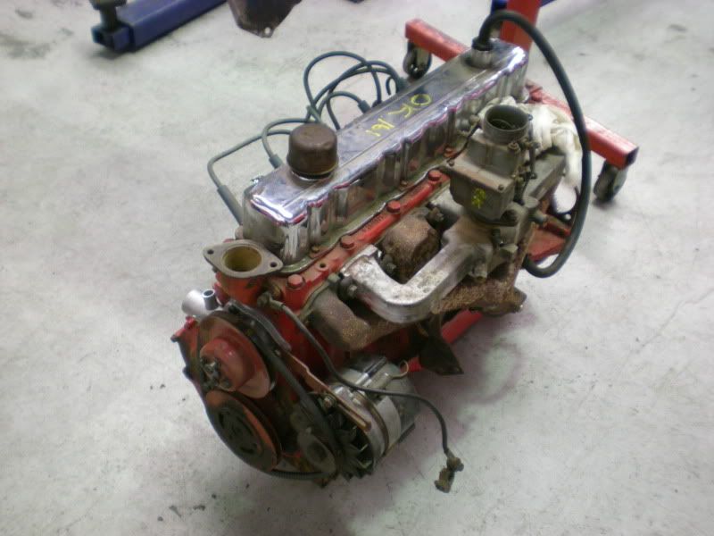

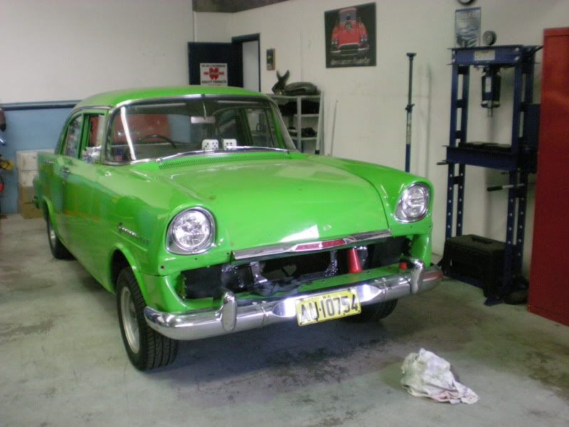

well I purchased the 161 which was complete and running
then discovered complete and running means you have to buy a thermostat, a housing, a fuel pump, flex plate and a new water pump.
Got the gearbox over to which are putting it all together for me.
I believe he got the EH sump etc on the engine, went to bolt the gearbox together but I have the wrong torque converter.
So im going to get another torque converter, then he will bolt it all together with the new waterpump, recond'd fuel pump and thermostat stuff that I bought. Drop the engine in and start making brackets.
From Wednesday onwards there will be some real progress, with pics as I will be there wednesday, thurs, fri and sat providing it aint on the road by then.

motor (new waterpump, thermostat, thermo housing, chrome breather, recond'd carby)
box (trimatic and 360deg bellhousing, new linkages and flex plate)
as she sits
real update on wednesday
