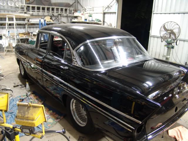

I finished fitting all the rubbers today (doors and boot) and they went on very well, had a "fitting tip" which helped heaps!!! Tomorrow is "finish the boot day", will post some pics when it's done (if it looks ok!!)
Rick, the chrome has not arrived yet

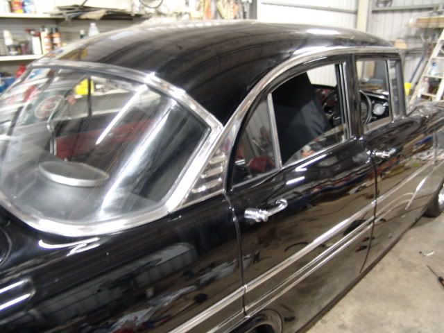

, but they did send the door handles (outside) by express post so at least I got them on and finished fitting the internal door trims

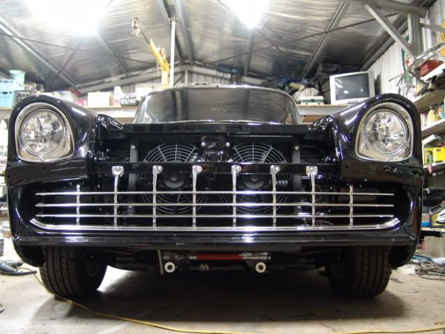

Thermo fans, Grille, bonnet catch (modified) are fitted, will polish and fit the radiator O/F tank and washer tanks tomorrow.

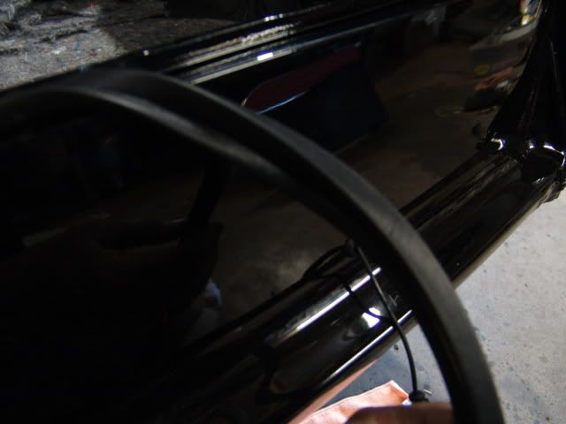

Have posted pics of gluing the rubbers, please don't take offence< I have just read alot about people having problems with rubbers so I thought I would put it up just incase it helps someone in the future

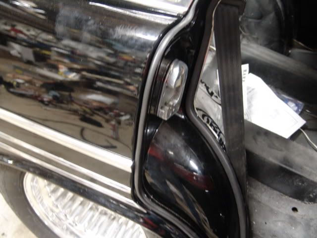

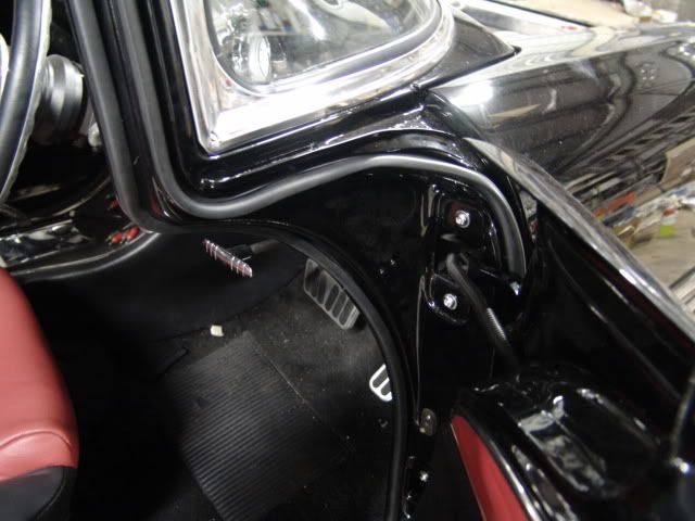

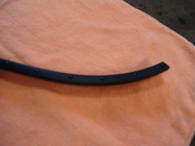

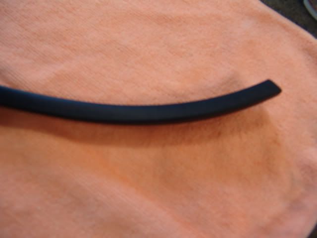

This is the rubber door/boot seal and the following pic shows the glue (dots), basically I was told to treat the rubbers like the newer cars (they have clips every 100-150mm) and glue in spots rather than fully glue the rubber, I glued it at 50-60mm spacings and seems to have worked really well, doors shut and are still in line (harder to shut, but that is expected)
Rubber - no glue:
Dots are the glue:
Do about 150mm (6") at a time, then apply more as you go..... slow and steady wins the race....apparently
Rubber fitted:
Door handles on:
Thermo's, grille, bonnet latch fitted:
