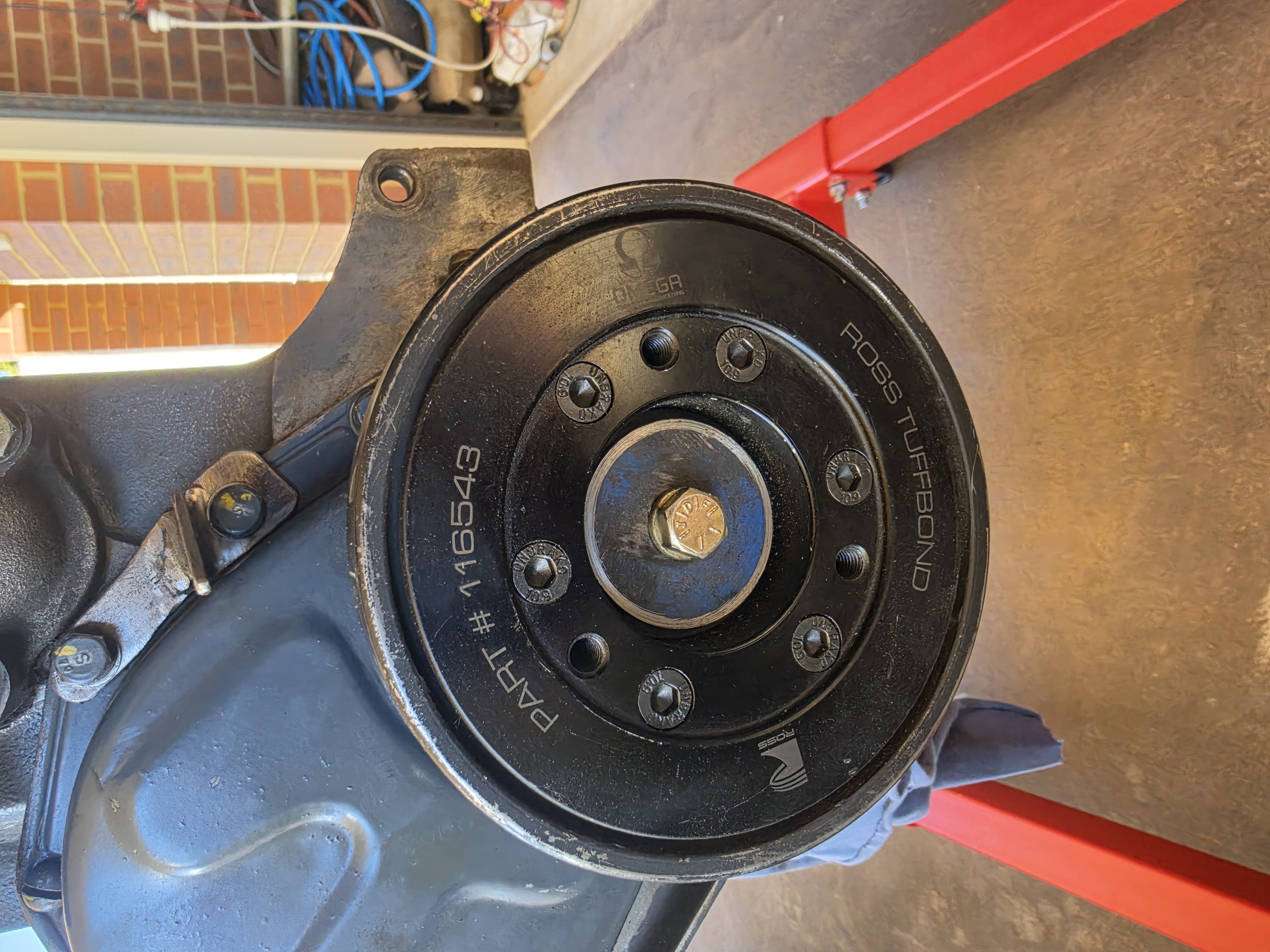

The bottom end has had a lot of work done.
Lumpy top Ross pistons, 10.5 to 1 comp ratio.
Balanced standard crank and rods
Billet centre caps.
Ross balancer, timing pointer.
6 bolt flywheel lightened 5 lbs.
Full flow Oil filter conversion but no hoses or filter from the fittings in the block, he'd had the filter on the fender anyway.
No distributor.

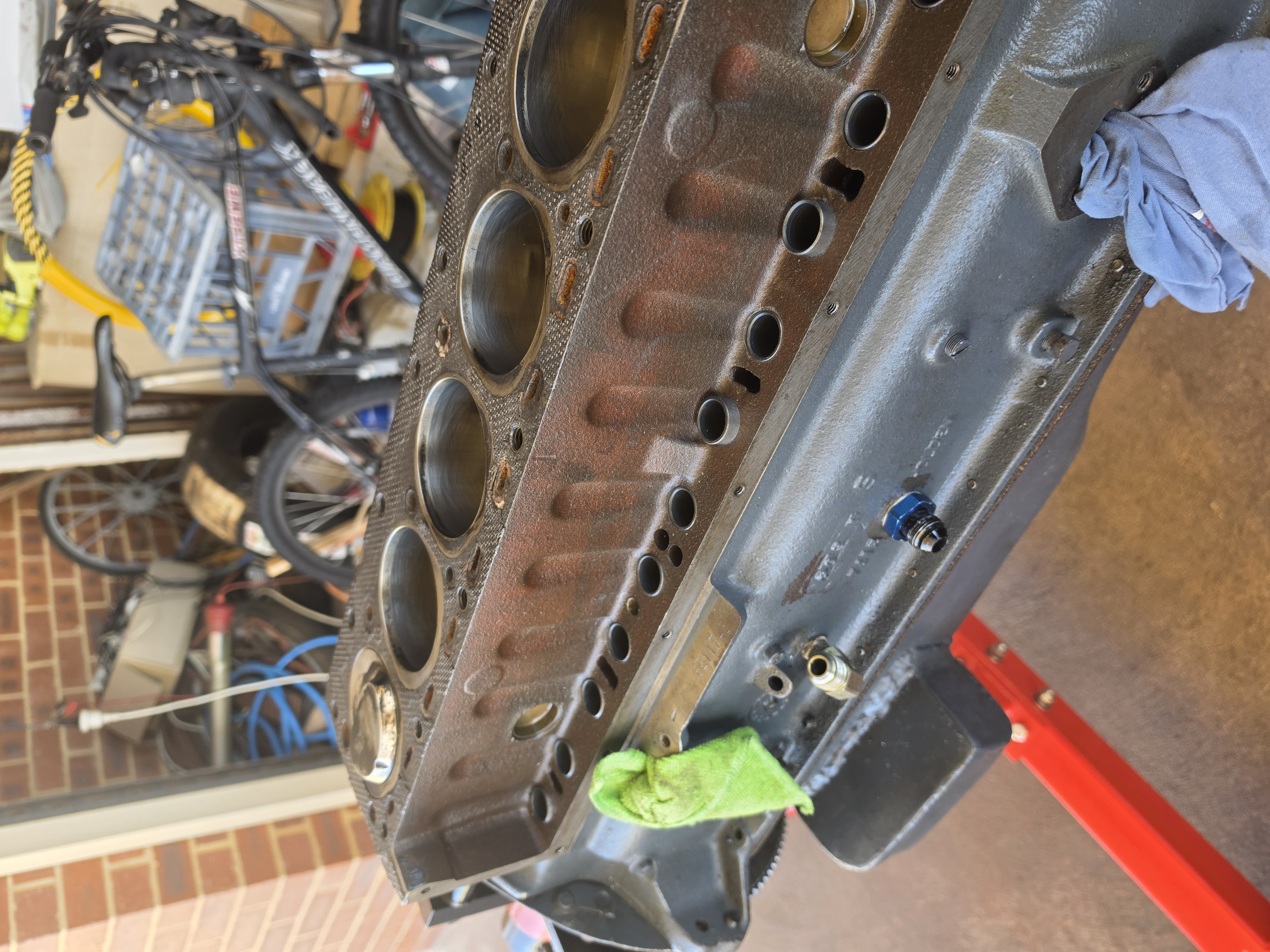

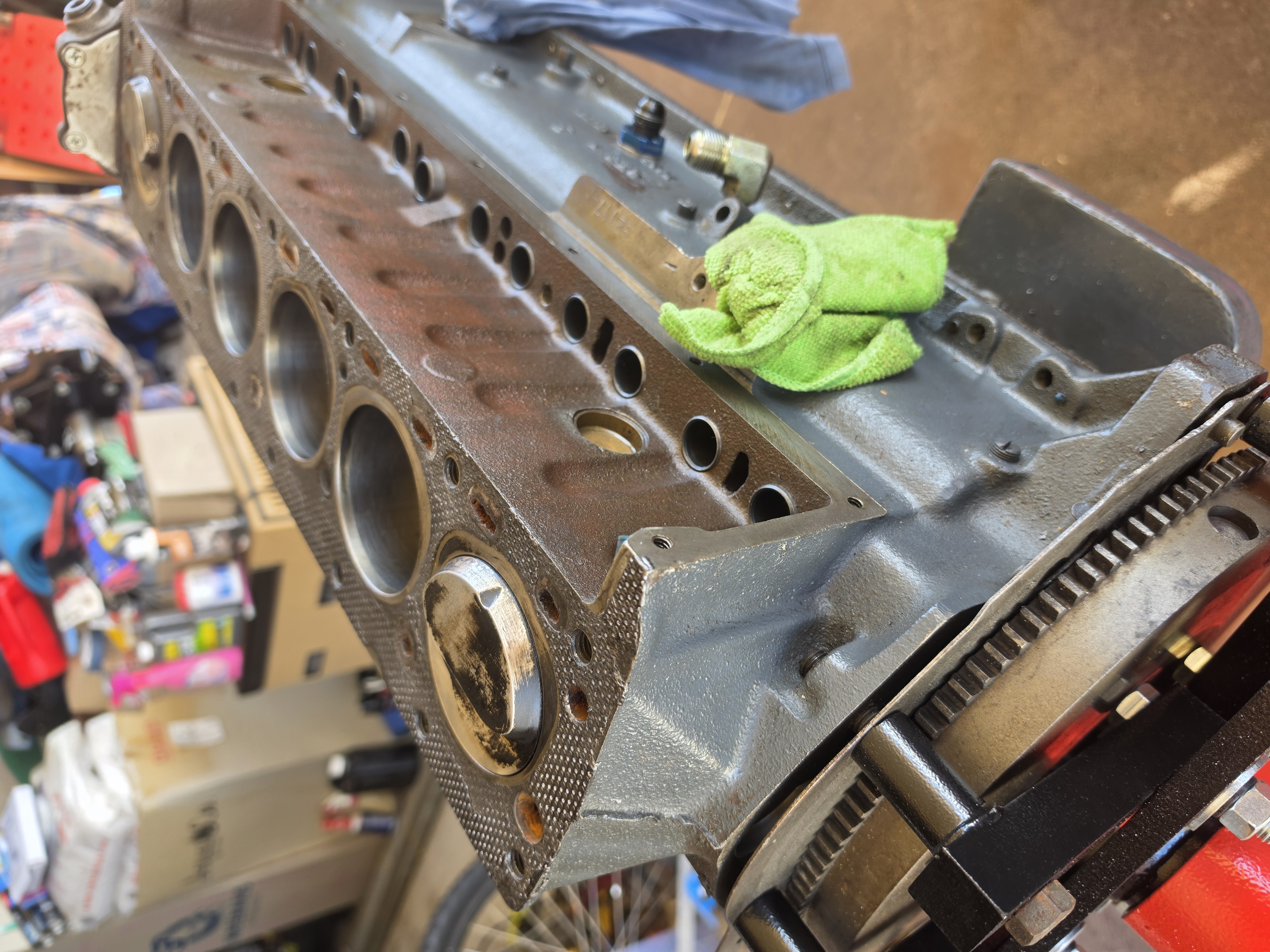

Hi guys,
First up, Blacky, sorry to hear about your mishap. Get well soon.
Anyways, the thread is called best bang for buck.
Recently I bought a local historic racing guys spare spare engine.
It has an unknown wild cam, lumpy top Ross pistons and many other mods for a reasonable price, apparently with little use.
Pics to follow.
I want to use my mild cam, clives 1433 grind.
I rang Clives and they said the maximum compression ratio that the cam would suit is 10.5 to 1 ratio.
I also rang David at Galloway's who built the engine a while ago and also suggested the compression would be too high as well.
I will be using a gasket from the 4th round of high duty gasket from Harv, assuming it is about 1mm thick, and I have an ARP head stud kit.
I need to source the gear to cc the head and to get some plasticine to measure the dome volume.
I want good streetable engine that is not a pig to drive, it will be mated to a opel 4 speed which has a lower first gear and using 3.89 diff ratio to start with and the triple 1 1/4 SU carbys with long runners in the FJ.
In the meantime looking at the pictures to follow what is everyone's best guess on the compression ratio?
Pics to follow.

Pics round 1
- 20260829_102537.jpg (2.32 MiB) Viewed 154 times
- 20260829_102525.jpg (2.6 MiB) Viewed 154 times
- 20260829_102514.jpg (3.28 MiB) Viewed 154 times
- 20260829_102507.jpg (2.98 MiB) Viewed 154 times
