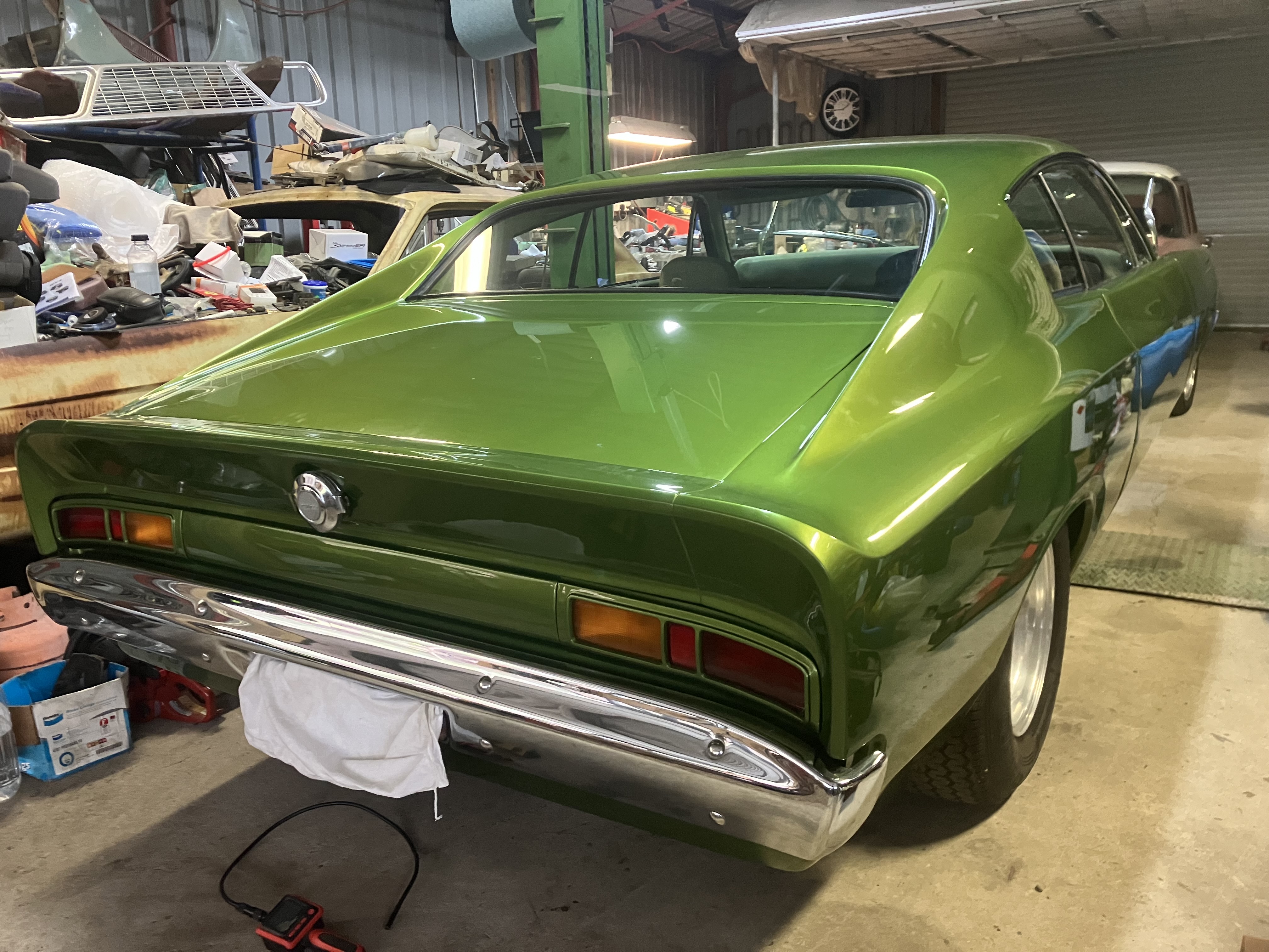

Diff update, absolutely fantastic !! the old girl moves along at shall i say scary speed and i have left some decent liquorice strips around my local area.
Private roads of course !!

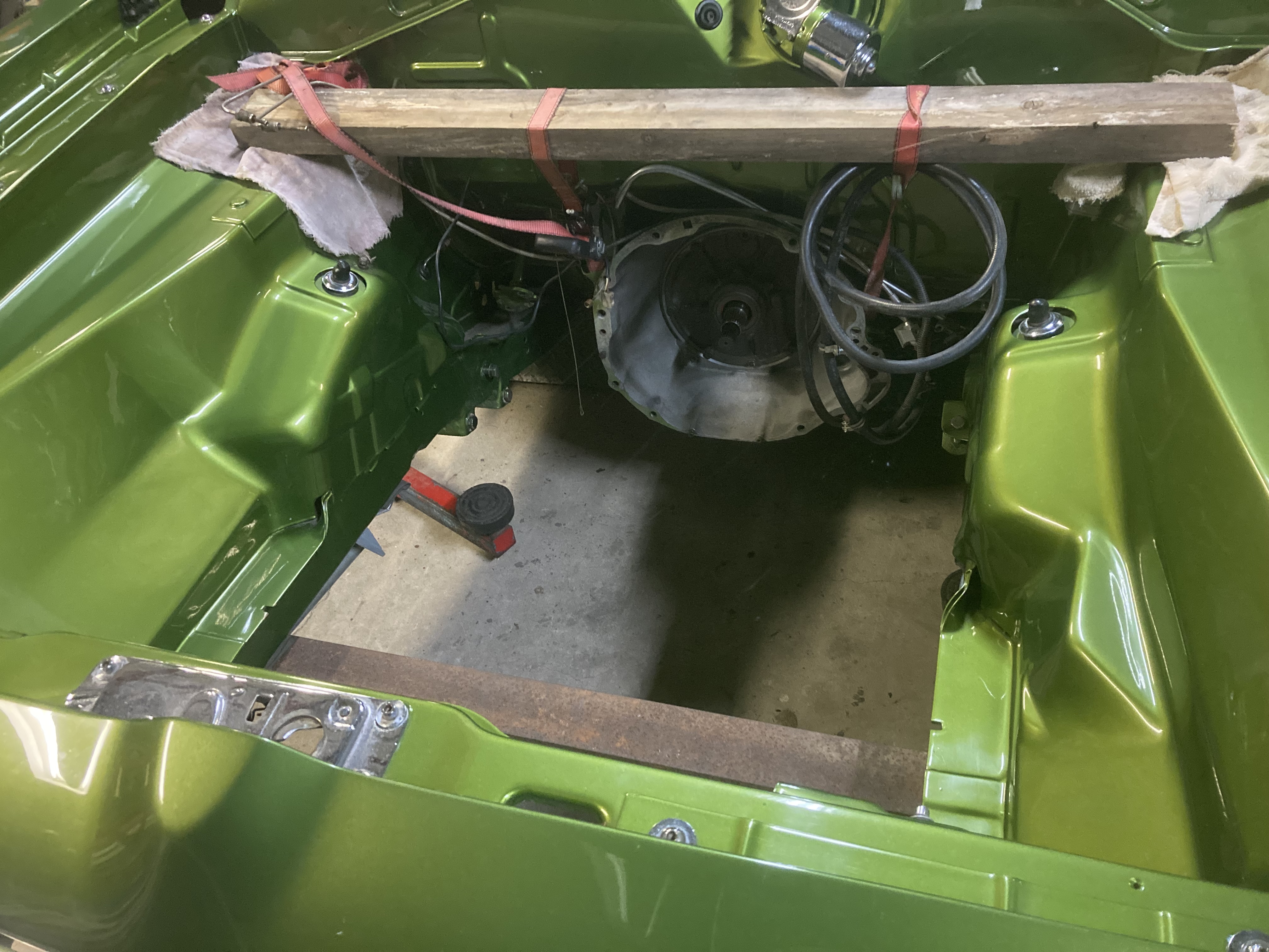

Doing an engine for a buddy, 360 Roller cam with all the goodies. This Val is good looking and has the fats as well !!
I just hate how much room is in the engine bay !! Plan is rack and pinion steering, 360 roller engine and some good exhaust. I know its not an FB or EK but what the hell why not !!
