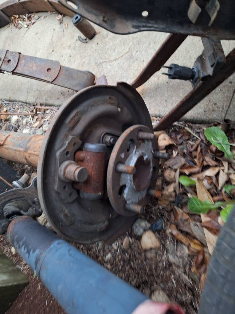

Hi gents
Not sure if this is much help ? More looking at brake shoes , gaskets , Axel bearings , seals and so on to order . Are the pretty much the same through early holdens ?
Sent from my SM-A546E using Tapatalk
Posts: 2710
Re: Diff identification
That looks like a EH diff, going by the bump stops and center with the 2 long bolts on the bottom.
Also the yolk/uni is different to an FB and EK.
Post by fb delivery »
the center will be 3.08 or 2,78
butt will be stamped on the plate under the yoke
gledge
Post by gledge »
Nearly looks like a V8 yoke so maybe HT ish?
Post by gledge »
Ooh no EH
Posts: 11669
I agree it looks to be an original EJ EH housing with 3.08:1 most likely or 2.78. Good cruiser setup. Probably EJ HR brakes though there are possible variations.
Post by Dr Terry »
Yes, I agree It looks like an EJ/EH housing and brakes, with a 3.08 or 2.78 centre, probably out of a Torana, where they were far more common.
Dr Terry
Posts: 14275
diff ratio might be a little bit tall depending on what engine and tyre sizes you are going with - I tried a 3.08:1 and 14" rims and tyres on my ute for the Nationals one year and spent half my life in 2nd gear at the first sign of a hill.....
Posts: 11669
Good with a torquey red 173 or bigger, otherwise yes. For a grey would be overdrive.
Post by Sneezy1211 »
Blacky wrote:diff ratio might be a little bit tall depending on what engine and tyre sizes you are going with - I tried a 3.08:1 and 14" rims and tyres on my ute for the Nationals one year and spent half my life in 2nd gear at the first sign of a hill.....
Cheers mate , it's a pretty lively red 186. head has had the dividers taken out of the intake ports big valves and so on. Have a new set of webbers to hang of it as well . Wheels we bought BCI 15" smoothies 6" front and 7" rear haven't decided on tyre size as yet .
