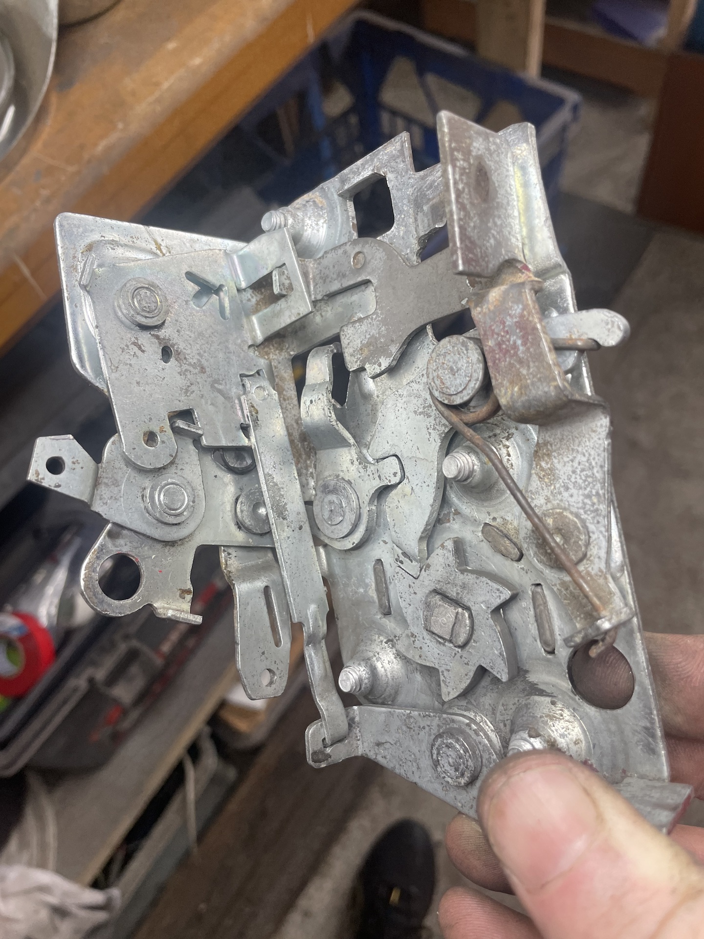

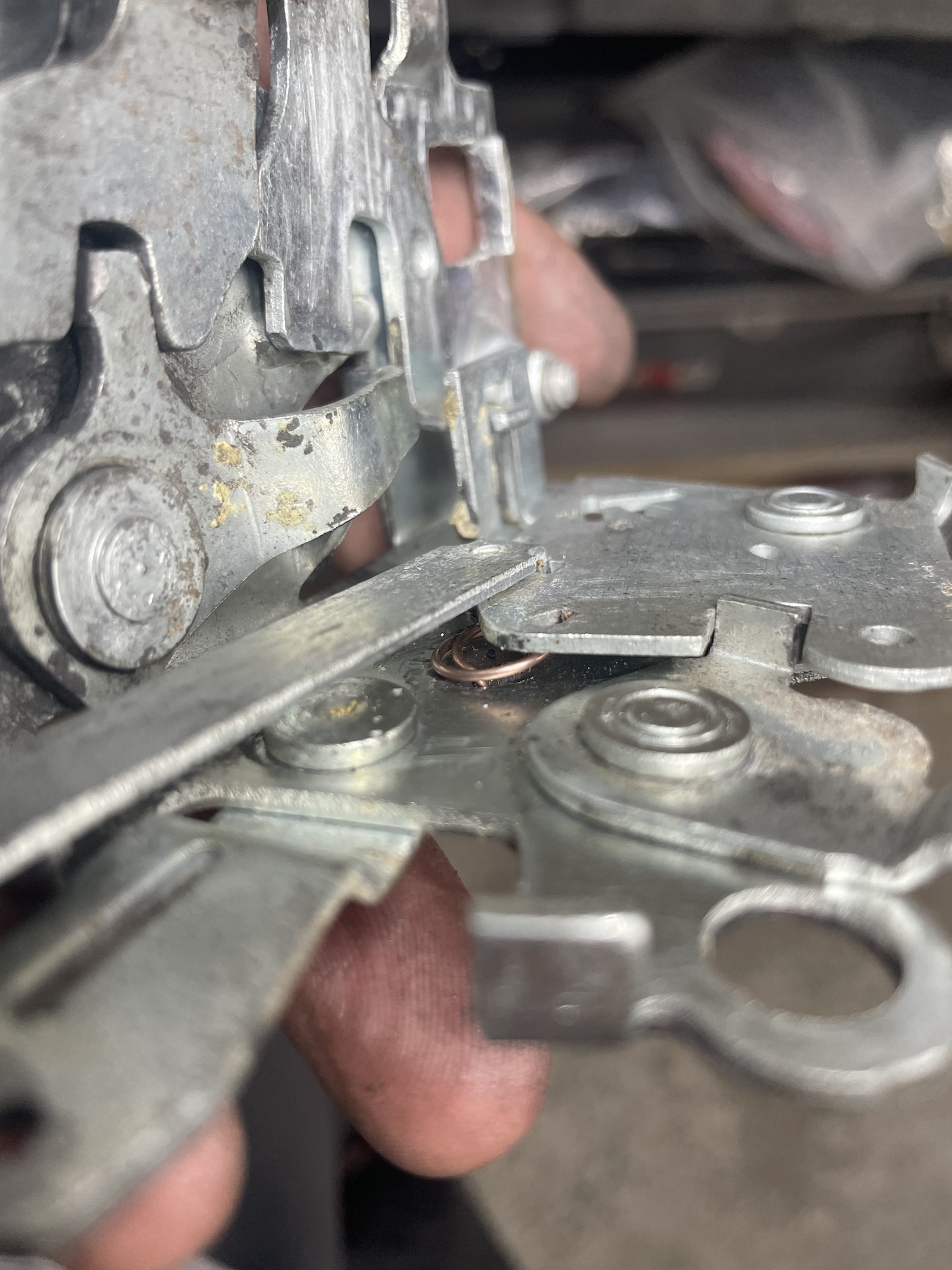

Small victory day today.
Removed 60 years of hardened grease and dirt off the door latch mechanisms. Noticed that there is a spring missing on the drivers latch that gives the lock its satisfying pop when you raise or lower it.
Here is the passenger side with the spring fitted. It's about 10mm diameter, 1 and a half turns in a clockwise direction, with legs at right angles poking through slots into the brackets. With some trusty 0.8mm MIG wire and, through some trial and error, an 8mm drill bit, I bent up a new 10mm spring. Even thought ahead and wound it in an anti clockwise direction to mirror the passenger one. Fitting was not as hard as I thought. Popped one leg in its slot then forced the other leg under the top plate. From there I held the spring in place with a flat blade screwdriver, and used another through a small gap, to locate the other leg in its hole. Success. Unlocked. Locked. Force required to push the lock is slightly higher than the original spring (1.4kg vs 1.2kg). Not sure how this wire will fatigue over time. Engaged the lock about 50 times quickly and it didn't break so there's that.
It will be better than nothing until it's nothing again when it breaks or pops off.

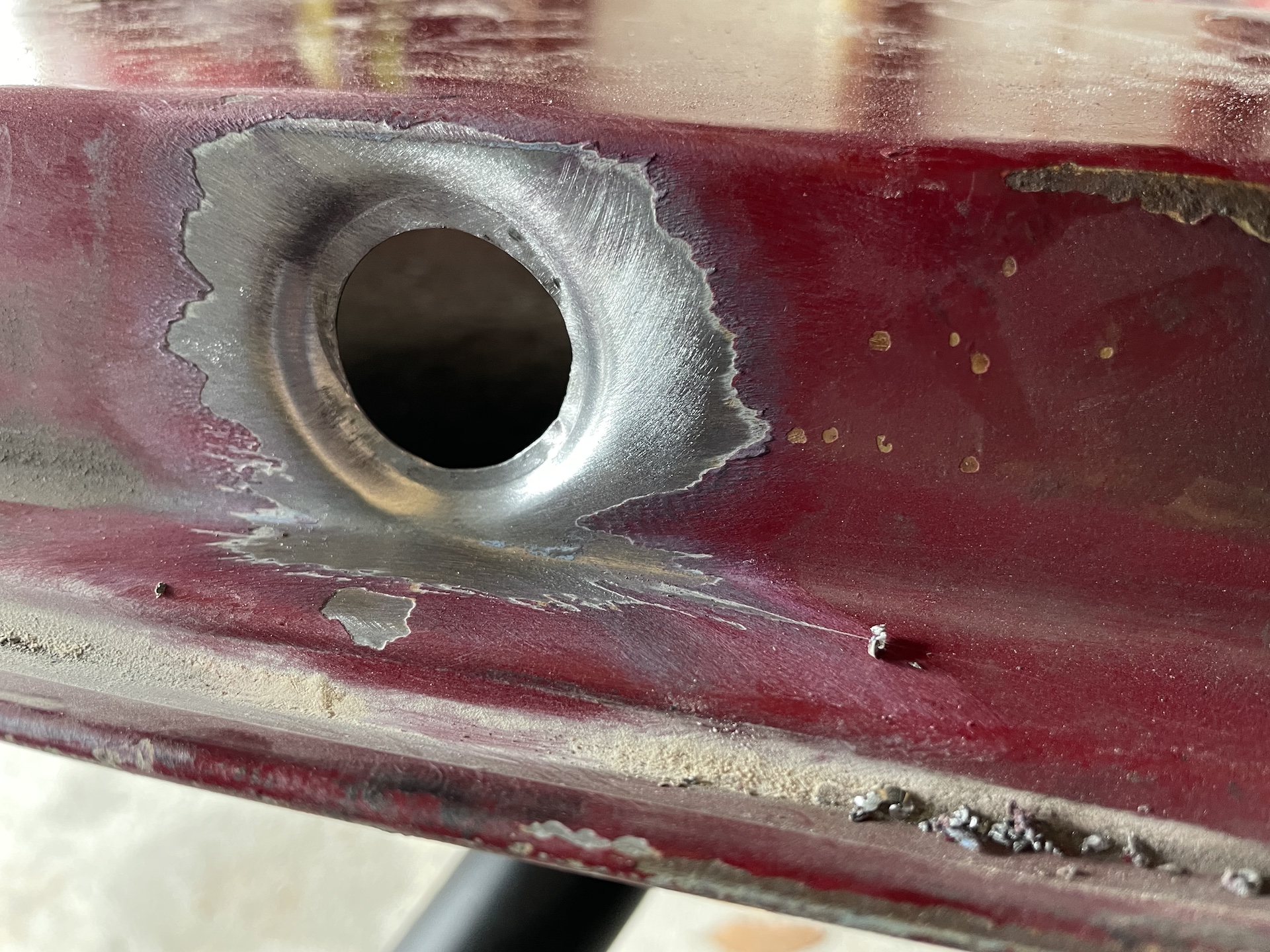

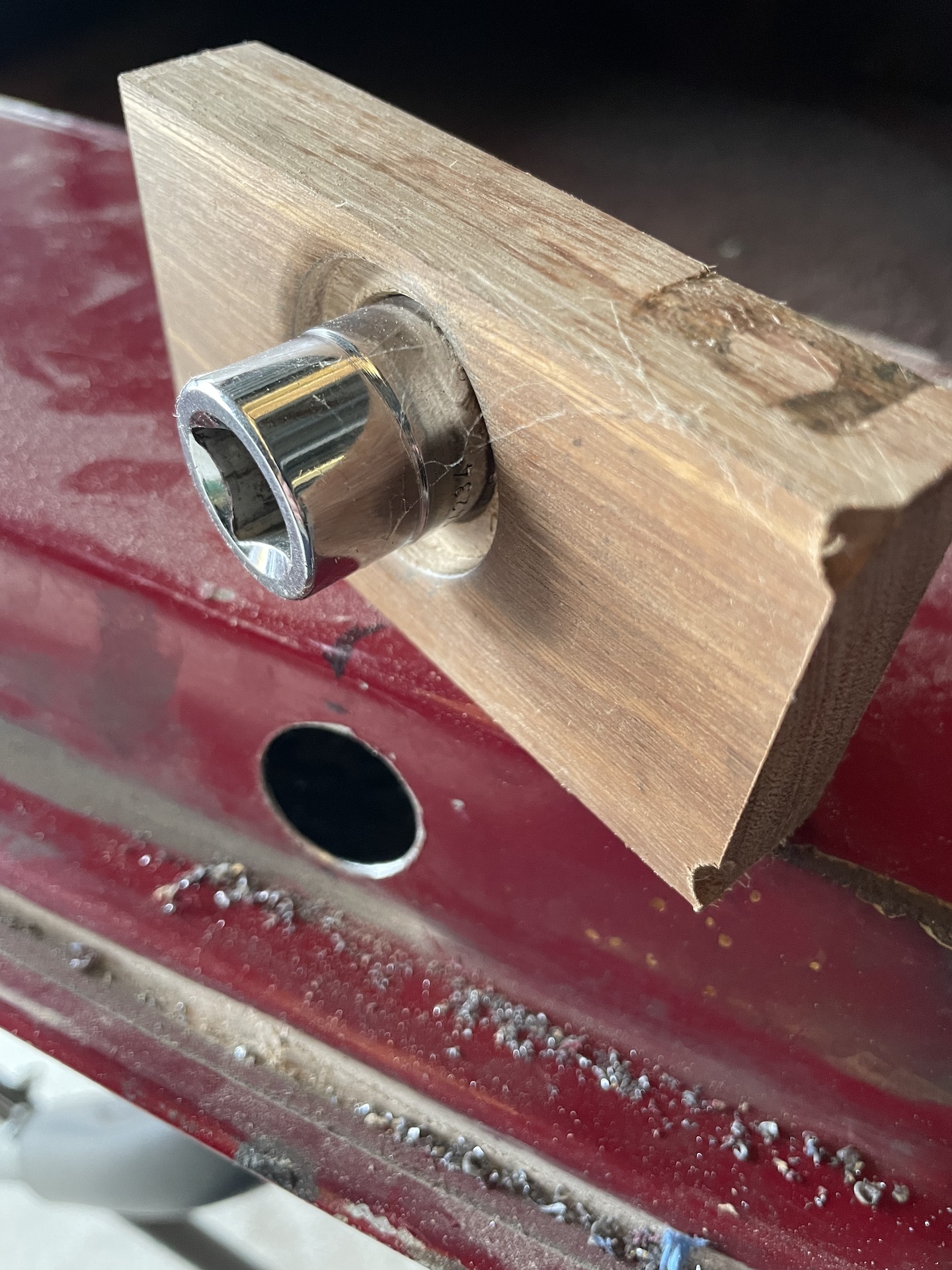

As seems to be the way I work at the moment, I jumped back on to the front doors to add some recessed holes for puddle lights.
First up, out with yet another piece of unused hardwood decking, drilled a 35mm hole with one of those drill bits that are used to recess cabinet hinges to a depth of 5mm. Then drilled through the rest of the way with a 24mm bit which is the perfect size for a guide socket to keep the wood centred. Looking at the wood you can see I have already mashed the hole edge quite a bit doing tests on scrap.
With a step bit I drilled a 24mm hole through the bottom of the door. No going back now. Hardwood/socket on the inside of the door, socket poked through hole as guide, and a larger socket on the outside (OD 30mm), all held in place with threaded rod. Tighten until - 1/ Wood splits, 2/ strip threaded rod, 3/ add dimple to door Success (with a bit of tweaking with a hammer and socket dolly) 3D printed up a 30mm lens for an as yet to be created 3D printed LED puddle light, to use for a test fit/proof of concept. Sitting flush with the bottom of the door, and managed not to deform the line of the door much.

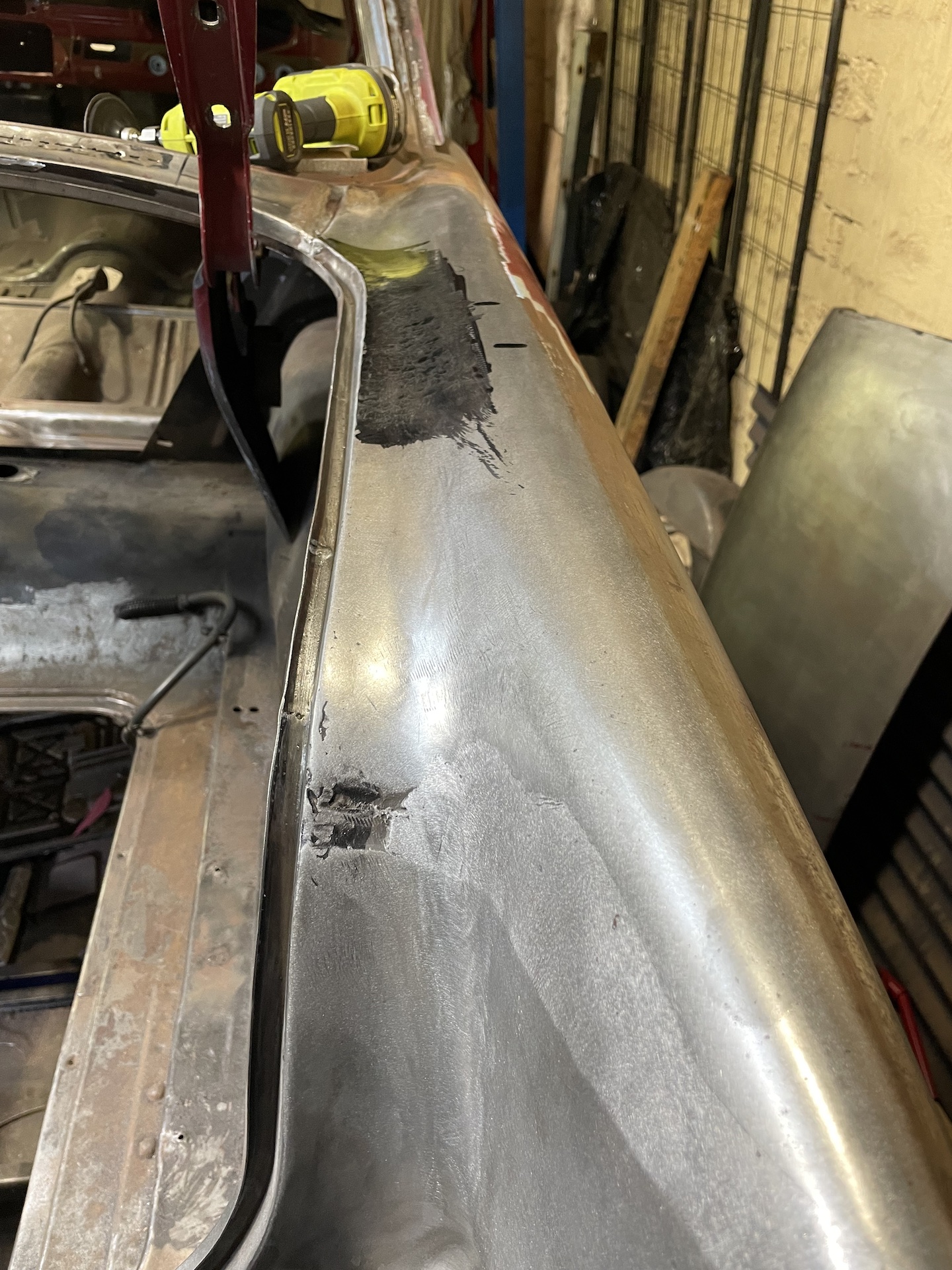

Also did a bit of work on the back of the car last weekend.
Pictures tell the story. Needed to do a bit of hammer/dolly and shrinking where the black marker is, but overall happy. Didn't have the boot lid on for the last shot but the gap is improved.
Scott
Re: Ol' Rusty - FB/EK Sedan
You've really got the hang of the steel sculpting Scotty. Going to be a ripper.
