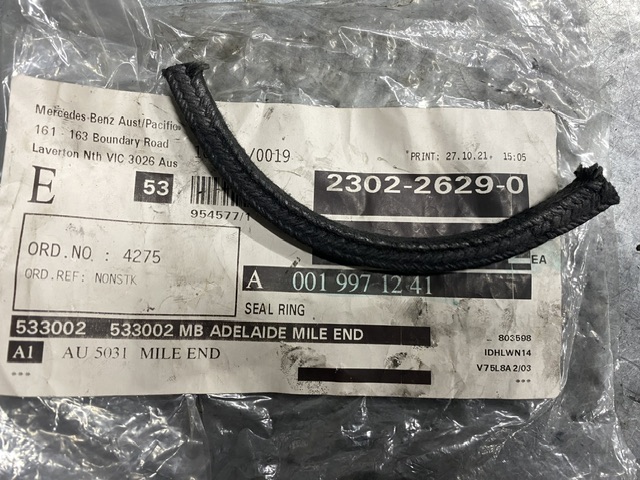

I have a nice newly reground crank and a set of .010" bearings ready to refit into this thing , but hit a bit of a snag today when I called Clive Cams and they told me its currently an 8 week turnaround for a reground cam and refaced lifters
I also need to source a gasket set and the dreaded rear main seal installation - not sure whether to go with a stock rear main , or the Fergie tractor method of Harv's , or the Mercedes rear main like Drew used in his FB wagon .

I recently installed a Merc rear seal in a fellow club member's FJ motor. Compared with the "gasket kit" replacement, it was easy-peasy. Much, much easier to cut.
But I found I had to use the crankshaft to set the seal. My fault though. I cut the seal off nearly flush when using a seal setting tool, and the ends of the seal receded about half a millimetre when I put the crank in. So you need to allow half a millimetre protrusion if using a setting tool.

Blacky my Mercedes RMS is dripping a few drops but i don’t think it left enough seal protruding when I cut on the block and bearing cap meeting faces.Blacky wrote: Wed Feb 21, 2024 7:18 pm I have a nice newly reground crank and a set of .010" bearings ready to refit into this thing , but hit a bit of a snag today when I called Clive Cams and they told me its currently an 8 week turnaround for a reground cam and refaced lifters![]()
Discuss.
I’ve done about 1000 miles now and it’s a drop or 2 a day on the driveway… all I can do is see how it plays out.
I think the Mercedes seal is a good option, it’s tough as nails and I can’t see the rope failing, but yeah extra protrusion for the crush on the joint faces is crucial.

Cheers Drew, I don’t suppose you have a part number for it ???

Mercedes part number A 0019971241
When you get it throw it in an oil bath straight away, leave it weeks or months if you have to, it won’t hurt it.
I soaked 1 for 24 hours and it was still hard like a rock, the next I soaked for about 6 weeks and it was way easier to work with.
Oh yeah and when the RMS leaves more oil on the ground than what drips out of the hockey stick I’ll let you know… until then I’d say it’s absolutely perfect

Thanks mate, will order one Monday and get it straight in the tub
