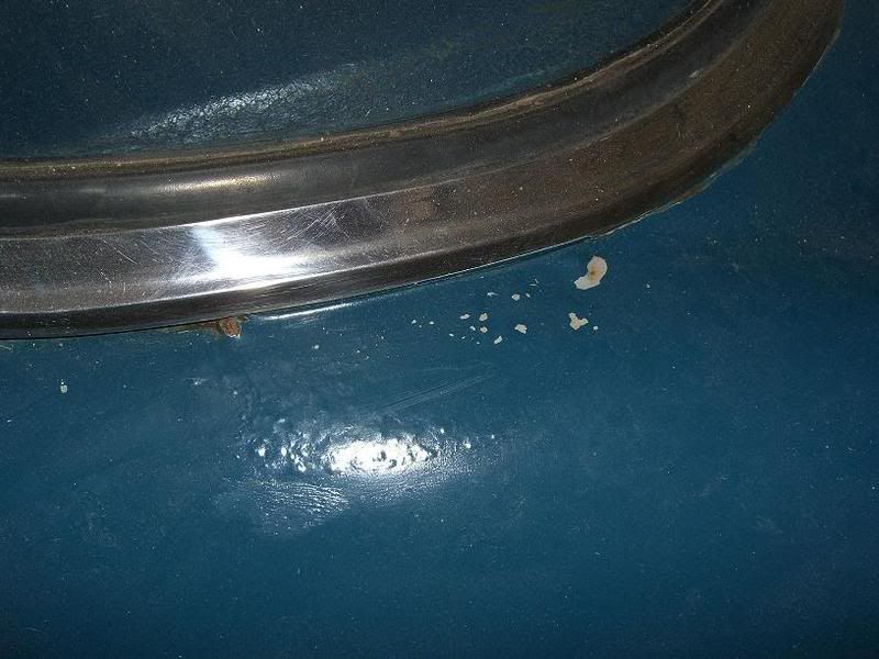

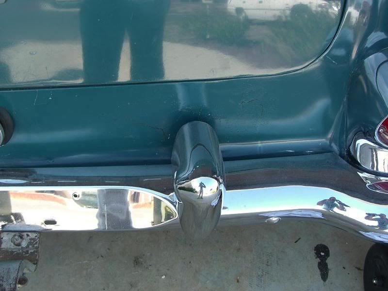

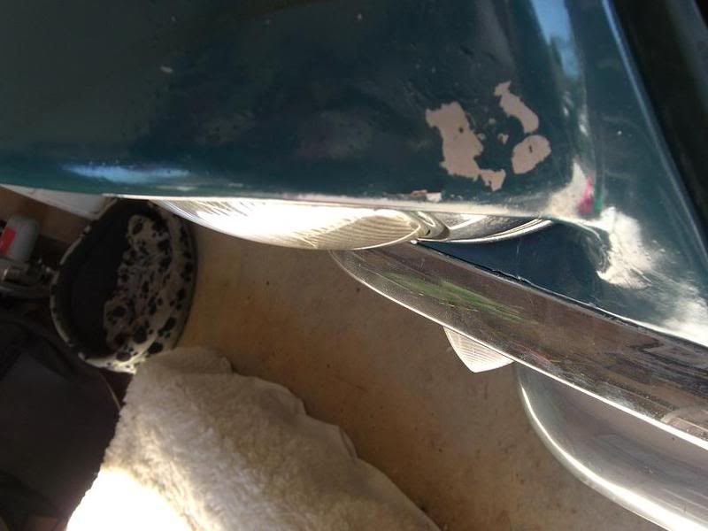

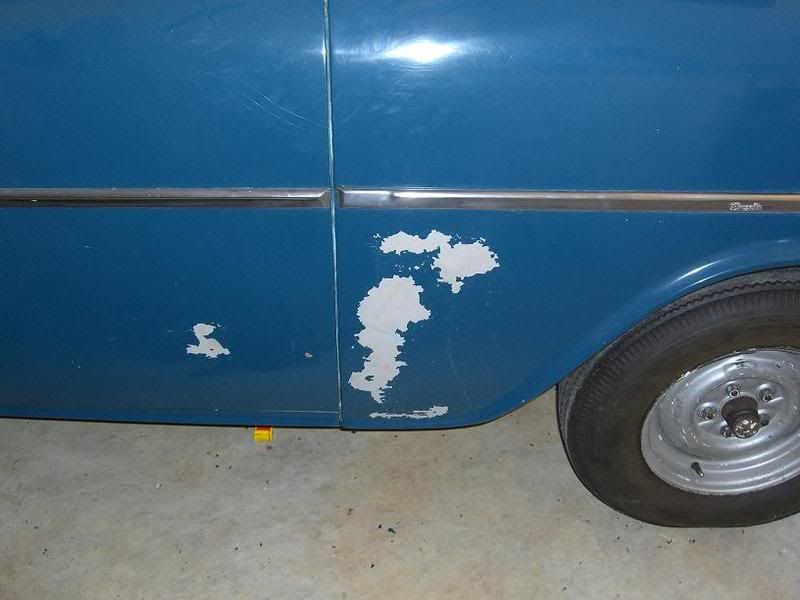

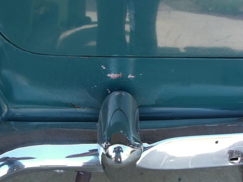

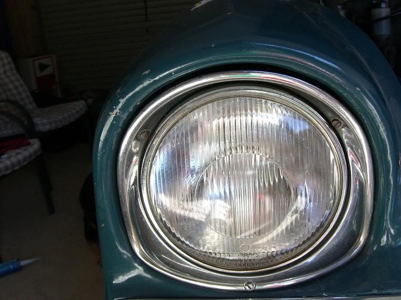

Steve here are some pics of the problem areas..
Right Head Light
Right Head Light
Rear right where repairs were done a long time ago
Little bit of rust
Same repairs as above
Right hand side where paint has sweated and is very brittle
Left Front door paint sweat
Close Up
Slight rust front left upper guard
Any advice as to whether i can repair this would be appreciated.

to be honest i dont think its factory paint in a lot of spot cos i dont think it would flake off in that manor .. and looking at the pic there is a bit of cancer fidding under the surface .. so matching the old with the new will be a hard task ..
just my thoughts D
