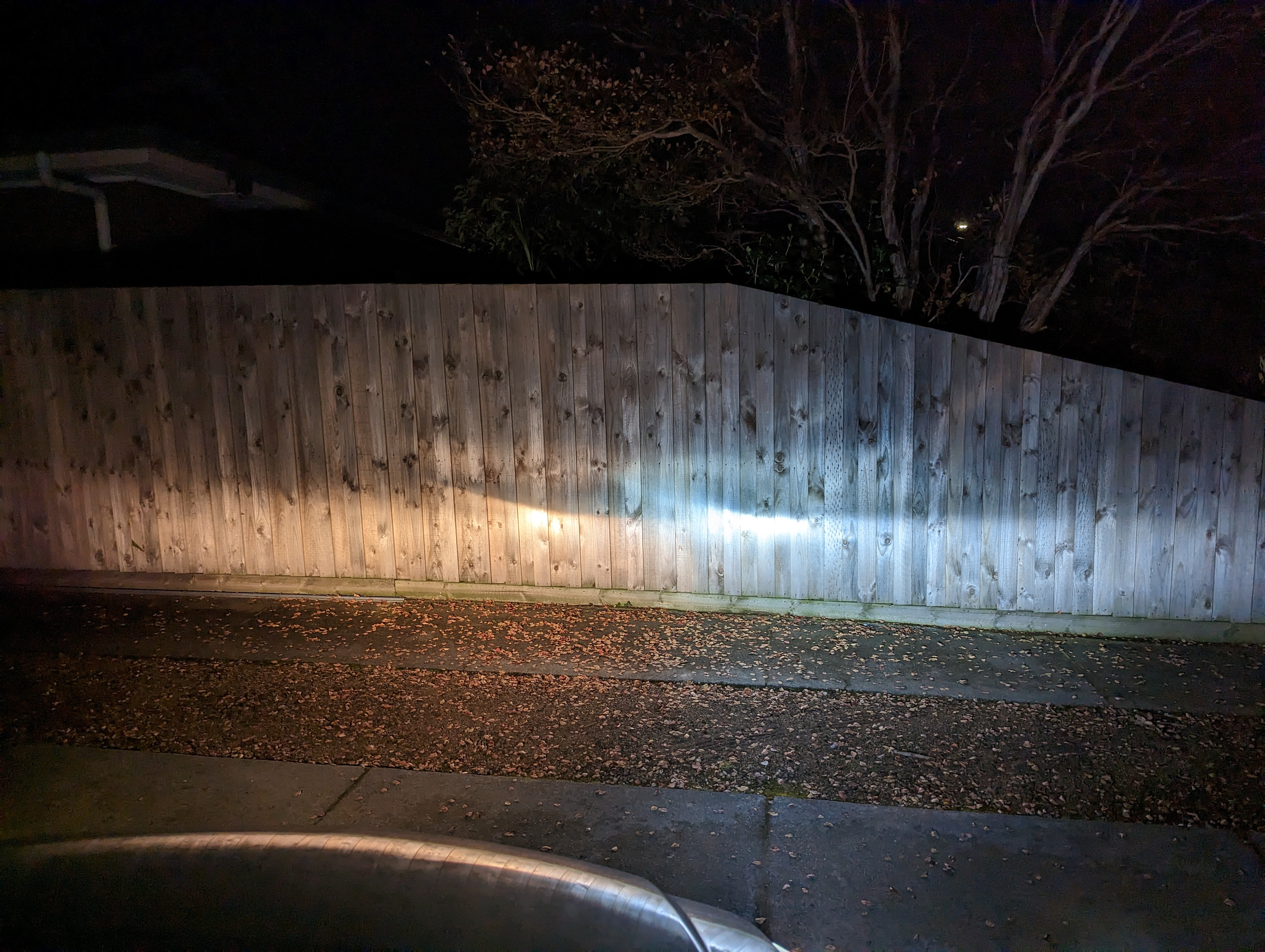

Post by briby »
Have a look at Narva, they have 7" Hi/Lo & DRL, don't like the look myself, i have the H4 conversion #72002, they're called free form or reflector headlamps & then a reputable LED globe to go in em. Unbelievable low beam improvement not so sure about high beam, don't do a lot of night driving,i have the same LED's in our daily driver, this is from the daily
Don't have to be Einstein to tell the LED from the halogen (Phillips +130).
Briby
