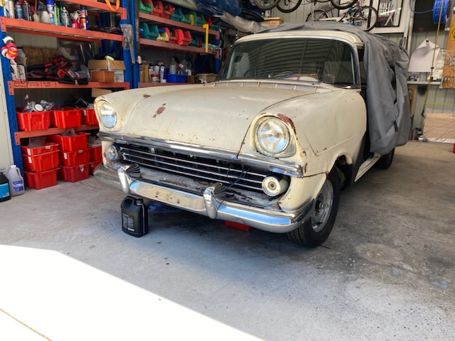

Got the bonnet on!

Re: FB Standard Wagon
Awesomeness
I hope you are planning on coming to Echuca ?????

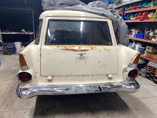

Just had to dummy up the tail light lenses so I could check it out!
Ooooh yeah!
It looks great Drew.
