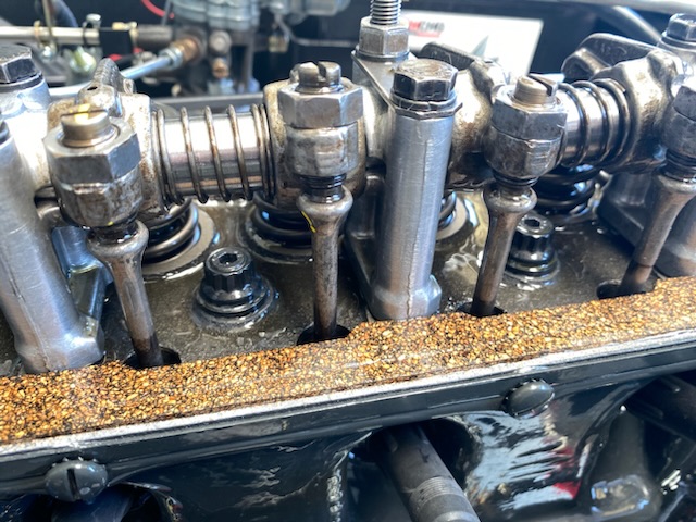

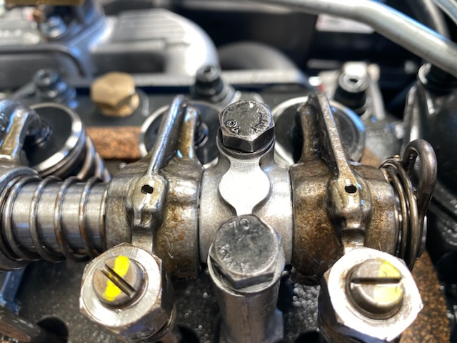

I pulled the rocker cover off to see what what going .
Wiped the front 2 rockers dry and at very low idle start it up.
Took about 10 seconds for a dribble of oil to flow.
Mind you the rocker tube was already full of oil.
I suspect it will take longer to flow on a cold start.
Seems there is enough oil up the top end.

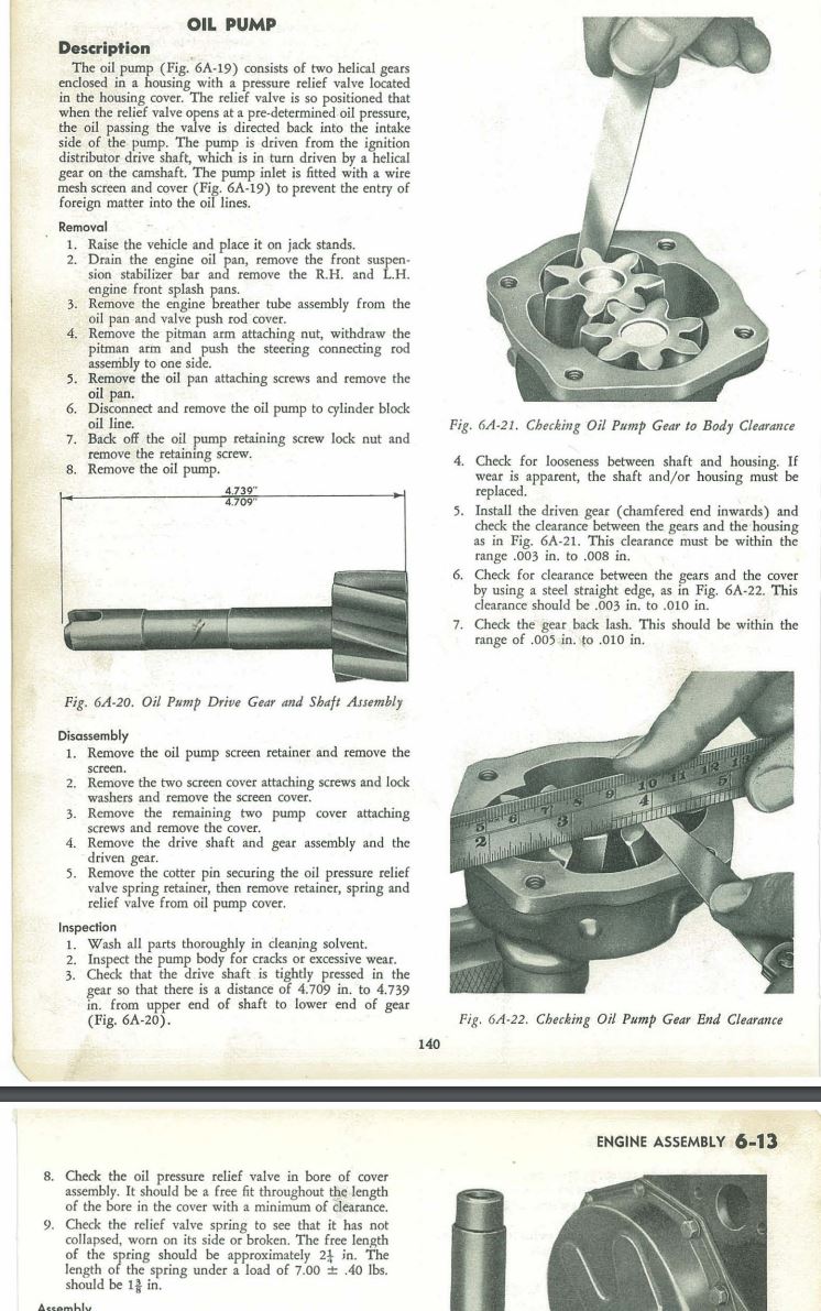

You could try shimming the relief valve. Relatively easy to get at, and cheap. That might give you a few more psi. If you go down that route, then check pump clearance whilst it is in pieces:
Can't remember if you rebuilt the oil pump on this. There are rebuild kits available, but you may need to sell a kidney to afford one:

How much of this low pressure issue would I account for with the 15/40 oil do you think?
Oil pump work means sump off / motor out.
Yes I did rebuild the pump and checked all the clearances which were all on the tight side of the specs.
Had a play with the relief valve as I mentioned and stretched the spring out- which now could be a questionable move.
Only try thing I have left to try at this point is thicker oil.
Or is thicker oil only masking the problem ?
Would you expect correct pressure with 15/40?

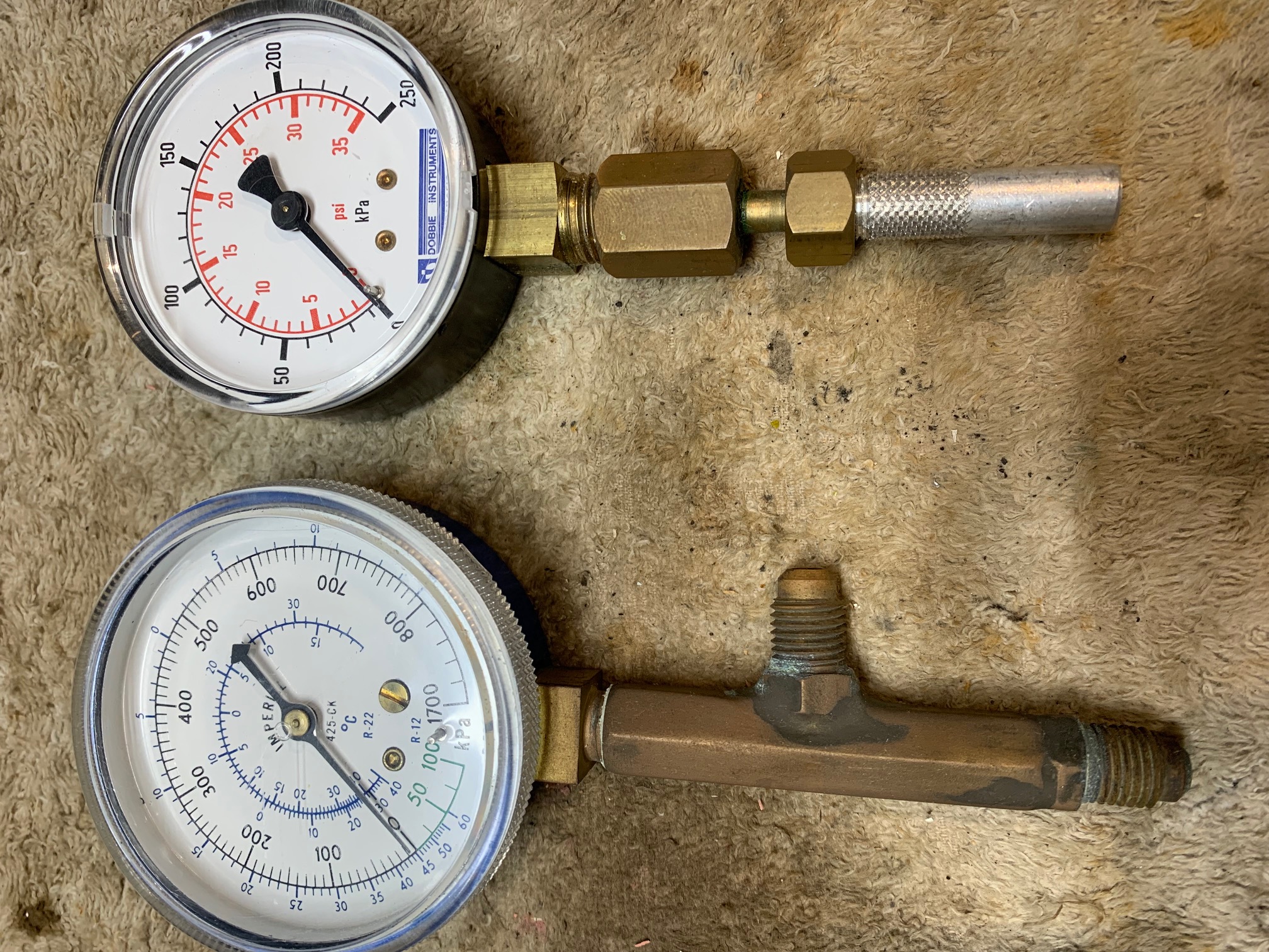

Have you another oil pressure guage just as a crosscheck.

Hi Drew
I think I have some gauges home if you’re looking for a second one as ehsv6 suggests.

Certainly an interesting issue this one. Here are the gauges I have Drew. Do you also need to borrow my grey motor Ute too

Umm yep those gauges look like I’ll need to put my thinking cap on to get them connected!
Yes please Stephen maybe you could come over and I’ll throw my oil pressure tester on your bus and we can see what it tells us.

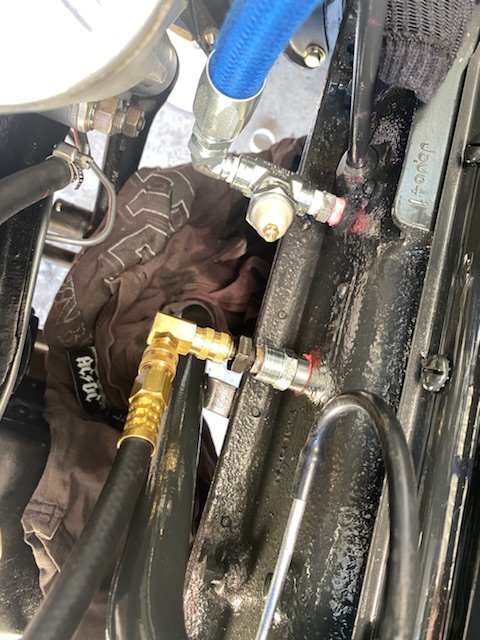

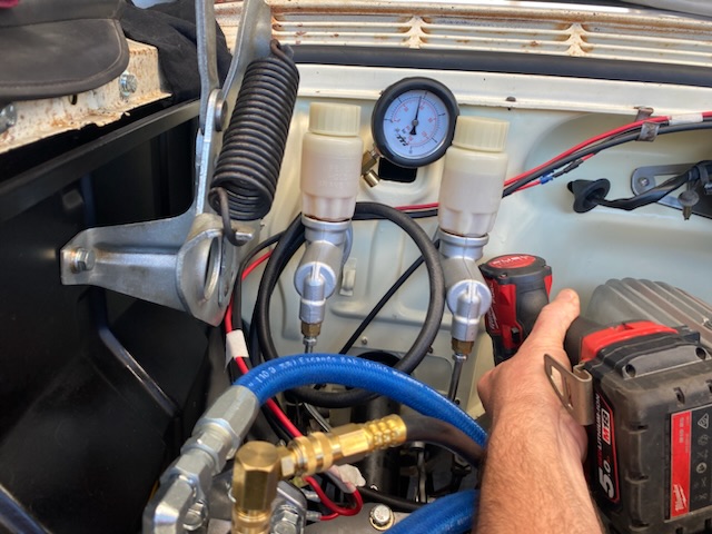

Thanks Stephen, I got the gauges from my front porch.
I went for the first step in diagnosing the low oil pressure.
I removed the dizzy, connected the tester to the oil pipe outlet direct from the pump and spun the oil pump with a drill.
Pressure was 50 psi which I am more than happy with.
I looked up the Milwaukee website at the drill spec is max revs of 2000rpm.
So I know the pump can produce 50 psi at 2000 rpm
So for now I’ll pass the oil pump as ‘OK’
I was really hoping the pump would be stuffed as it would explain the low pressure… now I have to dig deeper
