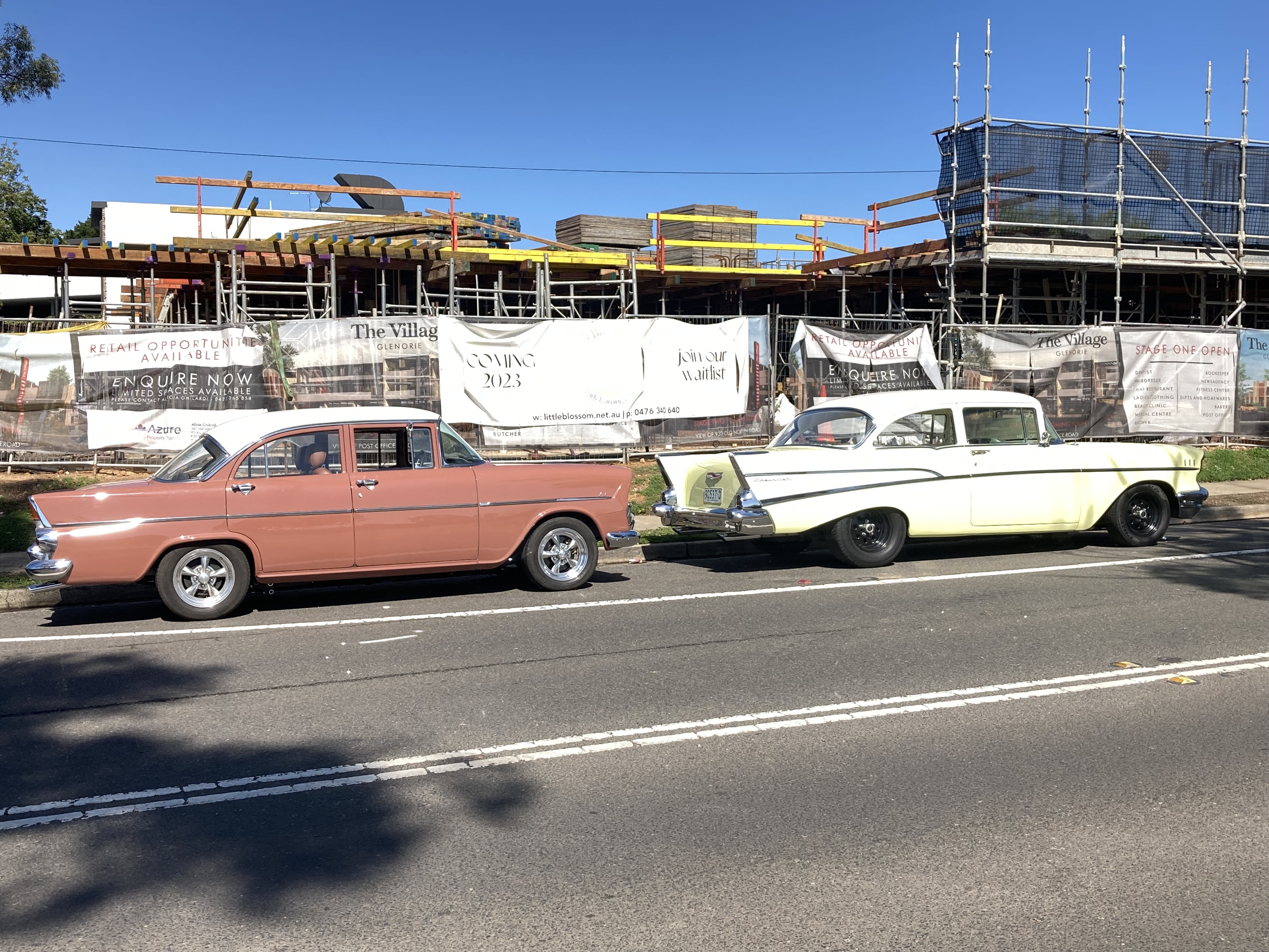

Over all very happy but still got to fine tune some things, Couldn't resist a photo with big brother today. Realistically the cars are so different but I suppose the inspiration was there in design.
What a great day out !!!! Hopefully many more soon.

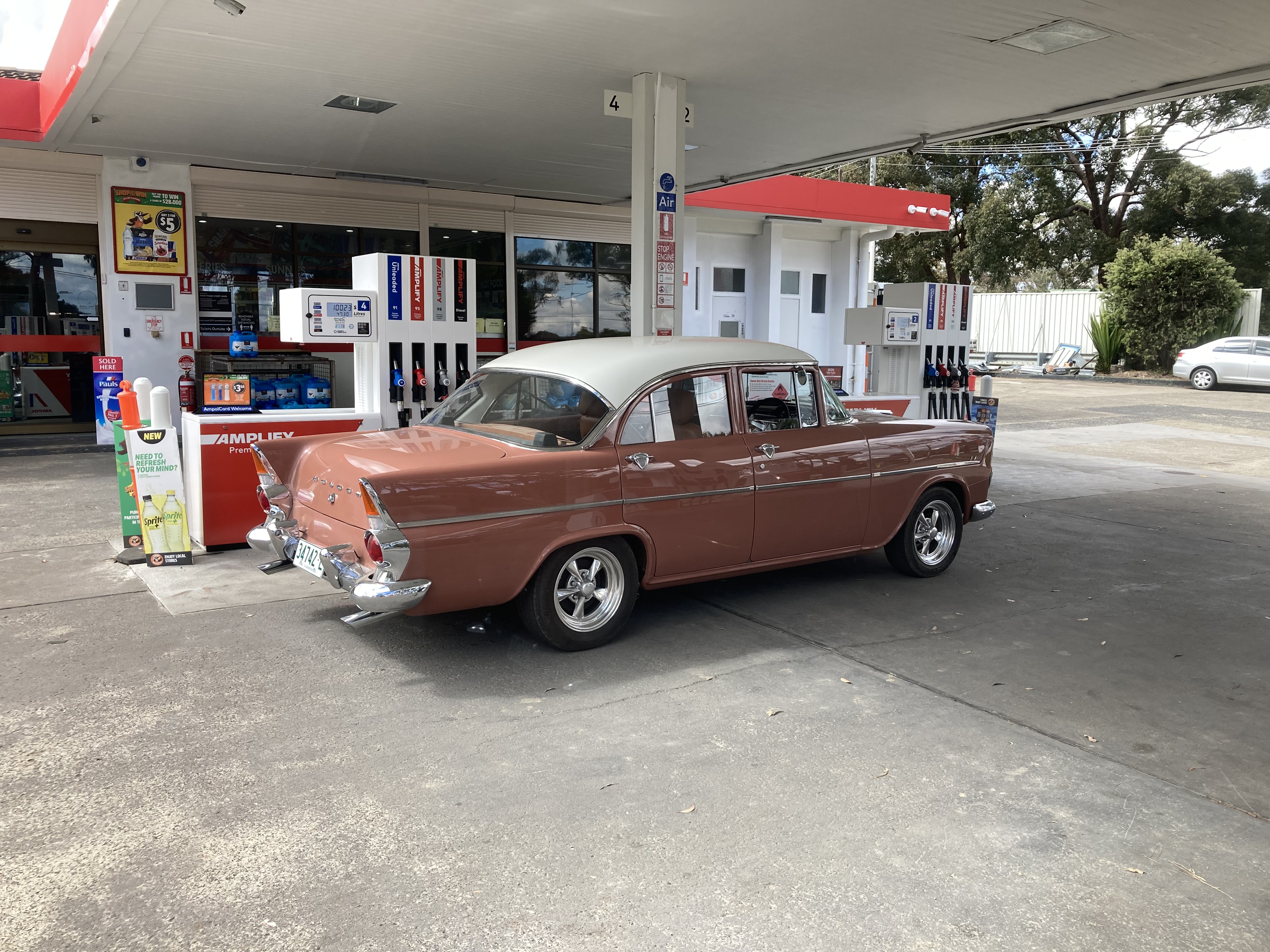

More Kays today !!!!
First fuel station fill, I'm starting to enjoy the cruise.
Need softer and lower springs up front, but otherwise sweet so far.

Cool - looks good for an EK :ebiggrin: :ebiggrin: enjoy the ride mate :thumbsup: :thumbsup:

Nice mate. Those back tyres look like they need some material “machined” off the treads.

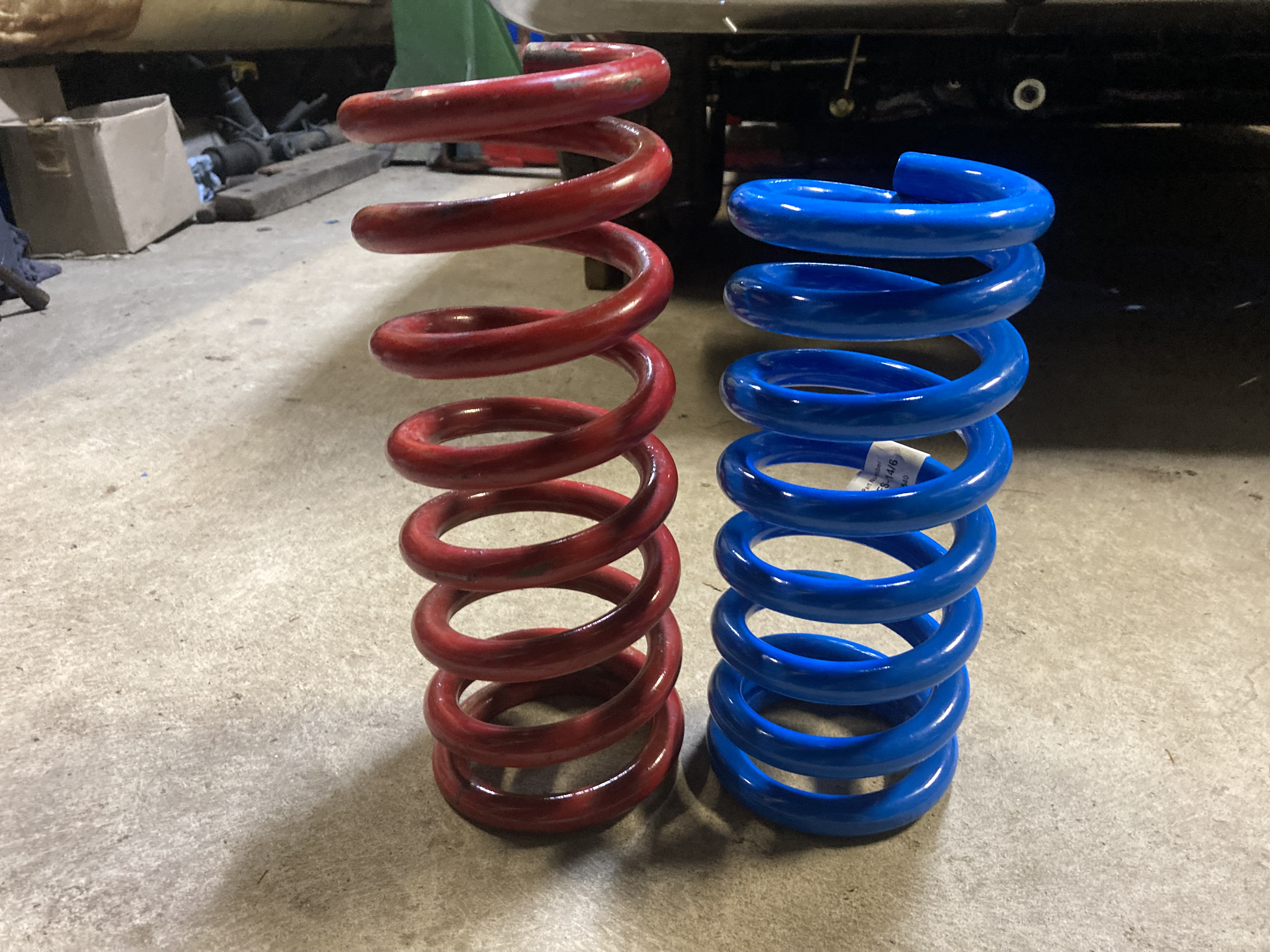

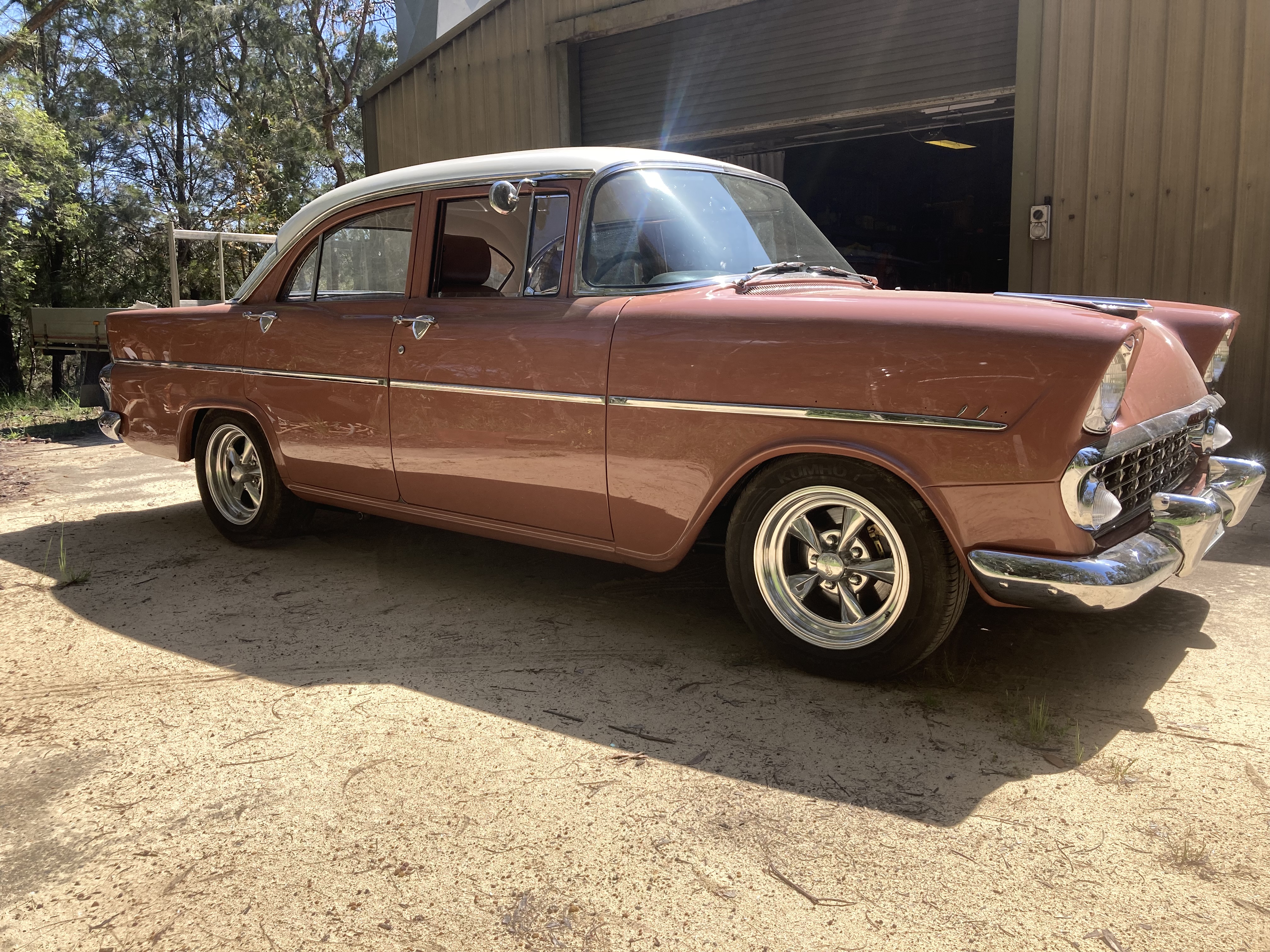

Got new boings the lovells kind.
Its unchartered territory here, standard height 6 cylinder springs for the softer spring rate.
I will loose another 2okgs with alloy heads, hopefully some more power as well
Torrie springs not easy to change, especially if you value your fingers and nogin.
Final ride is nice and smooth, exhaust hits the hump in my driveway, never finished really !!!
Posts: 2262
Re: Chev EK
Yep looks about right height now compared to the earlier pics at the servo 👍
