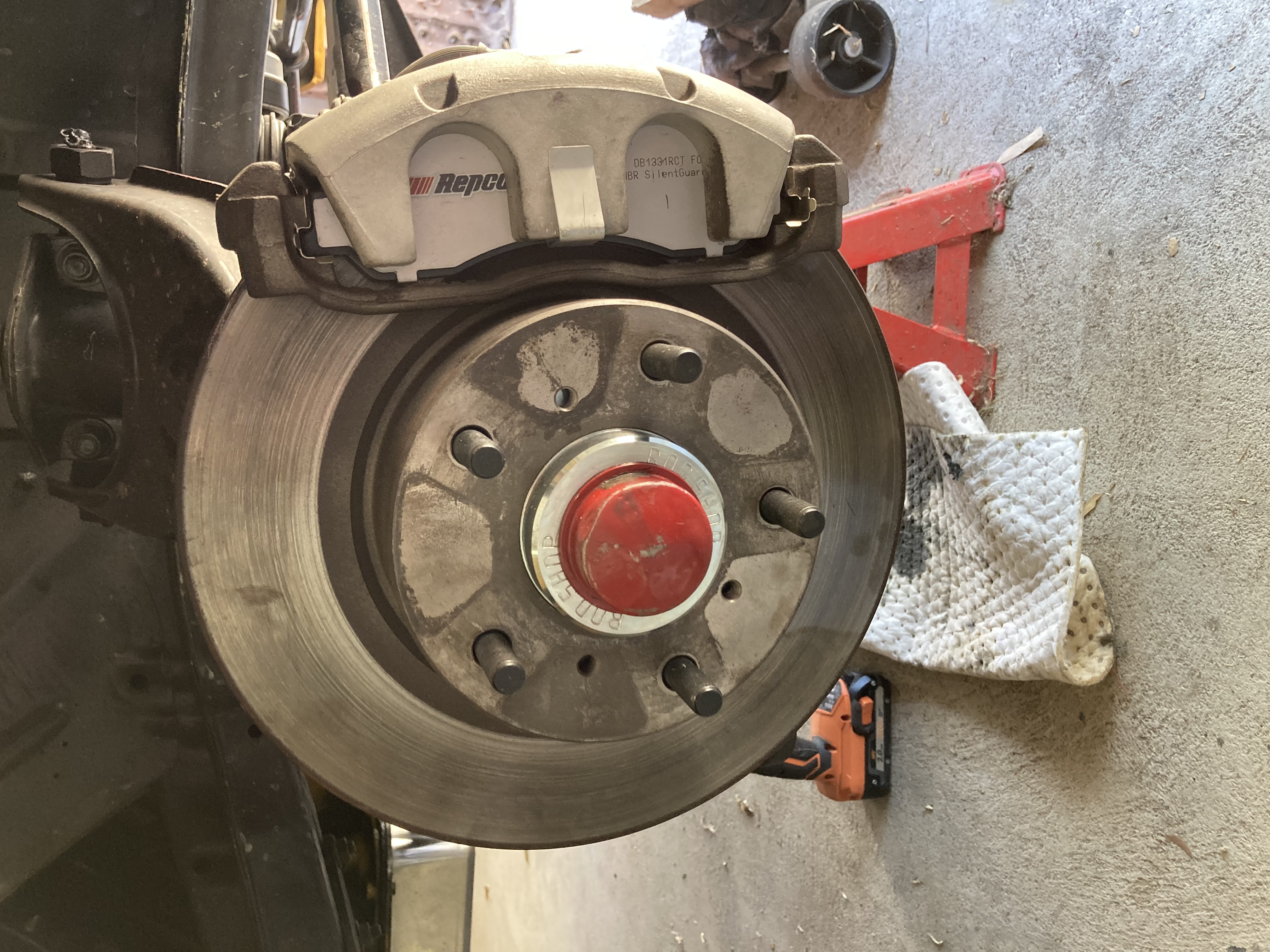

Hi Roger;
Yes you are right I had an issue with rotors as you say, this was before I did the VT twin piston caliper conversion, I was running VP calipers and standard rotors, when I bought the drop spindles I had that issue of not enough contact area, when I did some checking I found that the Calais had a slightly larger diameter rotor to standard so I changed to them and it sorted it out, when I rand CRS to find out what was going on they had no idea :roll: :roll:
I run 16" commodore rims as you know and found that I had to run HR steering arms but I also needed to rebend them slightly inwards to get enough clearance.
My rims/tyres are 195x50x16 front
205x50x16 rear
Hope it helps Roger let me know if you want me to get the rotor size for you that I changed to.
What they were like to start with
With new rotors

Thanks Neil forthe refresh on the disc size. It seems the V6 were 270 mm and the V8 were 290mm.
All sorted with front brakes other than the steering arms.
The 16" rim fits and looks ok on the front.

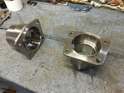

I purchase these from Rod Tech from the VN diff.
Bearing carriers.JPG (134.24 KiB) Viewed 3105 times
Gledge suggested these as they are far superior than the factory ones.
With the jig from Gledge, all should line up and be perfect. :lol: :lol:
