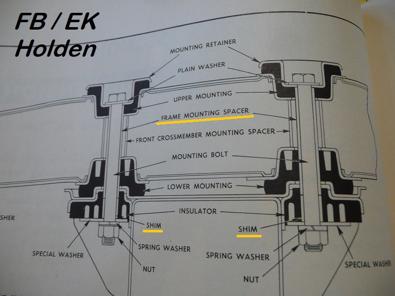

My understanding is that they contact the cup washer above and flat rectangular washer at the bottom, thereby limiting compression of the rubber component to varying degrees. The front outrigger appears to have some range in vertical location which would enable tilting of the crossmember. Rob Shaw will have more to contribute no doubt.

Post by oz_ek »
HR front end....
HR front end.jpg (101.34 KiB) Viewed 16930 times
Posts: 11669
Re: EK / HR front end crush tubes.
Pretty much I've just taken out the short shim tube, along with the bottom rubbers, when fitting the HR crossmember. The long bolts get very close to the end of their threads. I recall maybe cutting them another few turns or you can get shorter bolts or add spacer washers of course.

The HR crossmember bolts are shorter than the EK ones. Can measure, if needed.
The long spacer for EKs comes in two lengths, with the longer one installed at the rear. Can measure, if needed.
When I did a front disc conversion on my EK, I used HR bolts, spacers, washers and rubbers. It might be possible to substitute the EK top rubber and top mounting retainer for the HR top rubber and washer, but you'd still need to use HR bolts, spacers and lower rubbers. (And, of course, you still need the EK outrigger rubber.)
