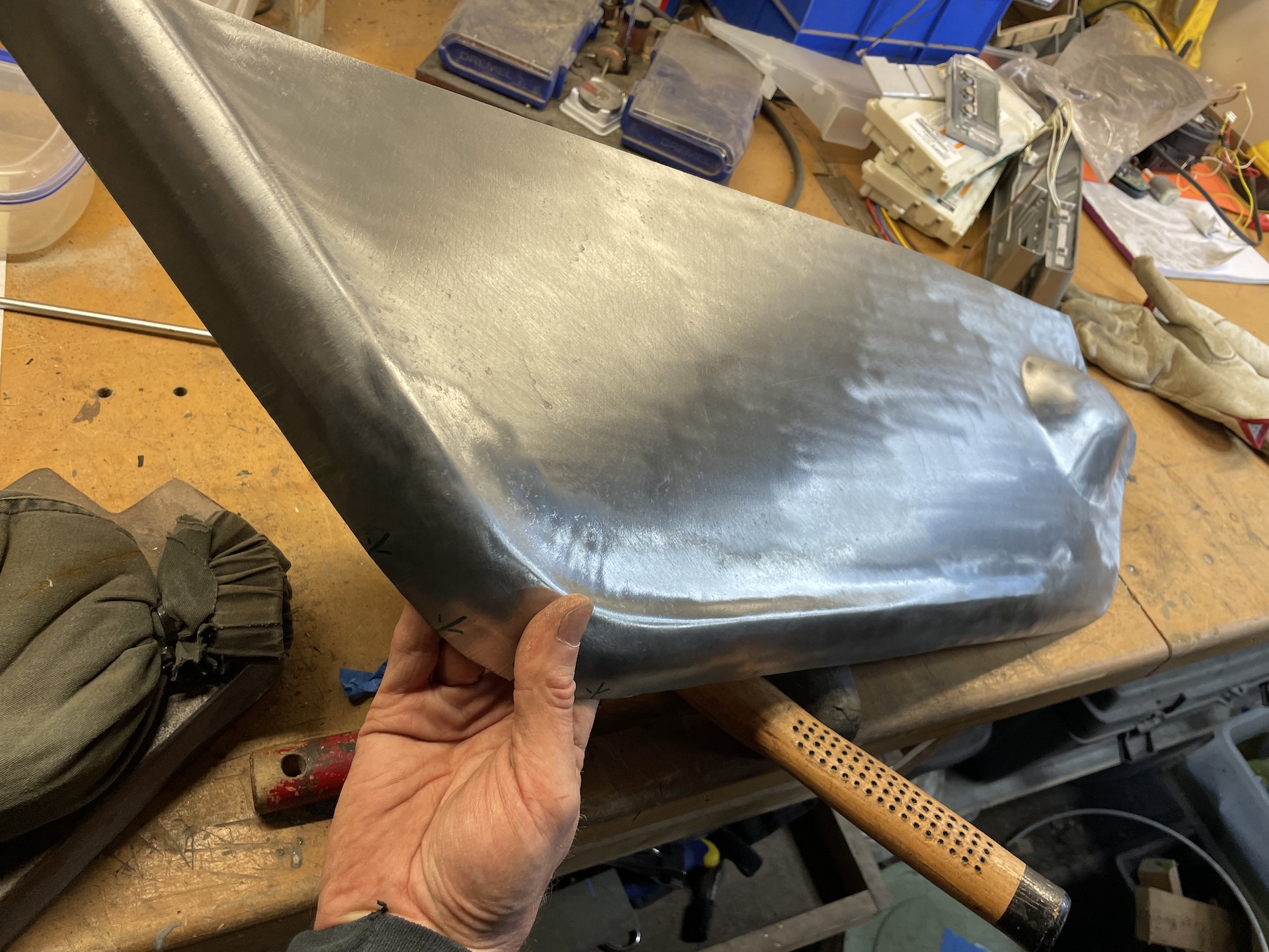

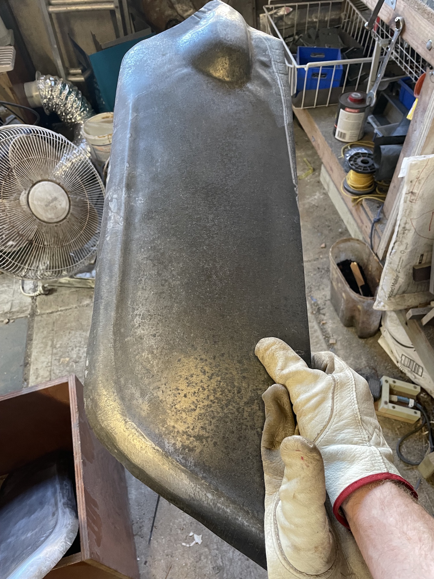

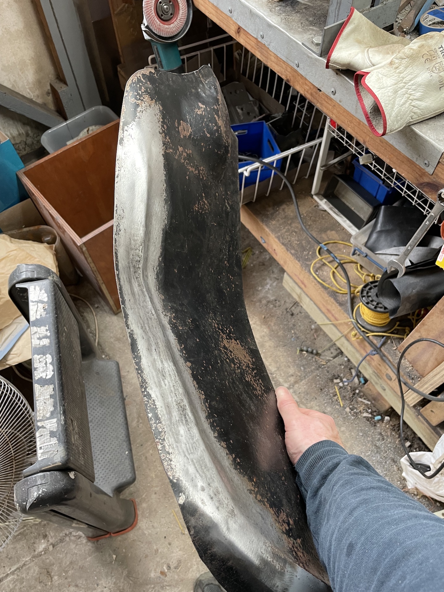

Had a go at shaping the rear quarter panel with my knee to see if I could get a bit of curve in the panel. Well got a bit more than I need....

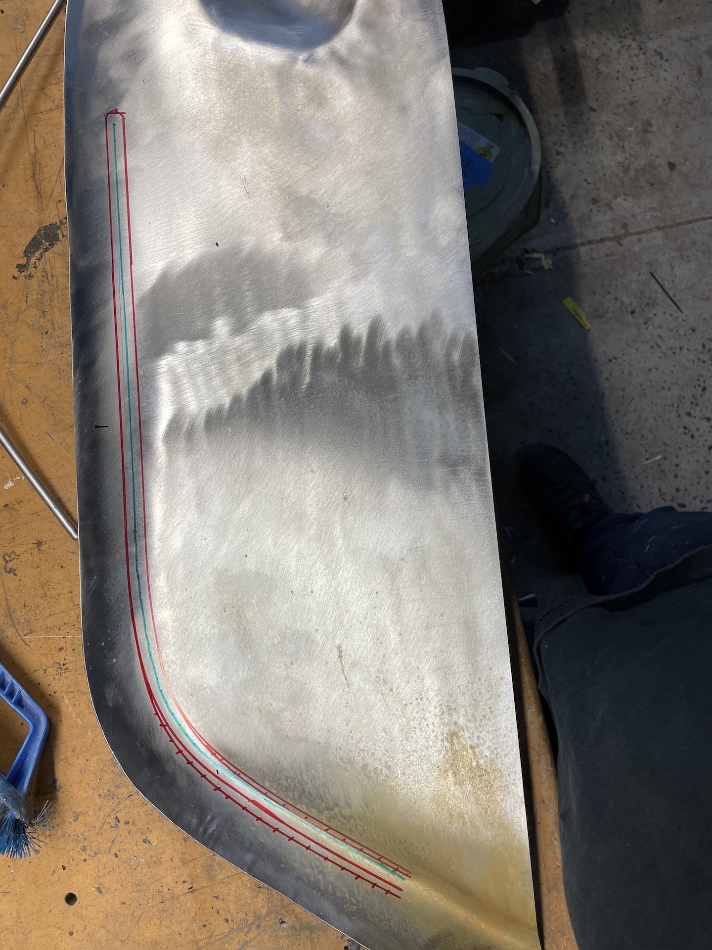

Decided might be about the right time to straighten it out, and put it in a nice warm acid bath.
Swapped it with the passenger side which had been soaking for a few days. With a quick wire brush this one scrubbed up alright. The rod I used first time round is great to draw out the line to use as a guide on the inside of the panel

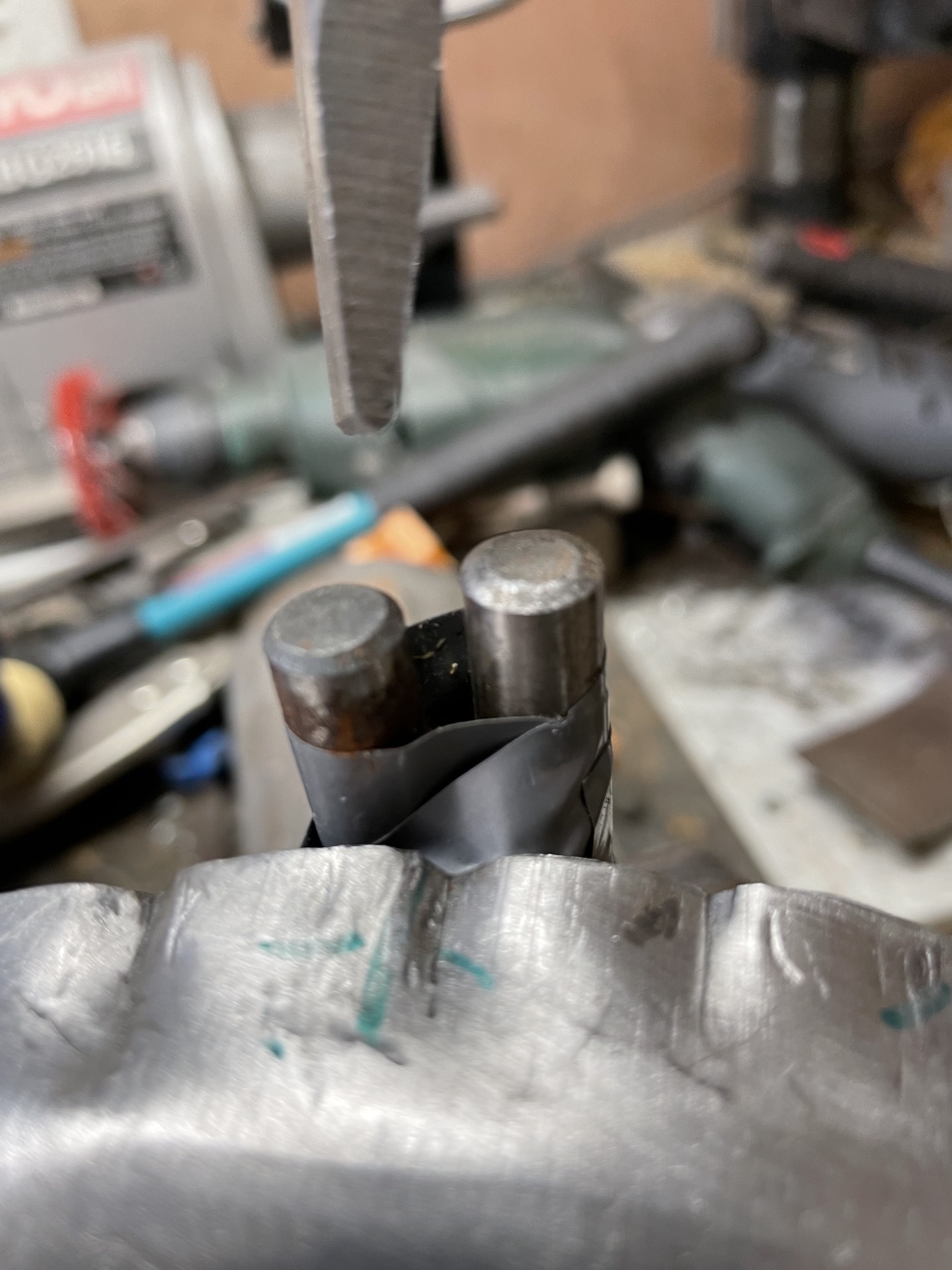

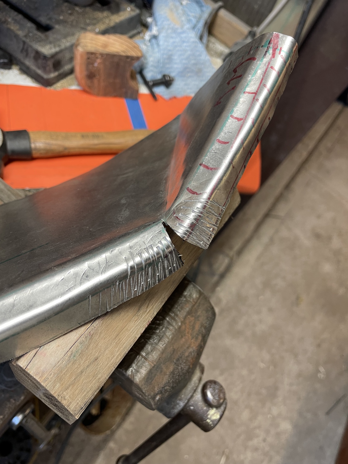

Repeated the process from earlier. To help the panel curve I shrunk it a bit more. Cold chisel, a couple of old drill bits with a washer between them and some ducting tape does the job.

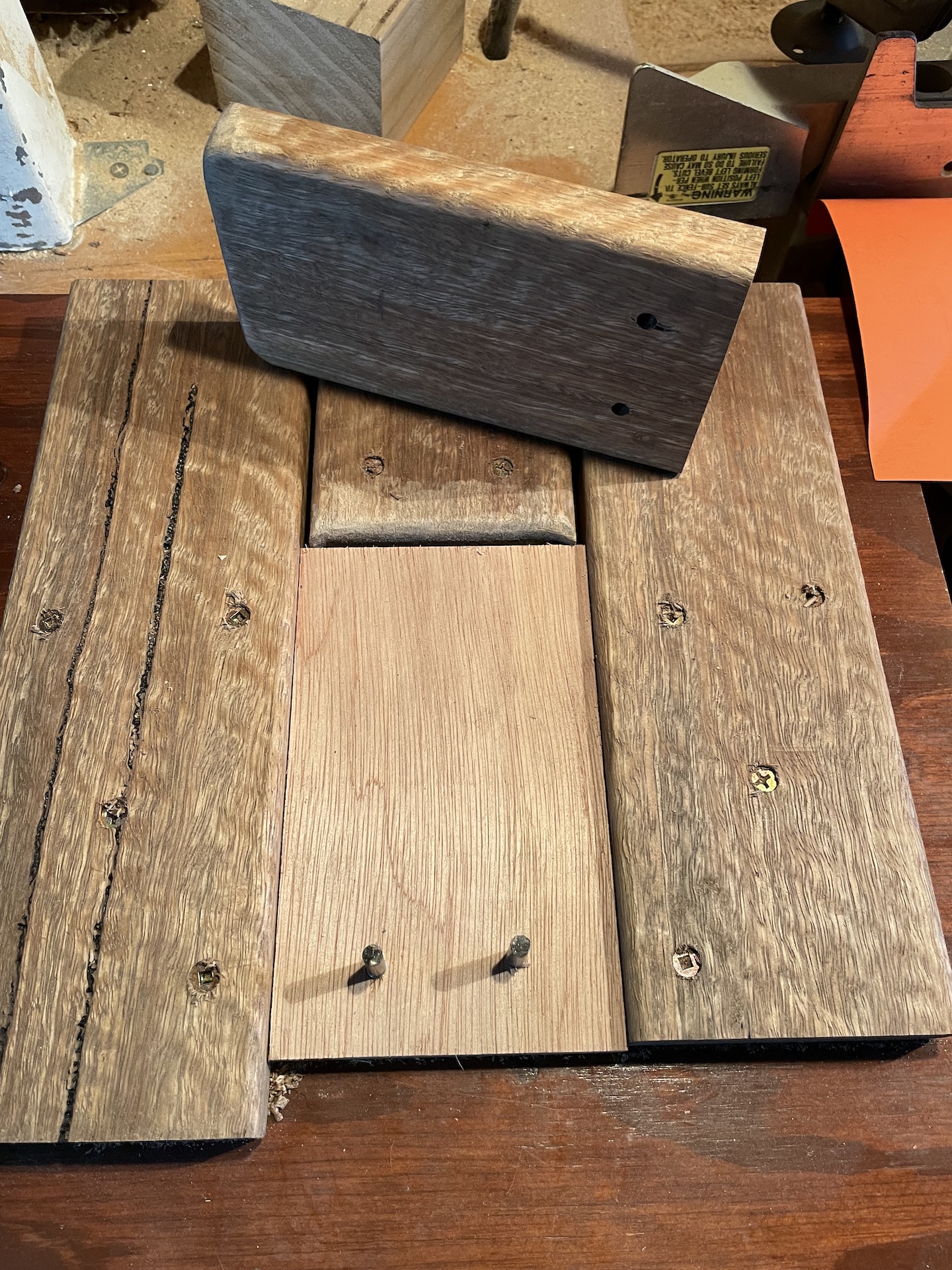

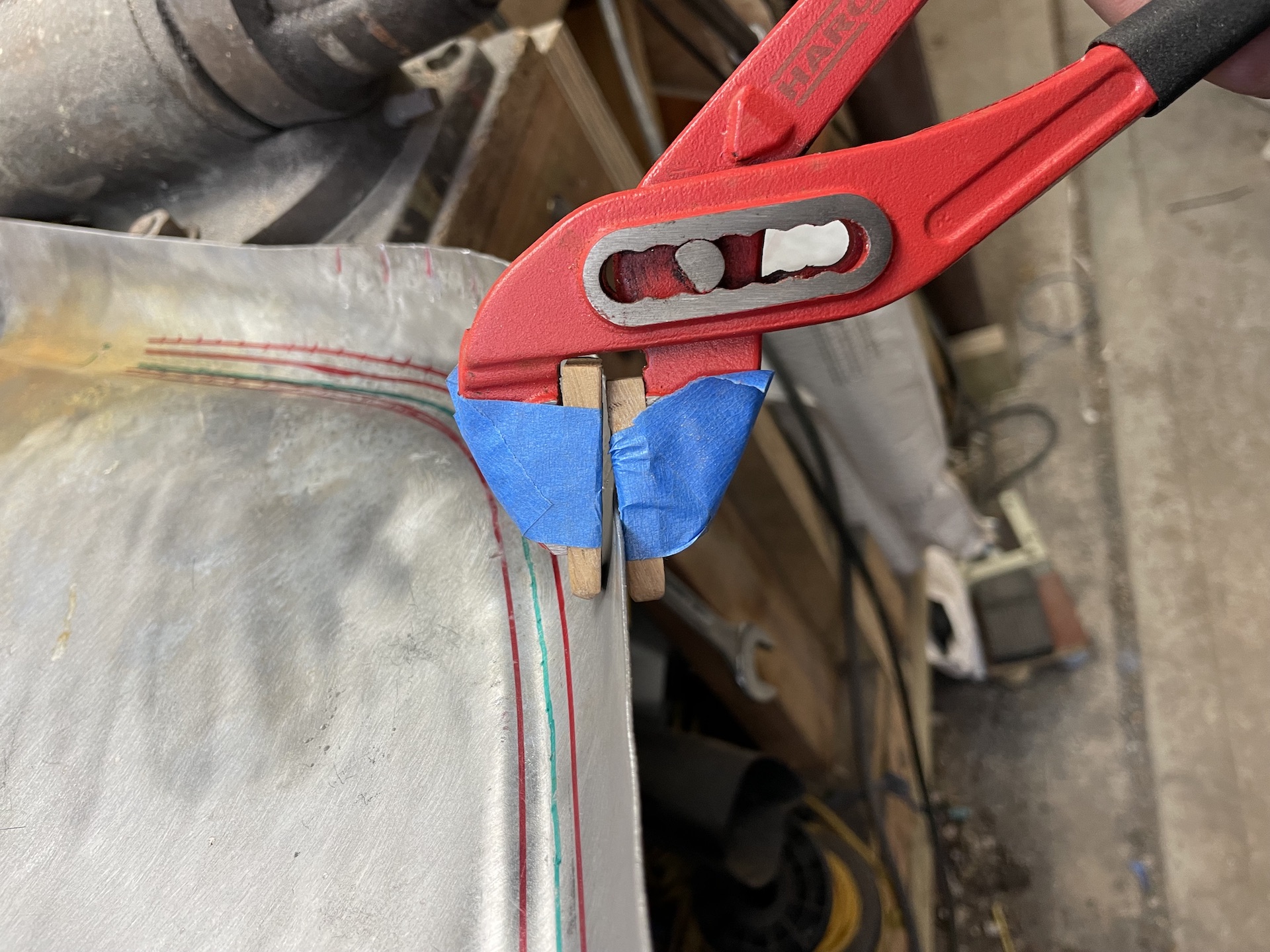

Using a shifter to help with the bends leaves little scratches so I decided to make some soft jaws out of hard wood and masking tape.
Here is the result

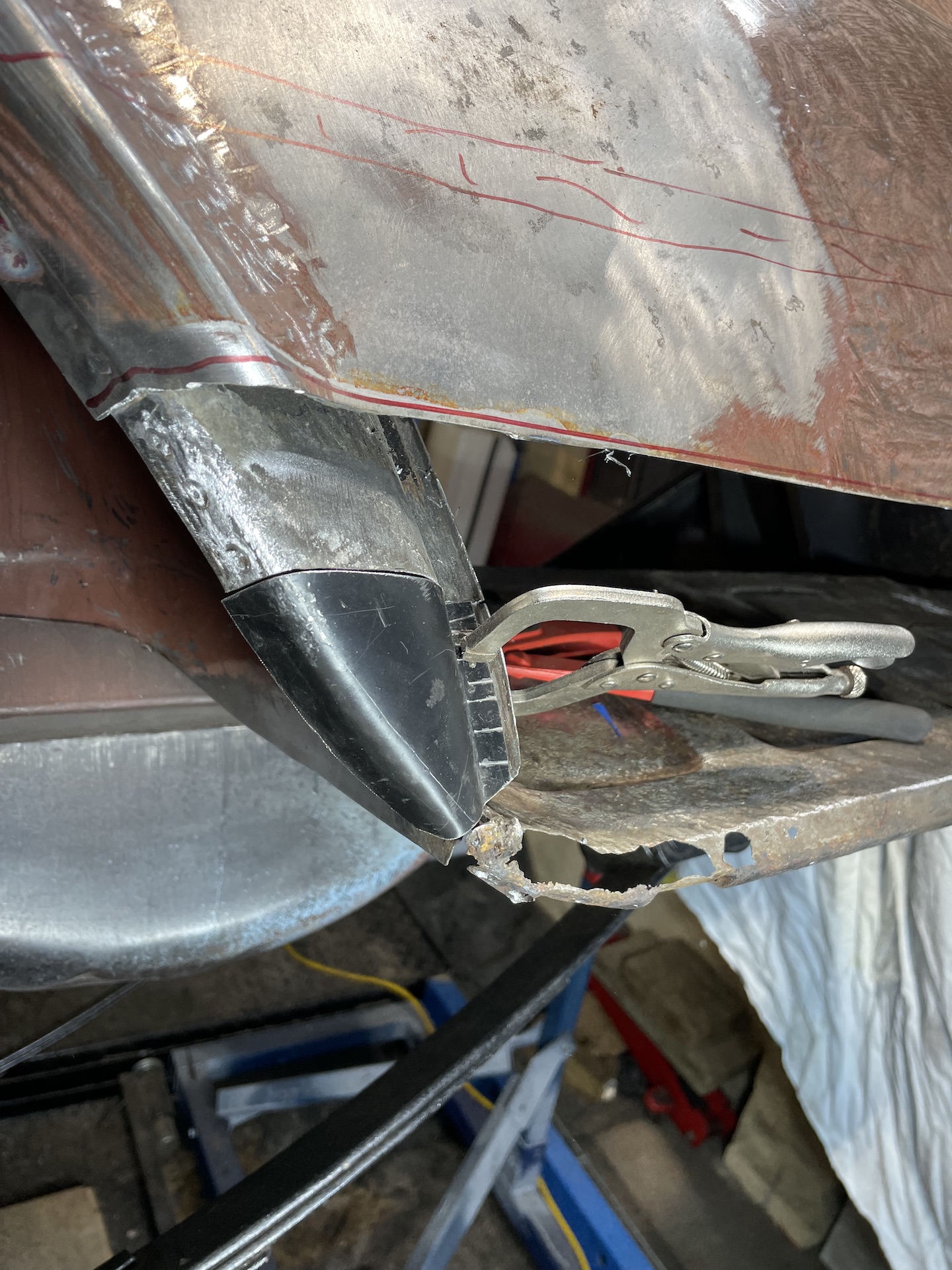

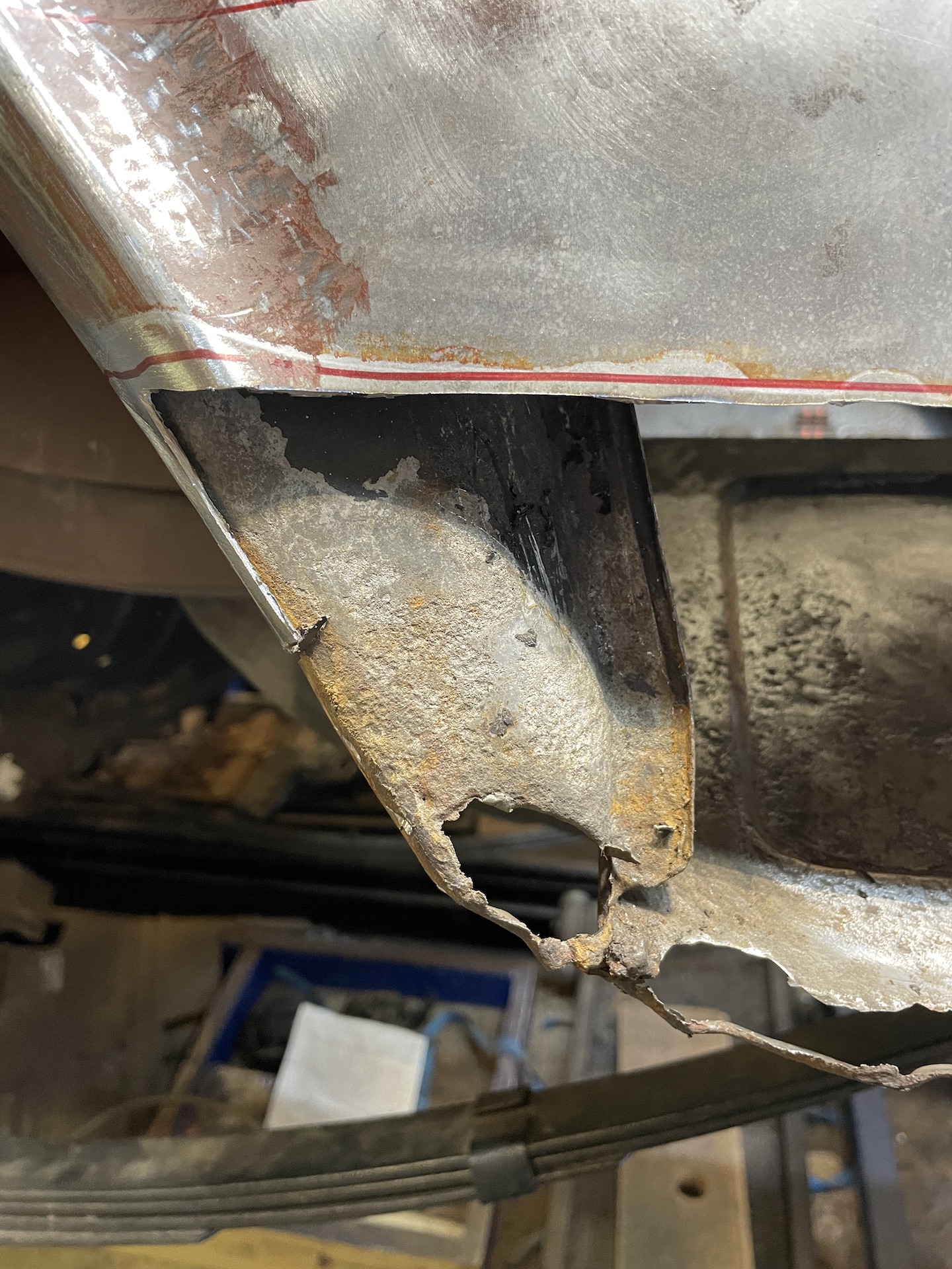

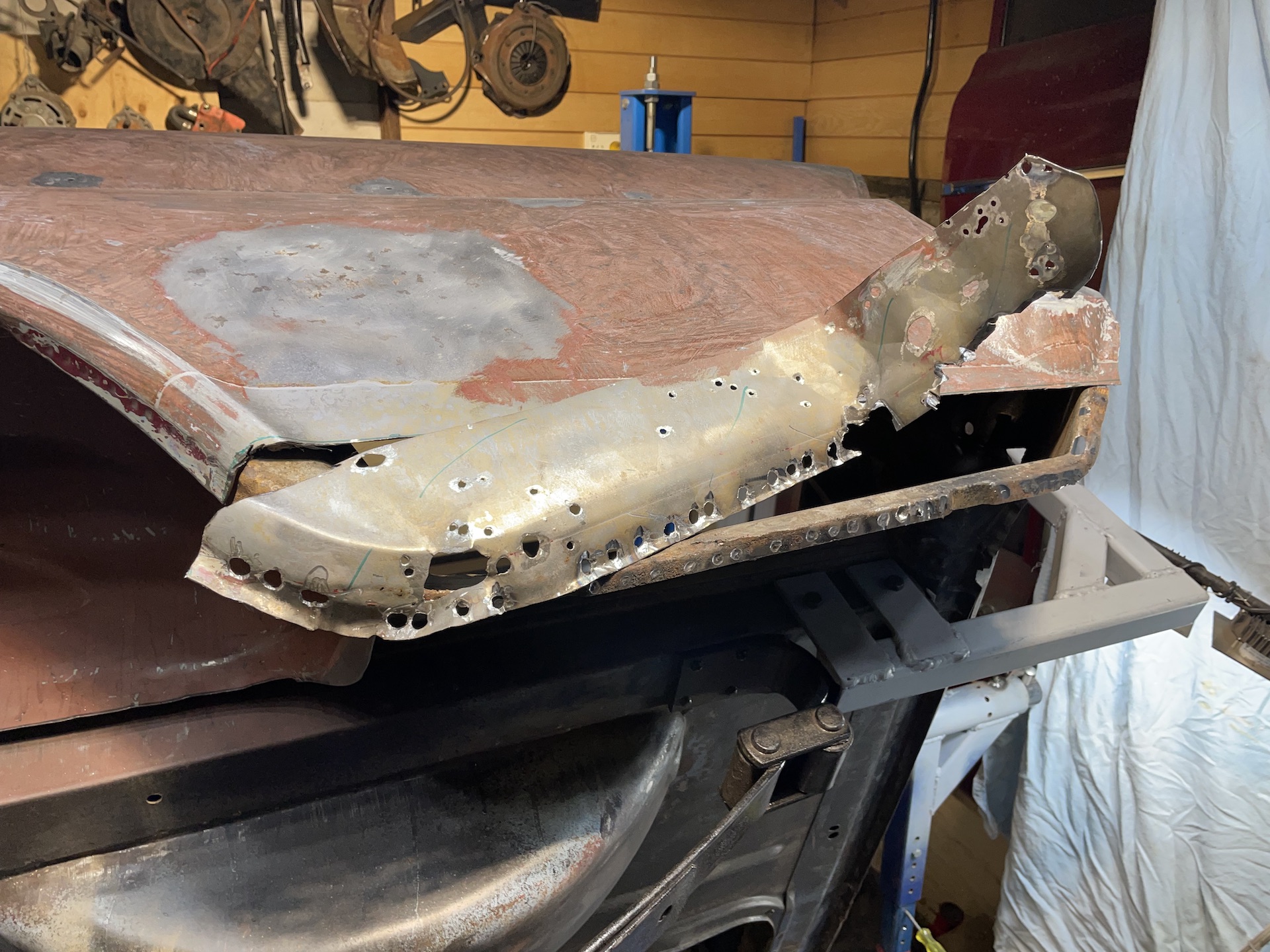

Time to crack this open. My though process is to remove as little as possible for now, and keep as much in place to help guide the replacement metal. So first remove outer skin.
This is a bit janky above the rusty hole in the wheel arch so starting here
Cut out the offending piece and get the crafty paper into action again. Trace around the shape.
Test fit
Trace onto a piece of leftover floor pan, cut, fold, stretch, shape on my sand bag, fit, refit, bend with fingers, make new soft jaws, fit blah blah......
And an hour later
Prepped it ready for welding next shed time
Scott

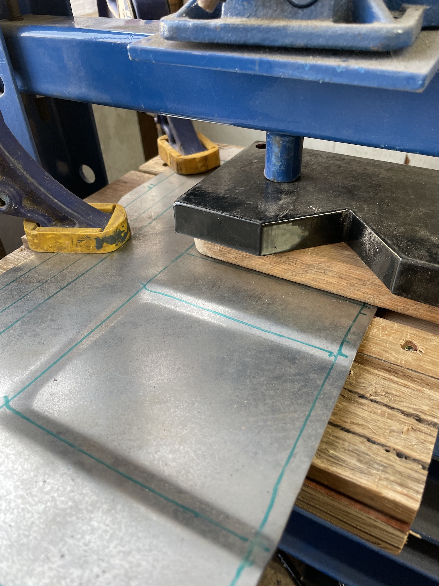

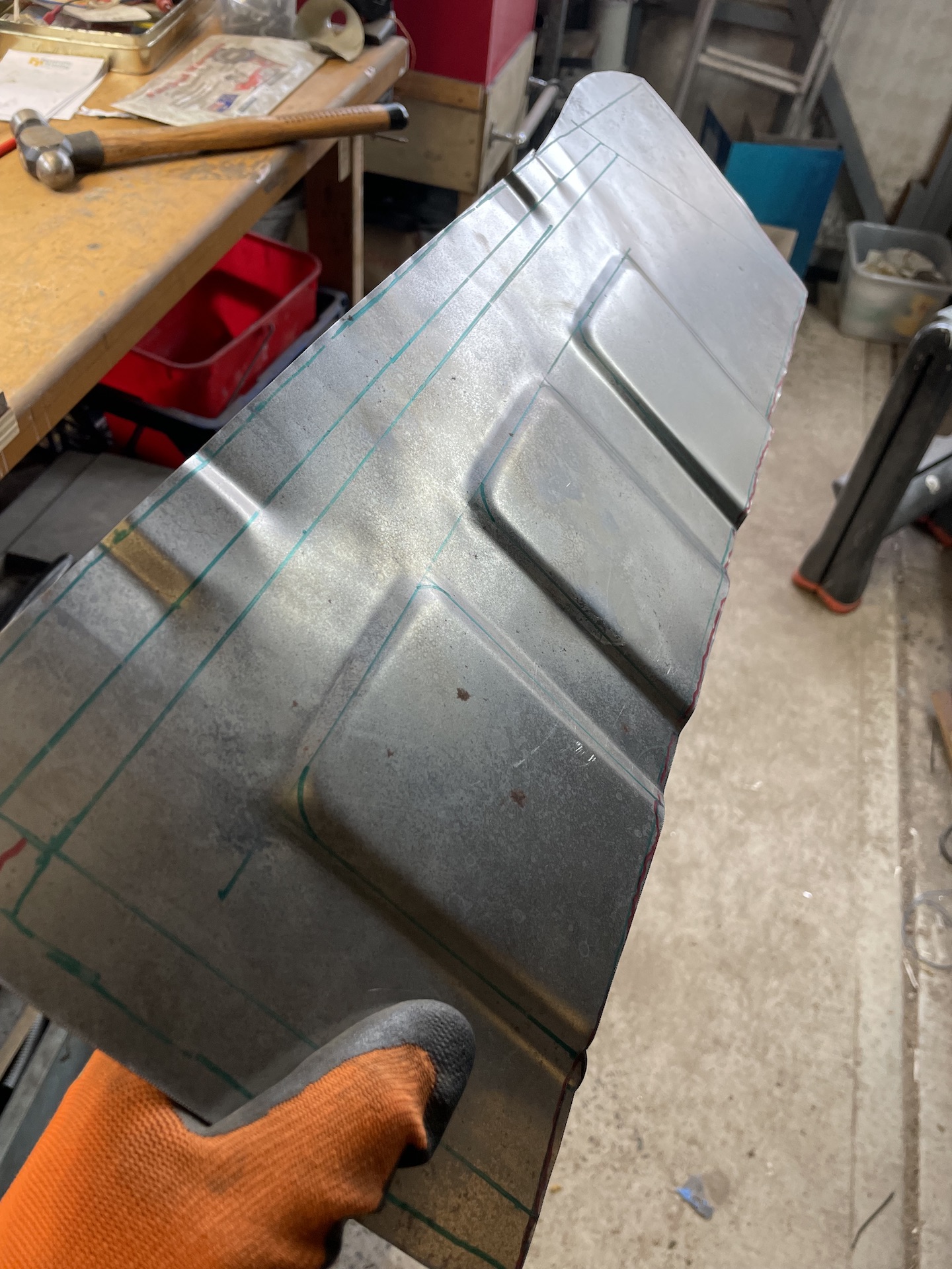

Now on to the passenger inner quarter. There is a guy on FB selling these and against better logic I decided to have a go. Cue orange paper
Discovered that some left over decking at 88mm is pretty close here.
So made up a jig for the press.
Had to modify it so the pressed metal would fit but you get the idea.
Not sure how close these will get to lining up to the original. Just guessing based on the drawings I mapped out on the sheet. But for where it is, don't think it will matter.

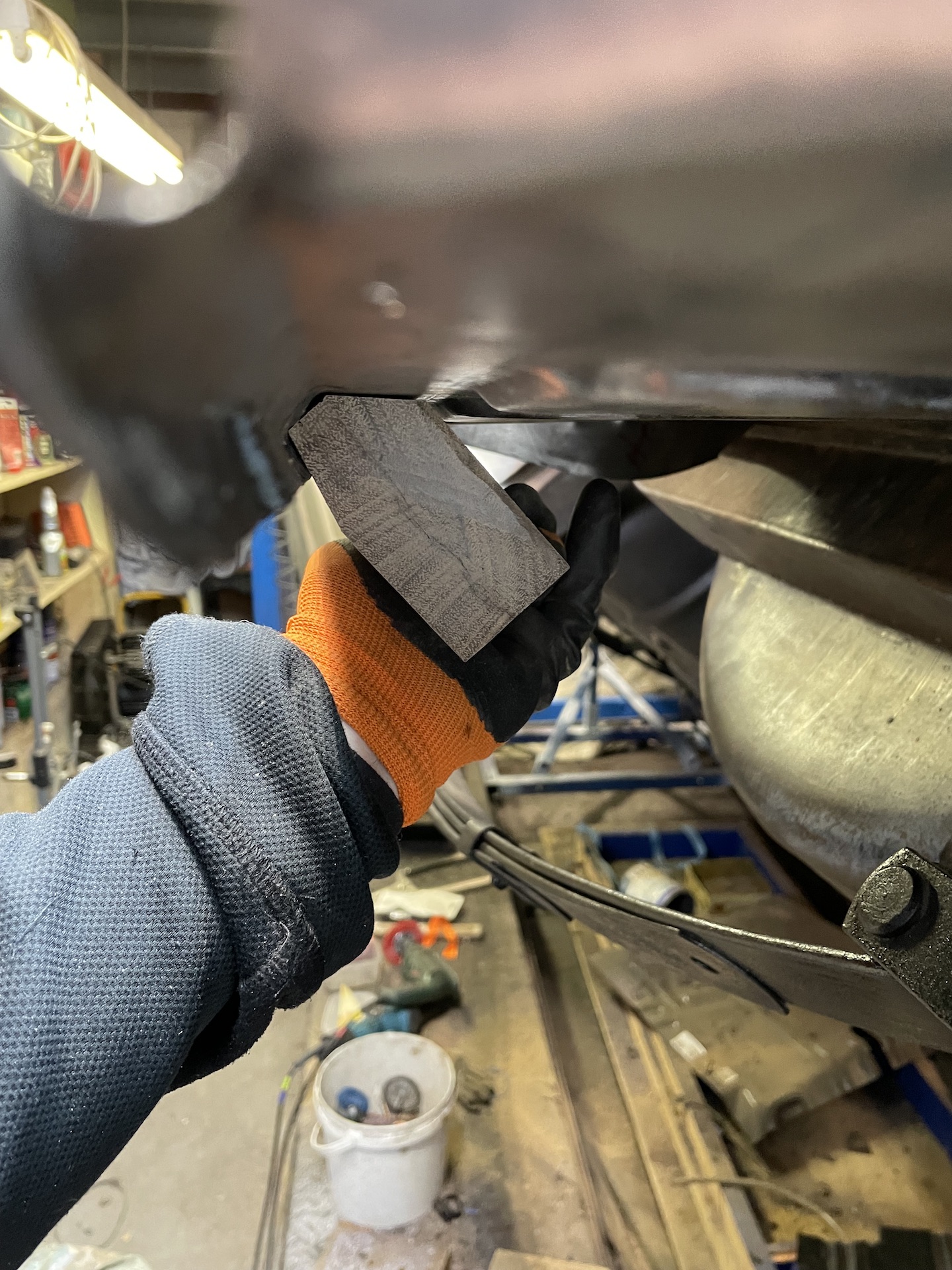

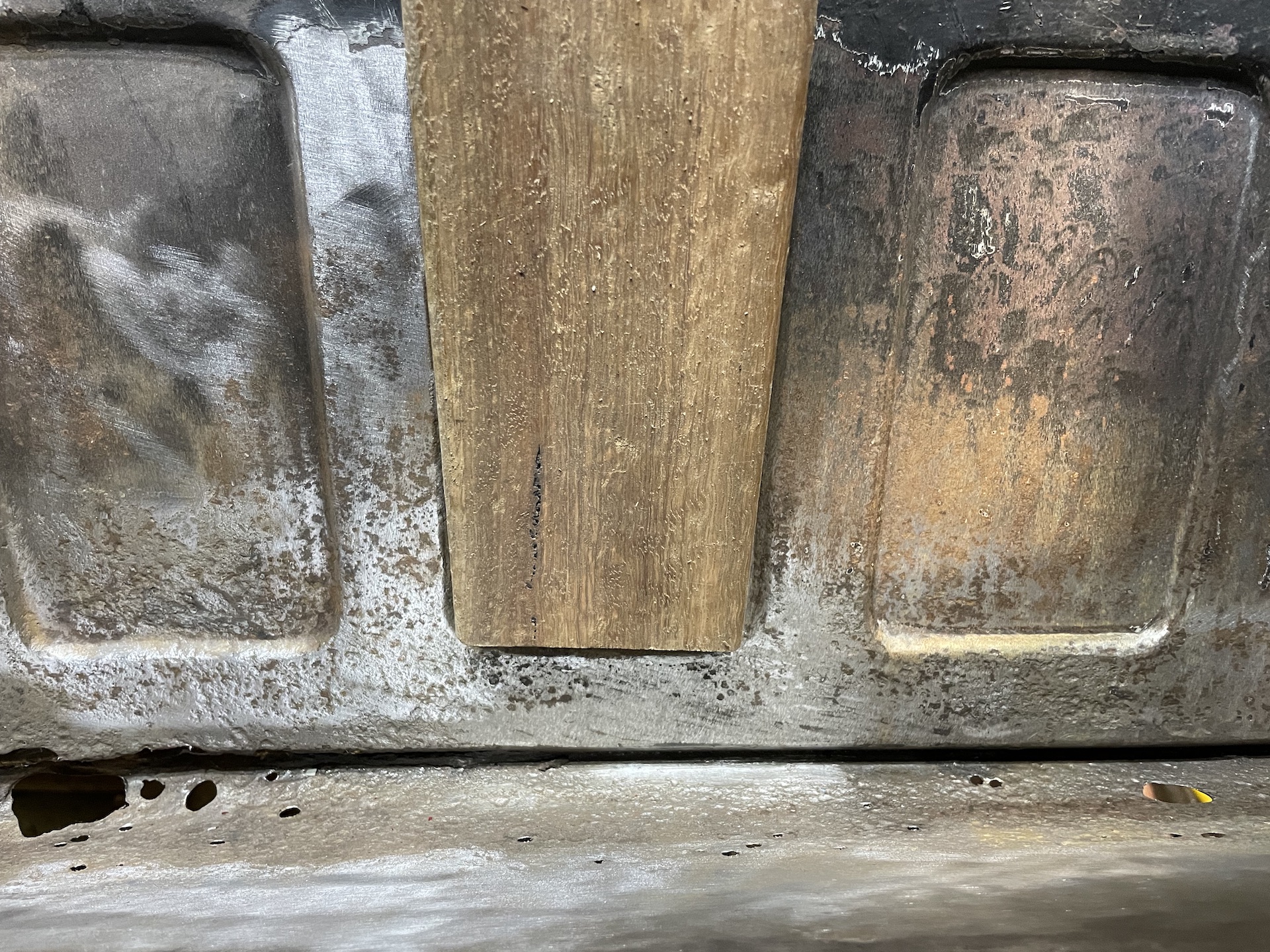

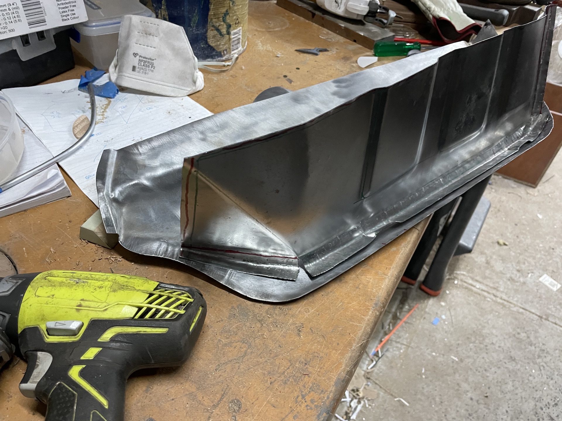

More offcuts to make a jig for the 2 drains that I will fill with deadener and seam sealer so that they are next to useless :)

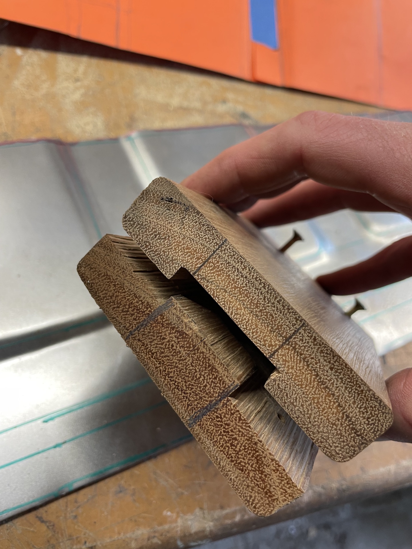

And a couple more bits to make up a guide for forming the double fold that the outer is spot welded to. FYI the angles are 15 and 45 degrees.
Despite attempting to stretch the metal, I was never going to get it as far as I needed so relived it with the cutoff wheel
Lot more bending, twisting and head scratching and I have got it to here.
Spent way too much time trying to get the inner to match what is on the car. Then I had a face palm revelation that there is no point as the outer is new and does not fit the current inner anyway.
Thinking now is to cut out old inner, fit new outer, then fit the inner to suit. Any misalignment and corrections will then be hidden under the car.
Scott
