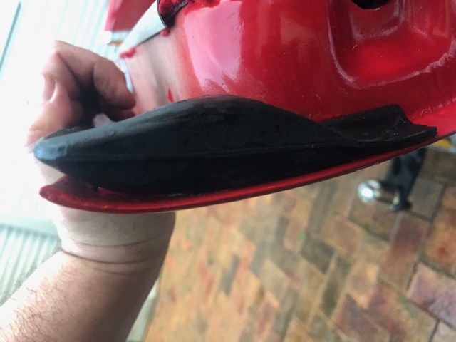

Some investigations yesterday once it stopped raining.

The lower tailgate seal has a thick bulge in this area:
Thicker seal profile.jpg (86.49 KiB) Viewed 4055 times
I wonder if the original lower tailgate seals had no "bulge", and that GMH later modified them to include the bulge and hence not need upper extensions?
In any case, the bulge doesn't work too well... testing with a water can shows it is the bulge area that is leaking on mine. The bulge is thick, hard rubber, whilst the opening rubber that it seals against is soft foamy rubber. The soft foamy rubber gets mooshed around pretty badly.
Hoping someone will chime in with how the solved the problem, otherwise will start playing with making up some extensions.
