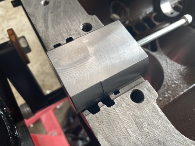

RMS install tool made…

Curious as to what this tool does ?
FbSTDwagon
Posts: 790
Re: FB Standard Wagon
Post by FbSTDwagon »
sgo wrote: Wed May 11, 2022 5:49 pm Curious as to what this tool does ?
It’s a dolly to shape the RMS (rear main seal)
It’s machine .006 on the diameter smaller than the RMS journal in the crank so when I press the RMS into position with the dolly it won’t go too deep.

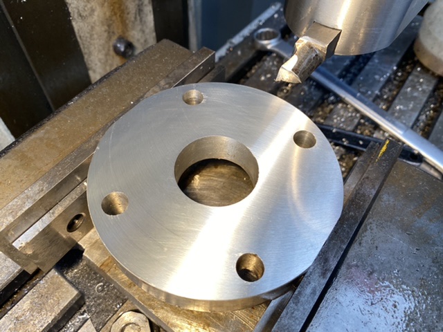

Custom fly cutter made for the machine job required on the piston tops.
Very happy with the surface finish and mill is accurately cutting to .001”.
So it full steam ahead, now to make to fixture to hold the pistons tight on the mill bed when they are getting decked.

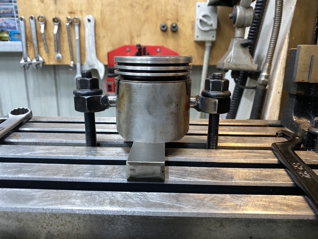

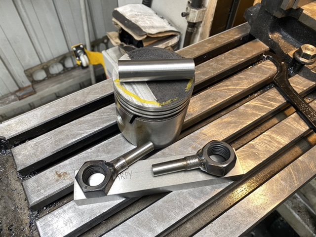

Made up the piston holding fixture, basic so it can’t go wrong.
Polished .003 off an old gudgeon pin to use for the main locator, made 2 pins that fit inside the gudgeon to clamp it down.
Works well and clamps tight without any damage.
Will clock up the piston on the axis of the clamps to ensure it’s sitting true then simply deck them to the individual heights required.

Drew, I’m not too familiar with milling machines so forgive the question. How do you true I up so you’re taking an even amount off across the piston? The amounts you’re talking are minuscule. And how do you take off, say 3 thou? Do you just dial it up?
Cheers; Andrew
FbSTDwagon
Posts: 790
Fex wrote: Thu May 12, 2022 6:02 pm Drew, I’m not too familiar with milling machines so forgive the question. How do you true I up so you’re taking an even amount off across the piston? The amounts you’re talking are minuscule. And how do you take off, say 3 thou? Do you just dial it up?
Cheers; Andrew
Gday Fex, thanks for the question.
My machine had a digital read out which is pretty accurate.
Cross checking that with other measuring tools like a micrometer or dial indicator gives me the confidence to trust the read out.
During the day today making the fly cutter and the piston fixture I cross checked the digital read out and she is pretty accurate for this particular job.
The piston is clamped onto a parallel so that axis has a fixed height, the opposite axis which is held fast by the clamps is a variable so essentially the piston could be crooked.
That’s where I use I dial indicator to ensure that axis is flat to .000’
Then I simply touch the cutter on top of the piston and remove the material required for that piston to match it up with the other cylinders.
I’ll post a few other photos as I start to hit the individual pistons.

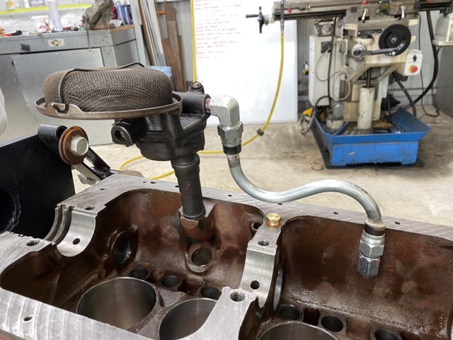

Got home today and found myself at the point where I’m ready to start building the donk.
Gave it a kero clean and a hose off then a dry off with 100psi inside and out. Cylinder and lifter bores oiled up.
Fitted the welsh plugs and grub screws etc.
Had to machine a custom plug for the front oil gallery as that size welsh plug is unobtainable, well I can get them but they are too small and float around in the hole so I just made one to suit.
Fitted the oil elbow in the block for the full flow oil filter.
Oil pump and pipe needed to be dummied up to ensure alignment of the whole unit.
Next up is the crank and rear main seal.
