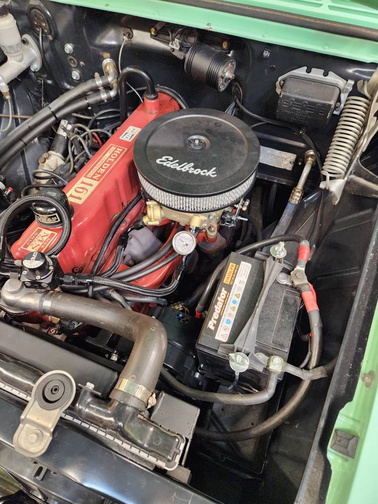

Since fitting the air con and now with the sniper running the motor cleaner (leaner sounds bad),i think that's to do with less fuel for cooling? it's been getting hot if I'm stationary for a full set of traffic lights?
The cars never had a shroud but I think it needs one.
I have minimal room between the oem fan and the radiator but have made a bit of a template. The fan doesn't sit in the center if the radiator.
I'm after information on how much spacing a mechanical fan needs around it for motor movement and how deep for pulling air.
I have the std 4 blade fan 15.5" × 1.5" deep blade and also a later Holden ? 6 blade 14.5" x 1 3/4" deep
But unsure what to use
Would anyone know who can build a ally shroud in Perth. ?
I do have a thermo set up but that will also need relocation and ally welding,modding as the one of the thermos hit the water pump pulley and alternator pulley, plus I'm at the limit of the little battery under the bonnet and two more thermos would mean a rear boot battery install. Picture shows how they would have to sit.
Thanks all.

Posts: 5753
Re: WA fb special
To find out how much clearance you need, cable tie some cardboard (from free Bunnings boxes) in front of the fan, and either side, hard mount to the body. Go for a “spirited” drive - acceleration, brake, some curves. Move the cardboard closer. Repeat until it hits. Then add 5mm clearance to that.
Posts: 11687
Re: WA fb special
Leaner mixture does run hotter
Posts: 14315
Re: WA fb special
You want the blade halfway into the shroud, try not to make it flat with a lip like the CAD template, you want to angle it to maximise airflow. If you can make the bits out of ally and have them ready to weld I will talk nicely to some mates and see if I can get it tigged up for a carton 👍

After calling 6 sheet metal shops with no luck the 7th said not a problem they did a shroud last week. So I have dropped the radiator and fan off with a heap of measurements and they are making up an ally one for me. As advised it will be bowed as such or shaped toward mid fan avoiding the flat sheet and ring idea I had.
Will see how it turns out next week and hopefully solves the little heat issue.

Little few updates over the very high 30s this summer with the ac on since having the fan shroud it's solved the traffic light overheating issues and it still lets in enough airflow on the freeway to keep cool.

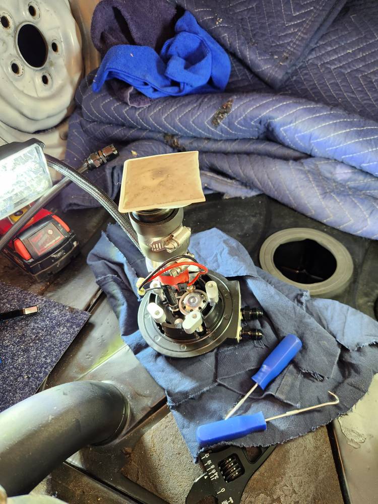

Fuel hammer as the sniper with Dead head fuel system, I used the sniper return less pump, but the smallest pump, I think, is 340lph, which i think is too big in conjunction with the 2 barrel sniper running dead head. The fuel pressure regs couldn't keep up. I made the system return less, and it fuel pressure now sits much smoother on 60psi. But also found tiny bits of sworfe on the pump pressure reg filter from manufacturing, which could also have given initial fuel hammer issues, and found I had installed the pump pick up sit hard on the bottom of the tank so I raised it off the bottom of the tank which also cut the pump noise in half so its nice and quiet now. so not 100% on which fix fixed the issue.
Another good option and maybe more smaller pump size options would be like blackys tank set up using a dead head ve or return vy commy pump setup as they have a swirl pot built in. But I haven't had and fuel starvation hill issues.
