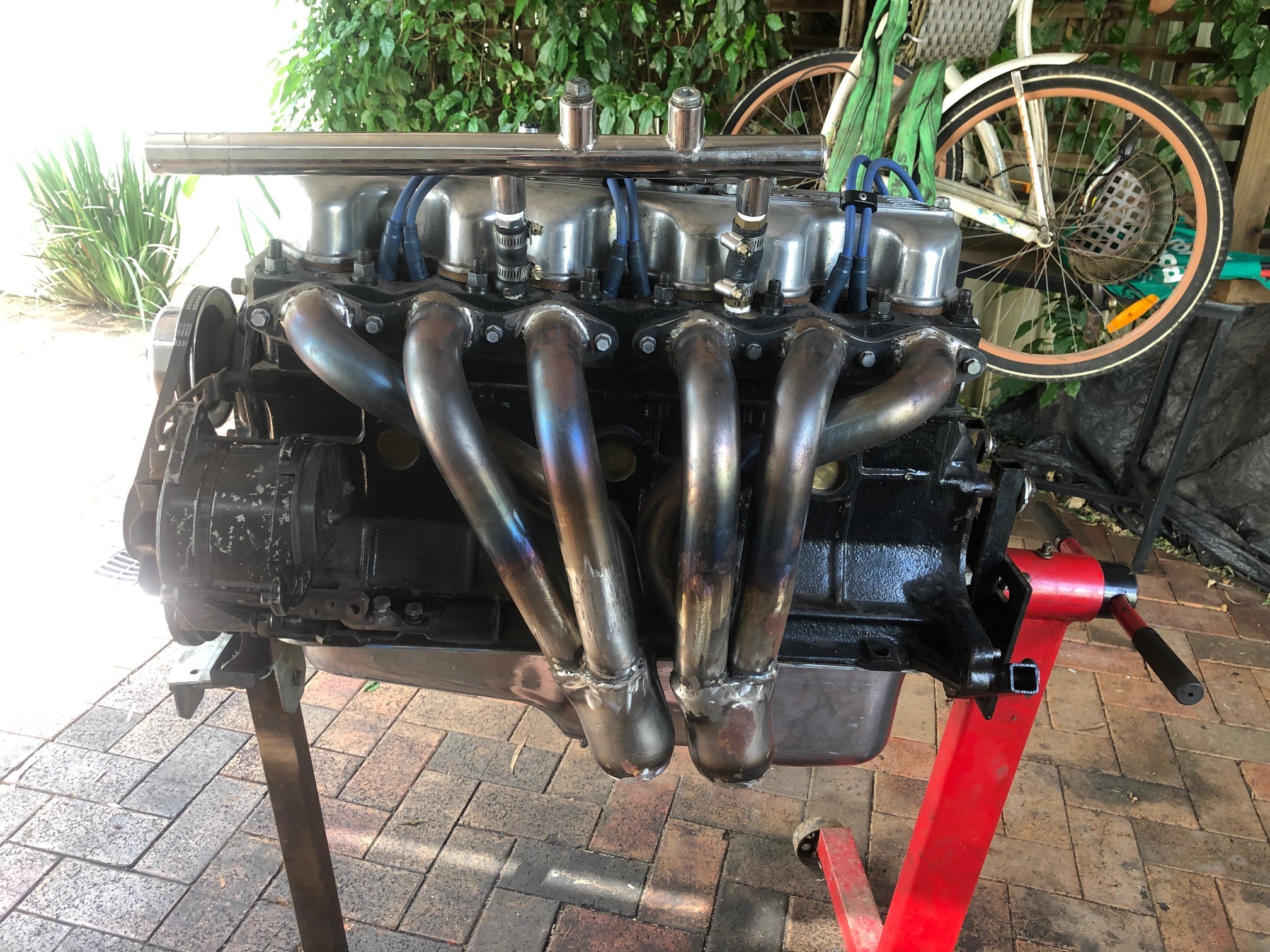

Subi zorst pornImage

Errol62 wrote: Thu Apr 28, 2022 2:40 pm Subi zorst pornImage
Not doing it for me ........... :eh:

Blacky wrote: Thu Apr 28, 2022 4:42 pmNot doing it for me ........... :eh:

If I wrote Subaru on the side of them, would it help? :mrgreen:

Subaru have not, nor will they ever, build something as coooool as that 8) 8) 8) 8) :loveee: :loveee:
