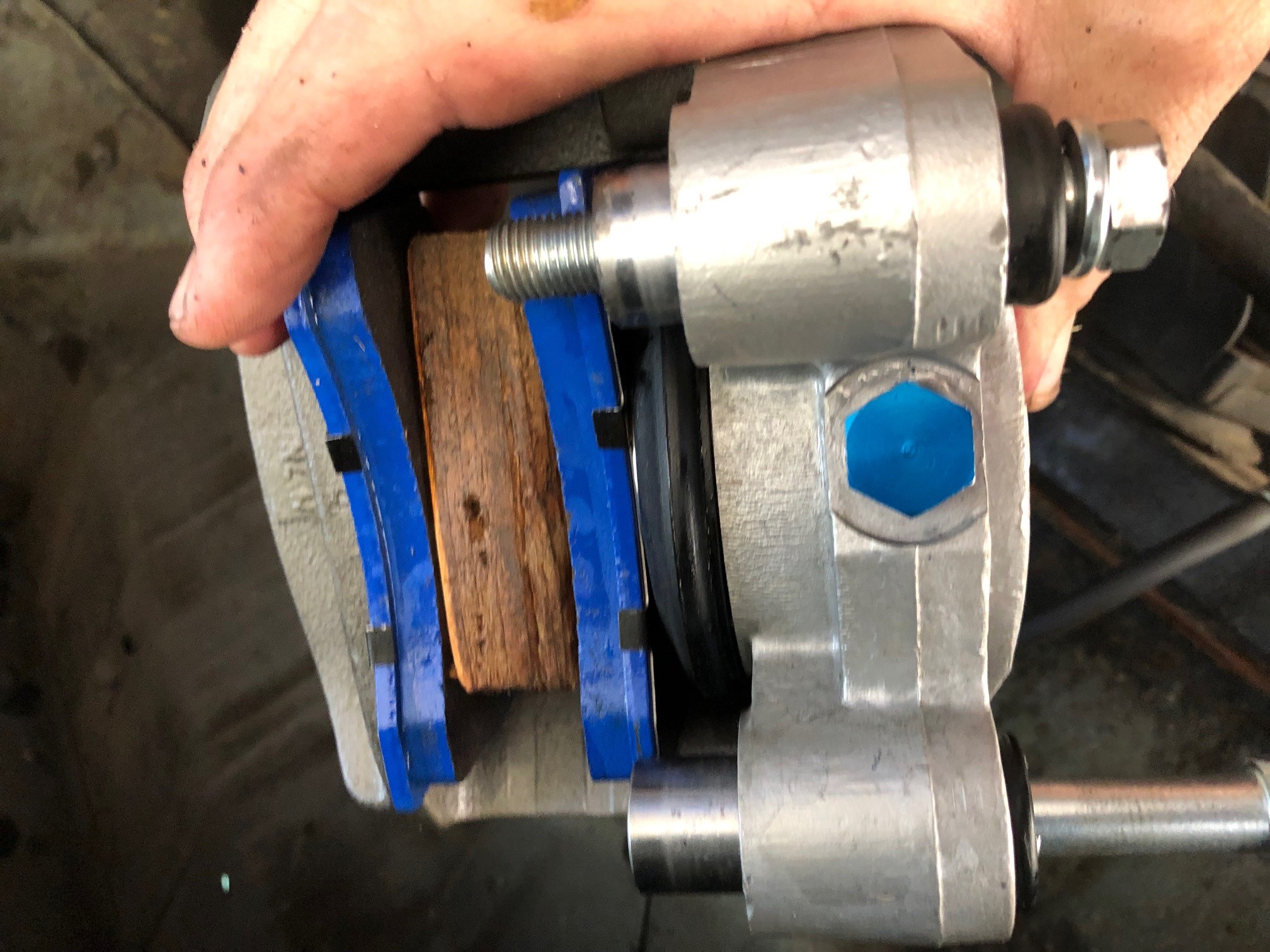

Closed the bleeds, and waited a fortnight for more assistance. Got everything bled yesterday. Rears are easy enough, but fronts have the bleed screw lower than the hoses. Take some of the tension off the bleed screws whilst they are still bolted up (more on this later).
Make up a wooden block the same width as the rotor. Unbolt caliper, and as you wiggle the caliper off the rotor, wiggle the block between the pads.
Turn the caliper up so that the bleed is highest, and hold it under the guard so the caliper is higher than the hose. Caliper in one hand, spanner in the other does not give much leverage - this is why the bleed screws need to be nipped up, but not tight-tight.
Bleed them, leaving the bleed screws as tight as you can. Slide the caliper back onto the rotor, pushing out the wooden block. Bolt up the caliper, and tighten the bleed screws properly.
