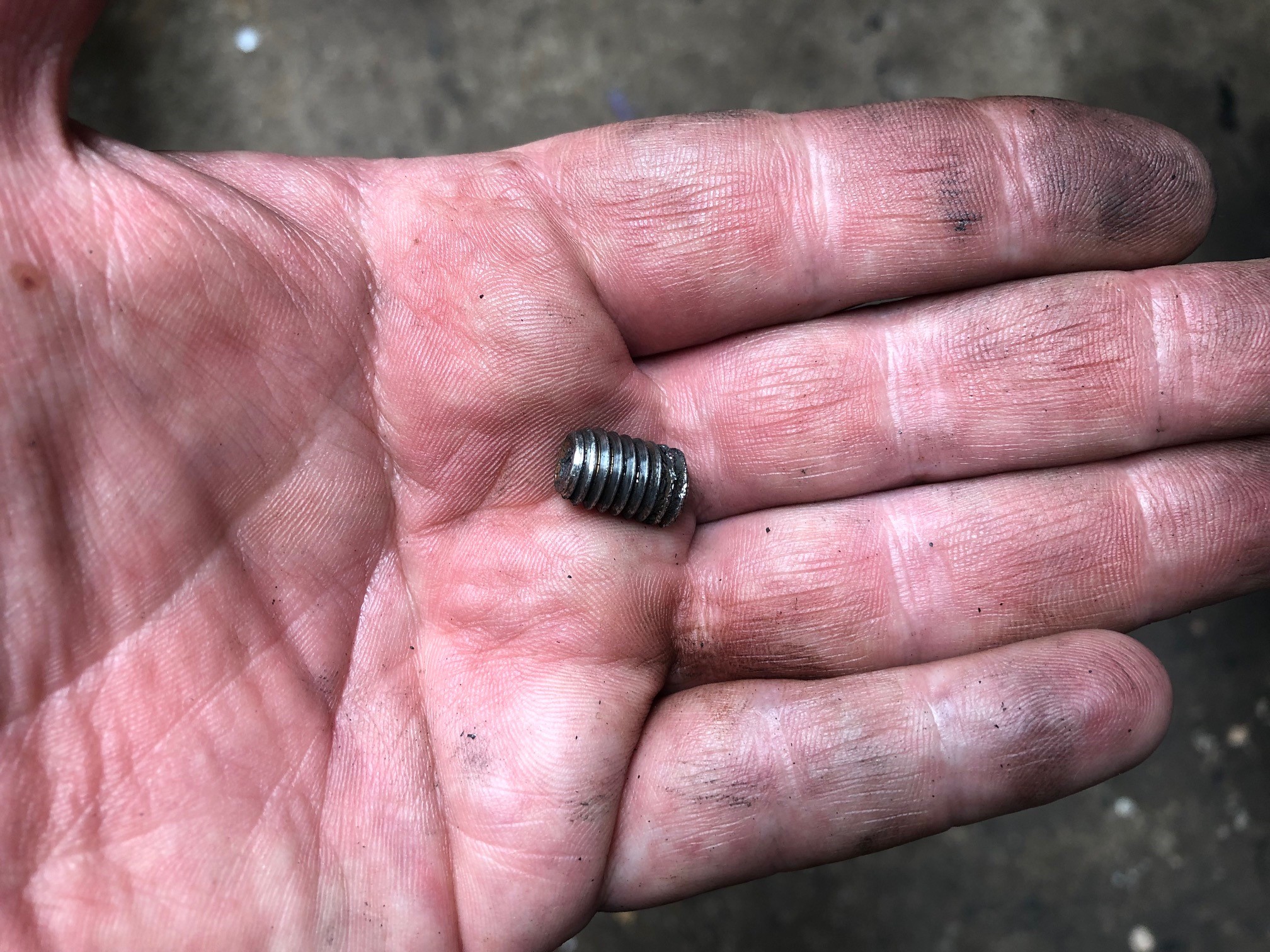

Removed my Macguiver alternator repair, and unbolted the alternator. As suspected, I had snapped off the lower mounting bolt in the block. I had visions of having to try to drill the thing out, after removing the radiator. For once, I was lucky... it had snapped off leaving 2-3mm protruding from the block. Said a few thanks to the man upstairs, got the little vicegrips out and removed the bolt end.
broken bolt.jpg (760.12 KiB) Viewed 2987 times
I had ordered a standard SBC alternator mounting kit, and it arrived in the post. Dummied it up, and now remember why I made my own. The standard alternator mount moves the alternator about 2-3" outboard of the mounting bolts. When I swing the chubby 140A alternator, it hits the subframe.
Will have a rethink over the weekend. Perhaps modify the standard brackets, or worse comes to worse put my homemade brackets back on and upgrade the bolts from Grade 5 to Grade 8 (50% higher shear strength).
