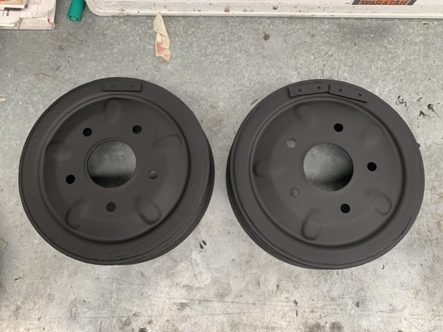

Was painting the old drums today and seen they had balancing weights on them.
I guess this is another small piece to the puzzle?

Re: High speed vibration
Hey Blackdog how did you chasing the vibration?
Just in the topic of the brake drums with balance weights in them…
Been doing some research and apparently on the older cars a lot of the rear drums for balanced in the factory, I’m unsure how true this is…
I have 4 original drums and 2 have been balanced so I’m guessing the balanced drums were off the rear of the car.
Maybe check your drums and see if the rear ones have balance weights, off not see if you can dig some drums up that have the weights.
I have no idea if this will work but it certainly has got me thinking about why the balance weights are on the drums…
I originally would not have thought it would have been an issue but it’s worth a check.
