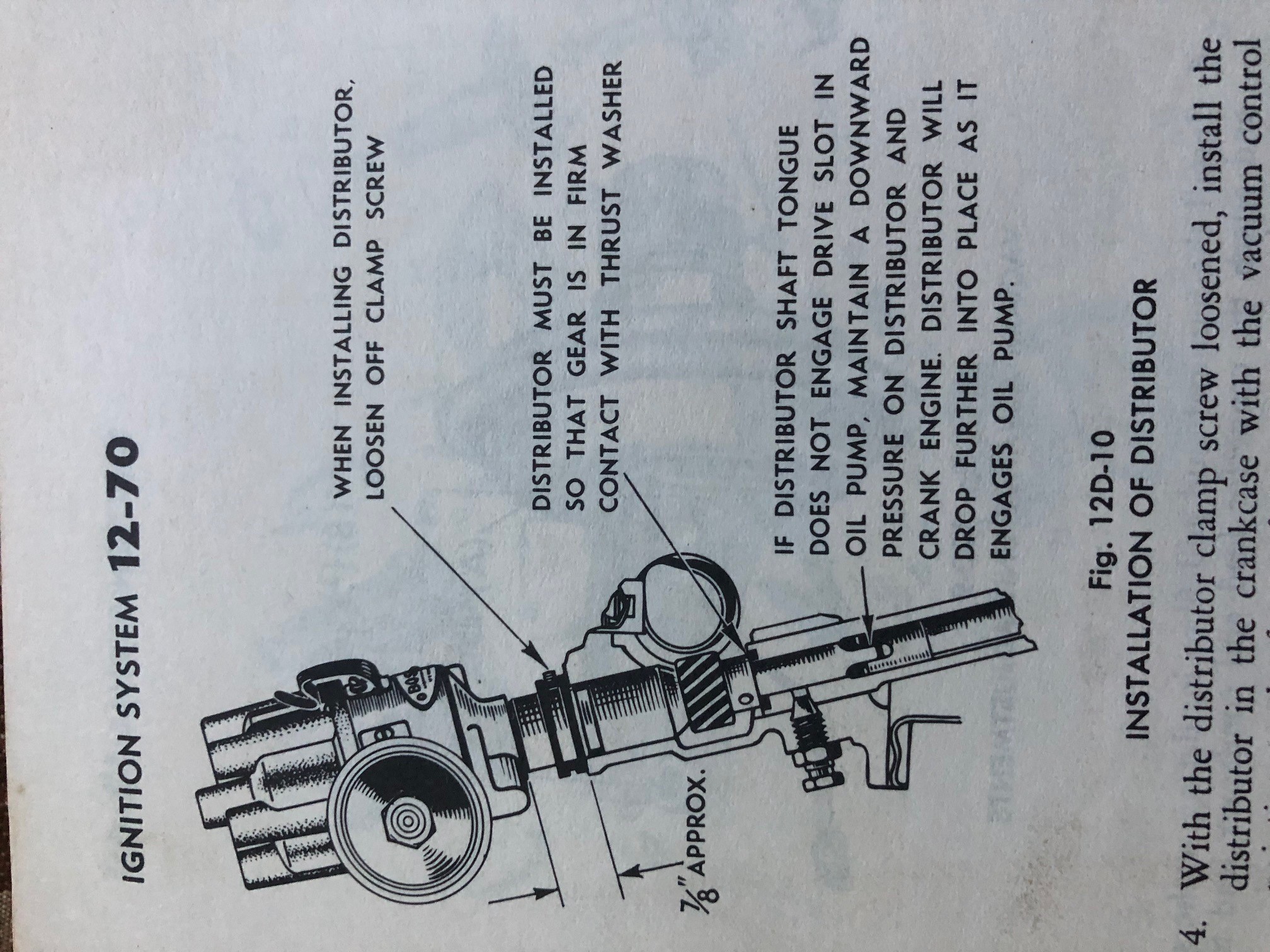

Poking around getting jobs done in engine bay. Can someone give me an idea how far down the distributor sits when it is engaged with oil pump? I pulled it out to adjust timing and am now not sure if it's fully in. O ring is level with block. Thanks😀
Posts: 14242
Re: Wilma FB project
needs to go further in ......
Posts: 2519
How much further (what a strange word) in?
Posts: 5732
The o-ring goes fully into the block (so you cannot see the groove anymore), then another 4mm further-er. The are normally set up so that the indicator/clamp bottoms out on the block at that point.
Posts: 2519
Many thanks Harv. Perfect.
New O ring isn't helping either. Will have another go tomorrow. Will put clamp at that dimension and take O ring off, set it up, then pull it out and put straight back with O ring.
Posts: 5732
Hard to tell in the photo, but is that a Vintage Racing Developments dizzy? His overhauls are immaculate, but the o-ring is damn tight. ,
The ardiesse method works though: line up the oil pump, grease the o-ring heavily, take the cap off, stand on a milkcrate and lean heavily on the dizzy (whilst trying not to bust the dizzy internals).
Posts: 2519
Yes it is Harv. Well spotted😀
Posts: 11634
Wonder off you could make a mini ring installer setup for these. Hey it's a grey motor. Throw the o-ring and wrap some hessian in the groove.
FB ute driver, EK van project
Posts: 2519
Dizzy in, thanks fellas. Took O ring off, lined drive up then reinstalled with O ring. Worked a treat with a bit of muscle.
