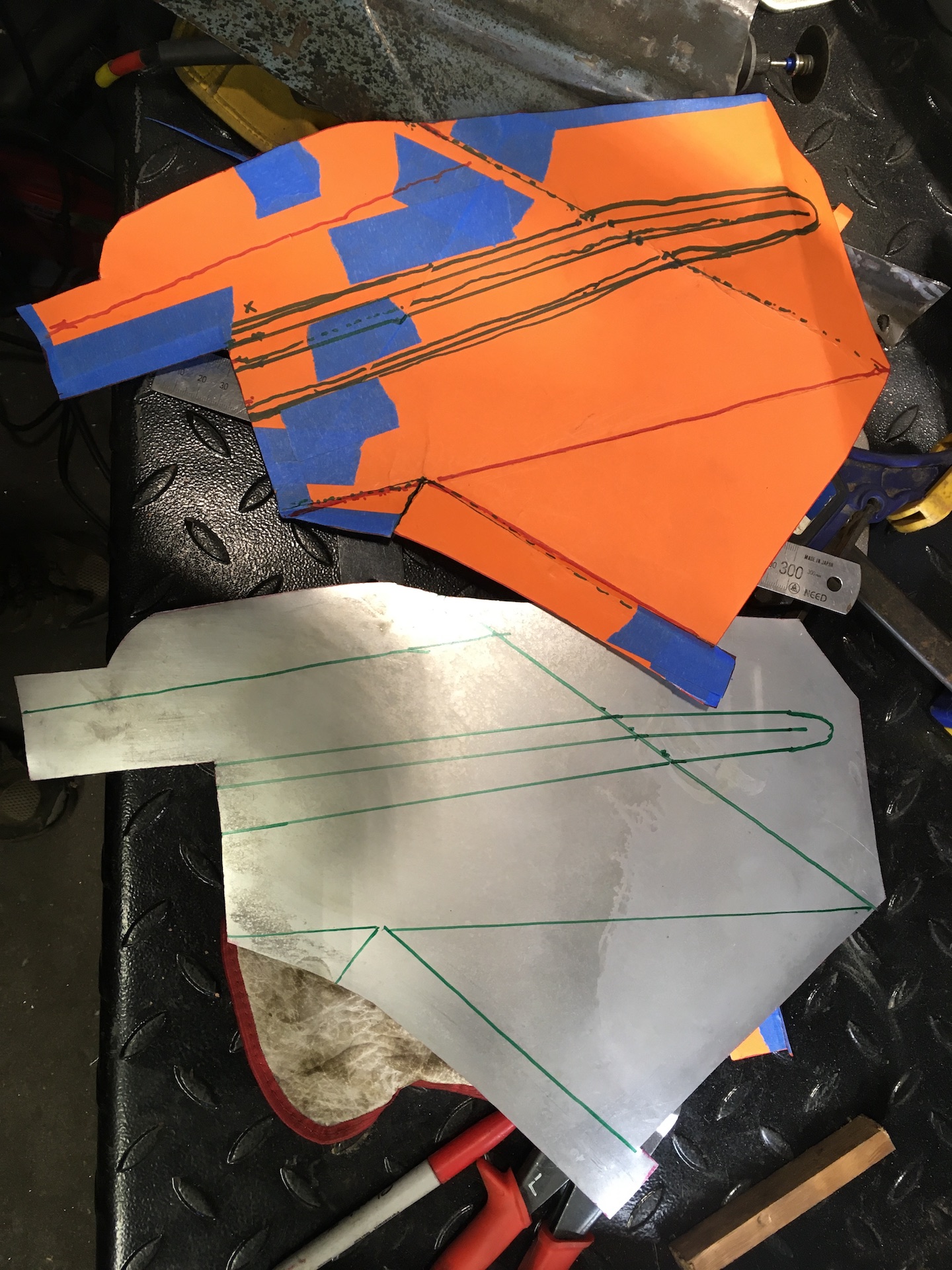

Now onto the top section. There is a subtle curve here which I folded into the card.
Hard to see but I tranferred it onto the metal.
Rolled it over a piece of 6mm rod in the sheet metal vice.
Now you can see the curve which hasn’t translated with my fold.
Out with the cold chisel and hammer - only took 1 pass to get it to bend.
Same problem when viewed from the top.
Same solution
Here’s the finished piece

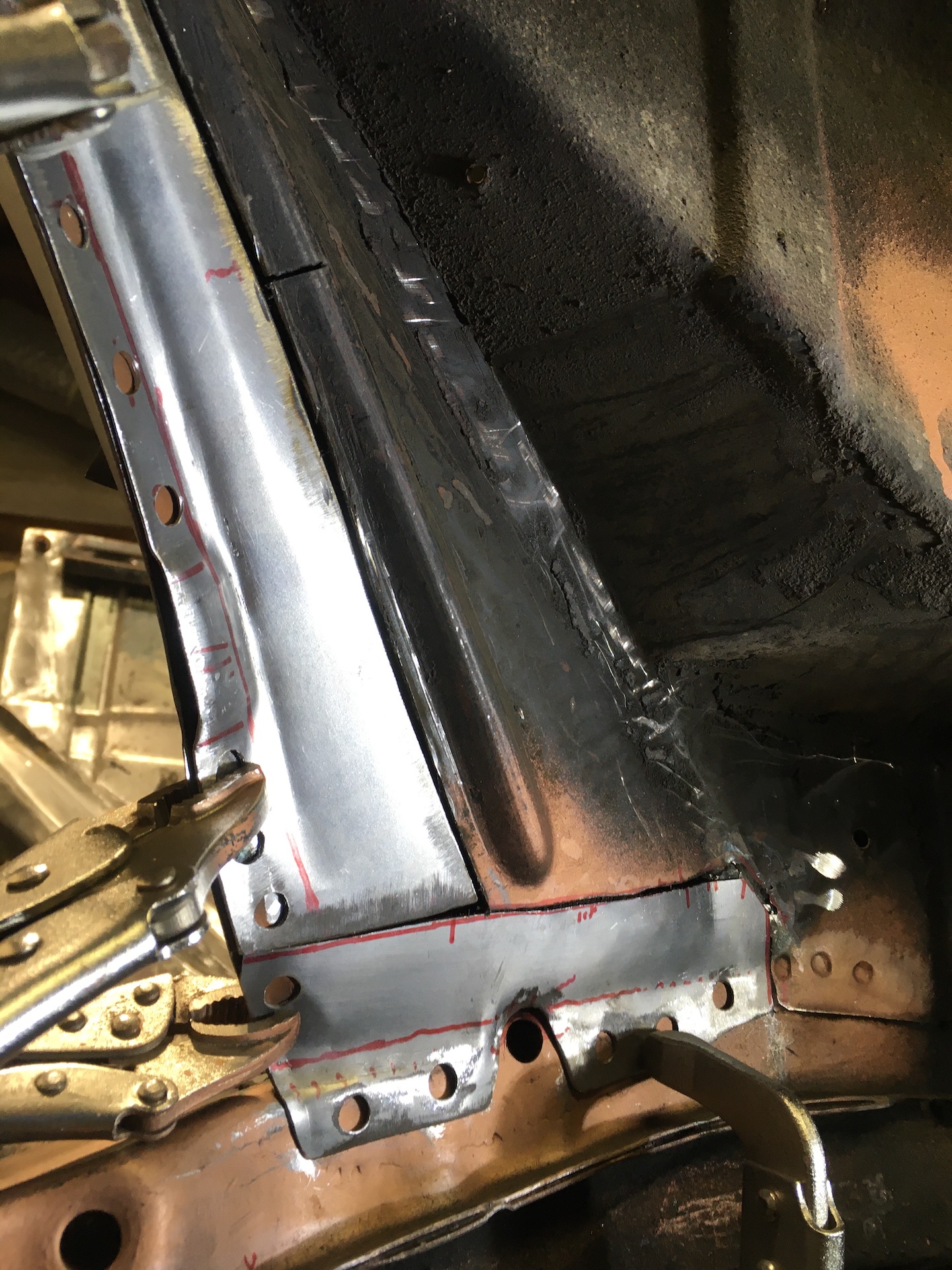

Before I start to close everything up I cleaned off all the surface rust. Stainless cable in the power drill gets into some hard to reach spaces. Sprayed in some Rust Reformer.
Used the new bottom section to mark out with a sharpie and then cut and fitted.
Tacked in and starting to fill in the gaps. Copper bar used to help prevent any blow through, but the metal is pretty thick and only had it happen on the corners I couldn’t get the bar on.
Final welding - captive nut for the handbrake pulley was tacked on to prevent it turning. I flipped the sub-frame over to do the bottom. After tacking it in upside down, I realise that gravity is a welder's friend!
To dress the welds I had to take my jig off. This is how much the upright twisted when released. Outer skin will help keep it in place I hope. Jig will go back on for that job.
After several hours of 40 grit flap disk, 60 grit powerfile, die grinder, and nylon brush, it looks (almost) like a bought one.

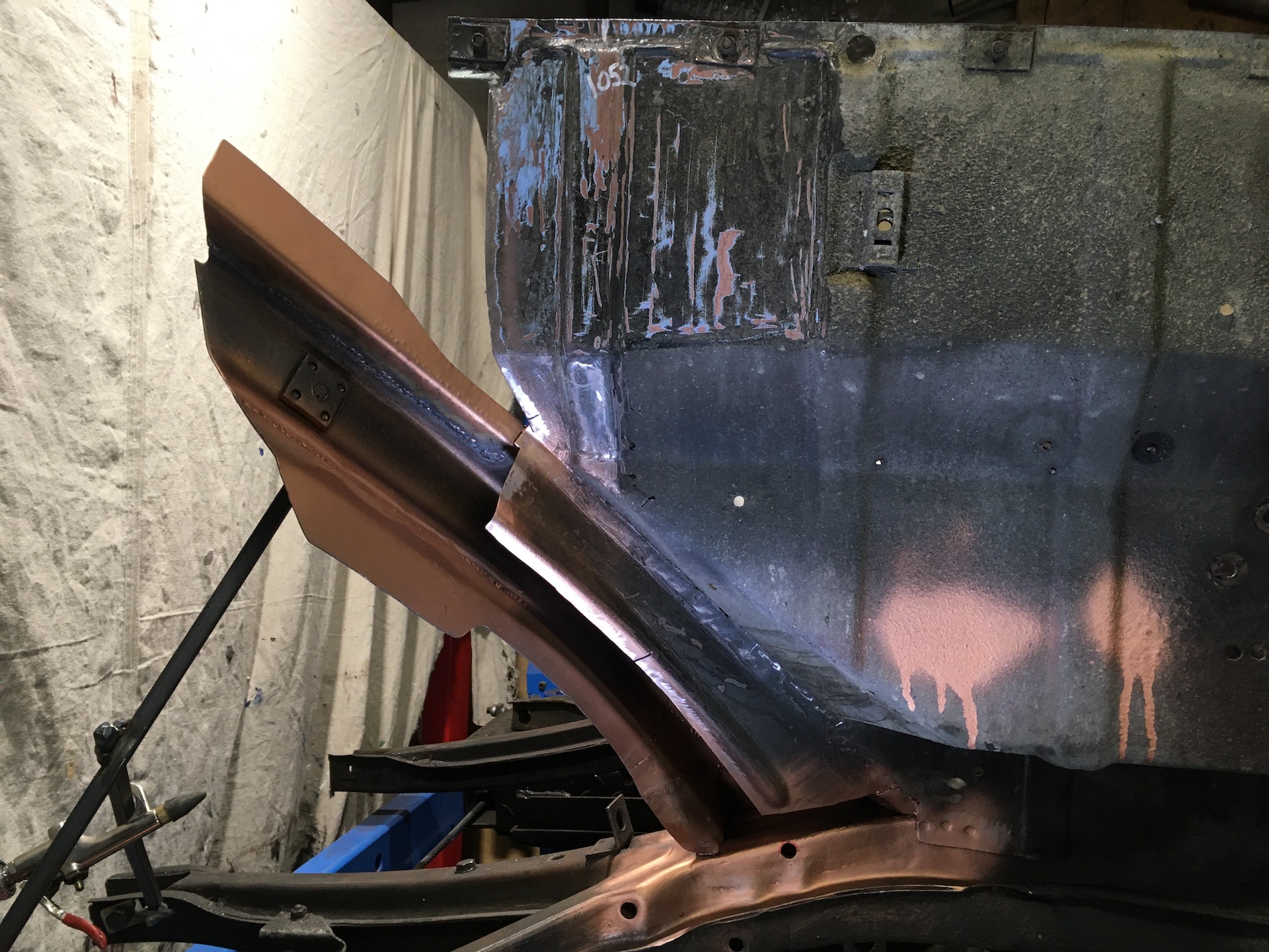

In the end decided to do this in 3 pieces as the paper templates fit nicely on a small sheet of 1mm cold rolled.
And cos I'm a piker!
Traced and cut with the jigsaw, and after bit of work with the hammer/sandbag/press/spanners got this to fit.
For the next small piece I added a drain hole for all the water that will never come down here. Might put one on the other side too.
You’d think as I have done one side that things would go easier second time round for the main wing - Nup. Here it is all marked up. 5 folds and a rib - easy.
So 4 hours later after pressing the rib a second time to get it to line up at the join, and refolding (twice) the main vertical that joins the subframe wall at the top.
Prepped to weld
Before I started cutting out the old metal I measured across the sub frame walls - 1052mm. This may or may not be close to what it should be (should have asked), but its what it was and everything bolted together so using a clamp I spread it to that measurement.
Welding in progress. A few clamps here, but nothing is forced to get the lines right. Lesson learnt from the other side.
Plugged and butt welded. The original metal is pretty thin so had to chase a few blow throughs. Bit of splatter too which was contamination from the easyphos I put on the metal to keep it shiny. Forgot to wire brush it off.
Scott
