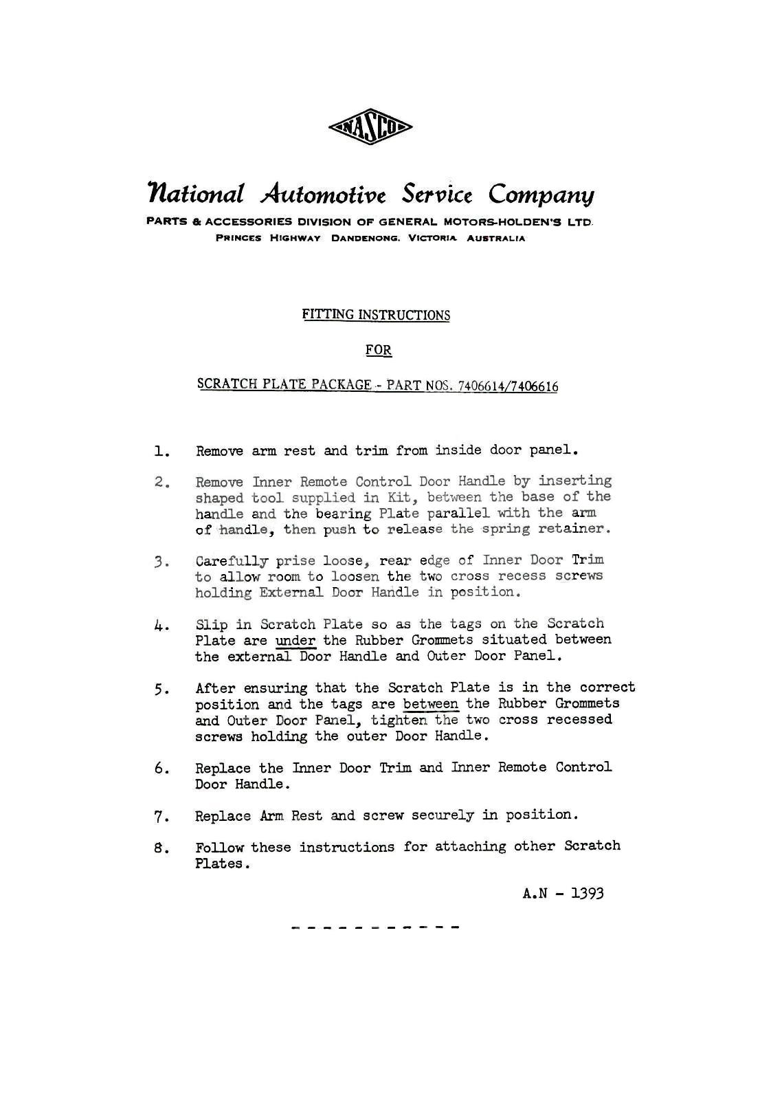

The scratch plates can be a bugger to sit correctly, even when you get the correct ones (RF, RR, LF, LR) in place. The couple of cars I have done have ended up with small gaps at the bottom for some plates. Can't see it from the top, and none of my cars are show ponies so hasn't bothered me too much.
I've only ever put the tabs between gasket and paint. Putting them between gasket and plate would make the plates sit out even more, unless the tabs were bent to a step. All the tabs I've seen are flat (no step).
7406614 and 7406616 Front and Rear Door Paint Protection Plate Package FE through EK Holdens.jpg
7406614 and 7406616 Front and Rear Door Paint Protection Plate Package FE through EK Holdens.jpg (143.64 KiB) Viewed 678 times

Sorted. Thanks Harv, Clay and Greg.

Just a follow up on scratch plates. Sam Crupi scratch plates are shinier and do have a slightly stepped tab so worked best between gasket and handle. EBay sourced ones are duller and the tabs are flat and worked best between paint and gasket. I'll post a photo when I get to door stuff.
