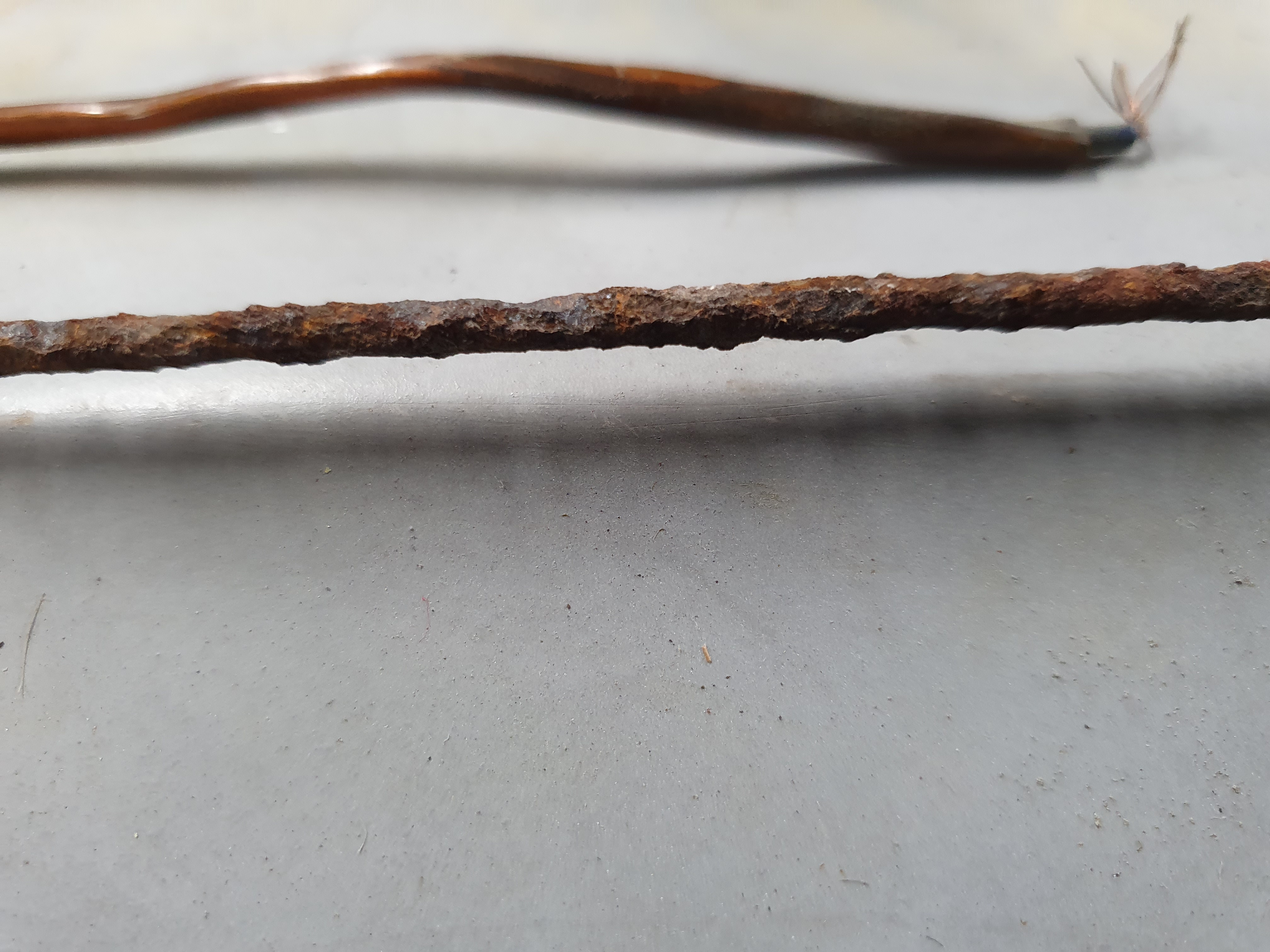

Has anyone made or purchased the remote door lock and button rods? Mine are too rusty to reuse, so failing being able to get a better 2nd hand set, I'm thinking I may have to make some....
Posts: 2519
Re: Wilma FB project
Hi Tim that would be good: all of them are rusty😀. Back doors have a long rod that goes to lock button and a short (I think both back door shorts are same length) that goes to inside door handle. Front doors have a short ( might be a different length to back door shorts) that goes to inside door handle. All mine are rubbish🙄. Clips are all Ok to reuse.
Posts: 2519
No Tim, dont need the threaded rods or pivots that run up to the black buttons. Just the rods in the cloth bags. Thank you
