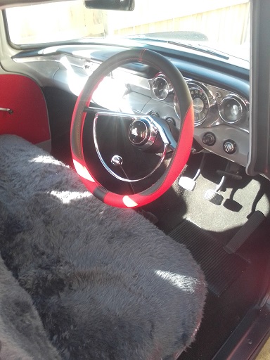

I thought I would break up the greys and blacks inside the ute
so I sealed off all of the holes in the door

and added a steering wheel cover
steering wheel cover 1.jpg (78.18 KiB) Viewed 809 times

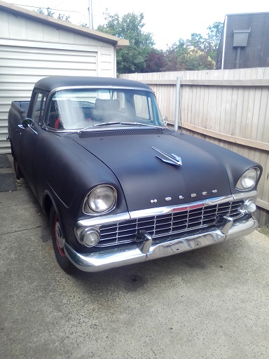

I spent most of the morning sorting spares into tubs - then it got to 34 degrees so I stopped. There's been a cool change this arvo, so I just put the mirrors on - found a spot where the mount follows the body contour and the quarter windows don't hit them

How about a close up?
62ekute

Post by 62ekute »
brrrr - it got cold out there
