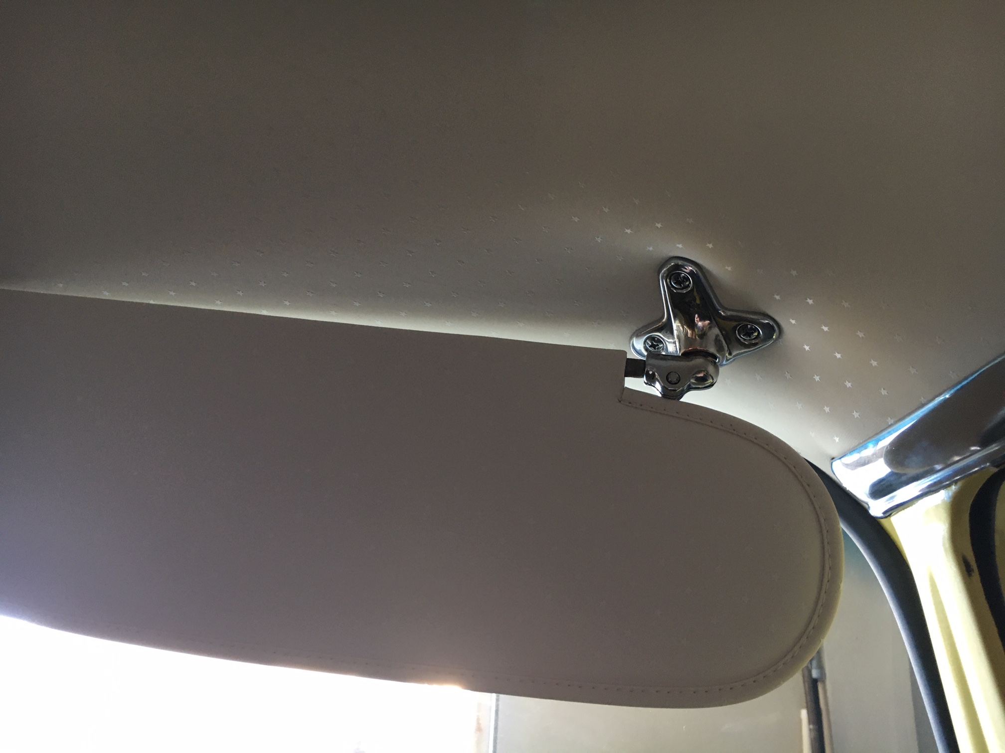

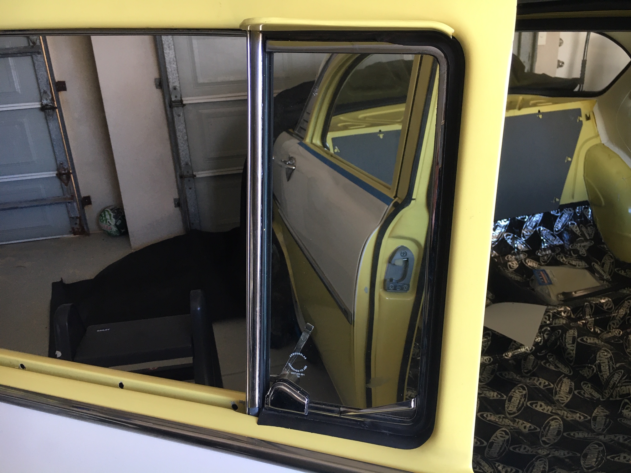

Another update and another step closer. I have had some wins over the past few weeks but sadly have had a loss that I fear could require major surgery i.e.: front and rear glass removed and remove headlining :crying: :crying:
I used nutserts for the bolts that hold the sun visor in place, although I had never used a nutsert tool before it didn't look that difficult so thought I would give it a crack. The nutserts went in not prob's then proceeded to bolt up the sunvisor, I got the roof brackets mounted no worries but could only get one bolt on the "A" pillars either side. So I unbolted the roof brackets (mistake number 1) and bolted up the the "A" pillar bolts first then proceeded to try and bolt up the roof brackets (mistake number 2). This proved my undoing as the extra stress on the bolts has now caused 3 out of the 6 nutserts to start turning as well :crying:
Option 1: Cut bolts and try to drill out the nutserts, then try to refit? Bearing in mind what could potentially drop into the headlining
Option 2: Remove front and rear glass, remove headlining, drill out and replace with welded nuts on the underside of the roof?
Going to have to bring the experts for this I think

Posts: 13645
Re: FB Special project
Step 1 - drill out nutserts , don’t let them get too hot - take your time .
Step 2 - buy some rivnuts from a motorcycle shop or epay
Step 3 - fit rivnuts and sun visor
Step 4 - open another chook and admire your handiwork

Love the simplicity of those 4 steps Blacky, hopefully it is that simple 🤦‍♂️
Option 2 is really not an option, more of an absolute very last resort

Posts: 11127
Tried retensioning the nutserts with the gun? Then run a tap down them. Anything to avoid the headlining out, although you would get away with just the front screen surely.
I had one fail yesterday due to not having it screwed on the awl enough. Drilled out and refitted no problem. You would want a stop on the drill to avoid piercing the headlining.

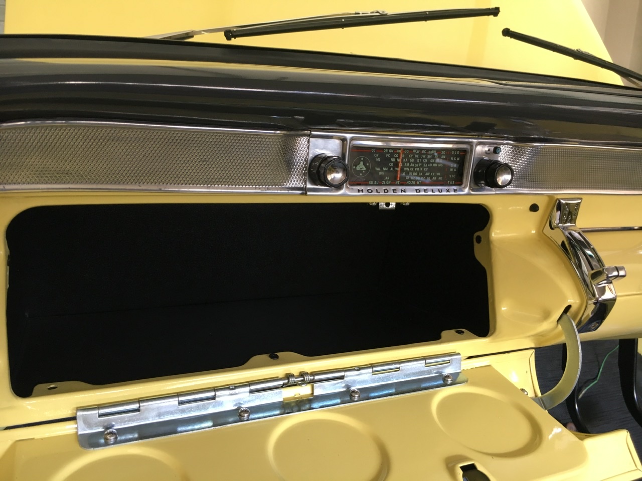

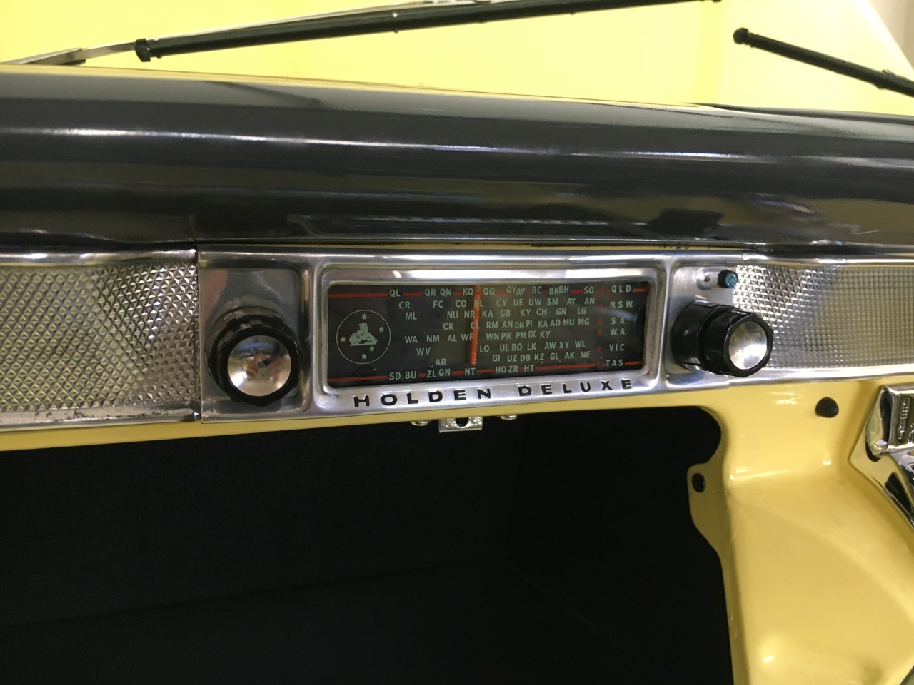

Radio, fascia and glove box fitted 👍🏻
