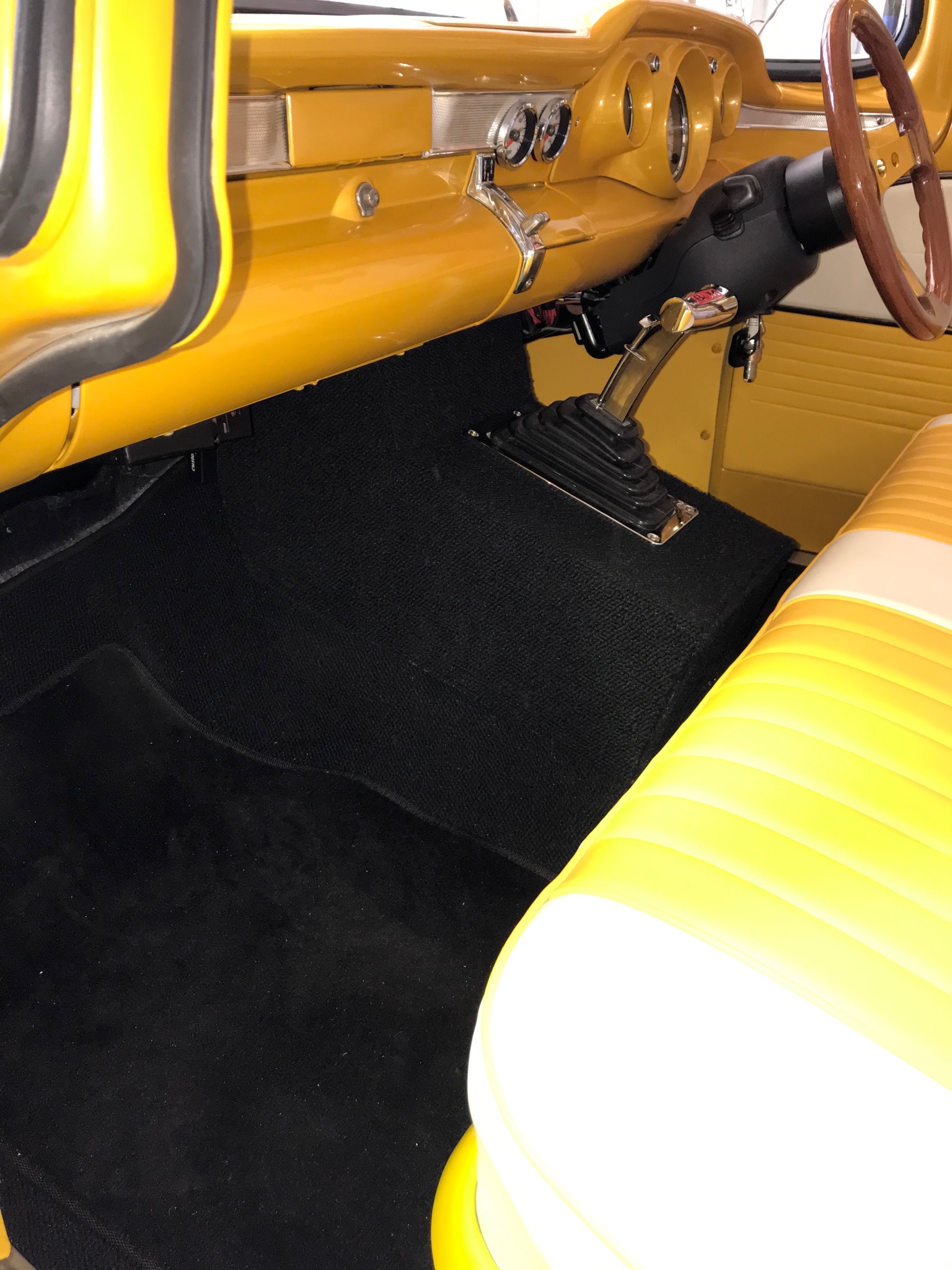

While doing the little things and with my limited skills I came up with a simple console to cover over where my relays and engine fuses are, covered it in black carpet and I think it sort of makes it blend in.

Blends in nicely. Sounding positive. Good luck Neil.

Here’s hoping she is all good now - I like the console , I plan on making a similar one for my ute one of these days .....
