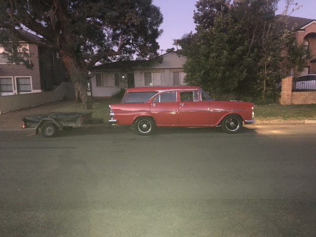

Mick wrote: Sun Jul 05, 2020 12:19 am put your number plate on correctly :shock:
Lol... I have committed an FB/EK sin with that license plate. At least I painted black behind the grille :lol:

Ain’t no show pony :mrgreen:
Picked up the guards to repair Grace’s ute. A good blat at freeway speed had me grinning like a Cheshire Cat.
