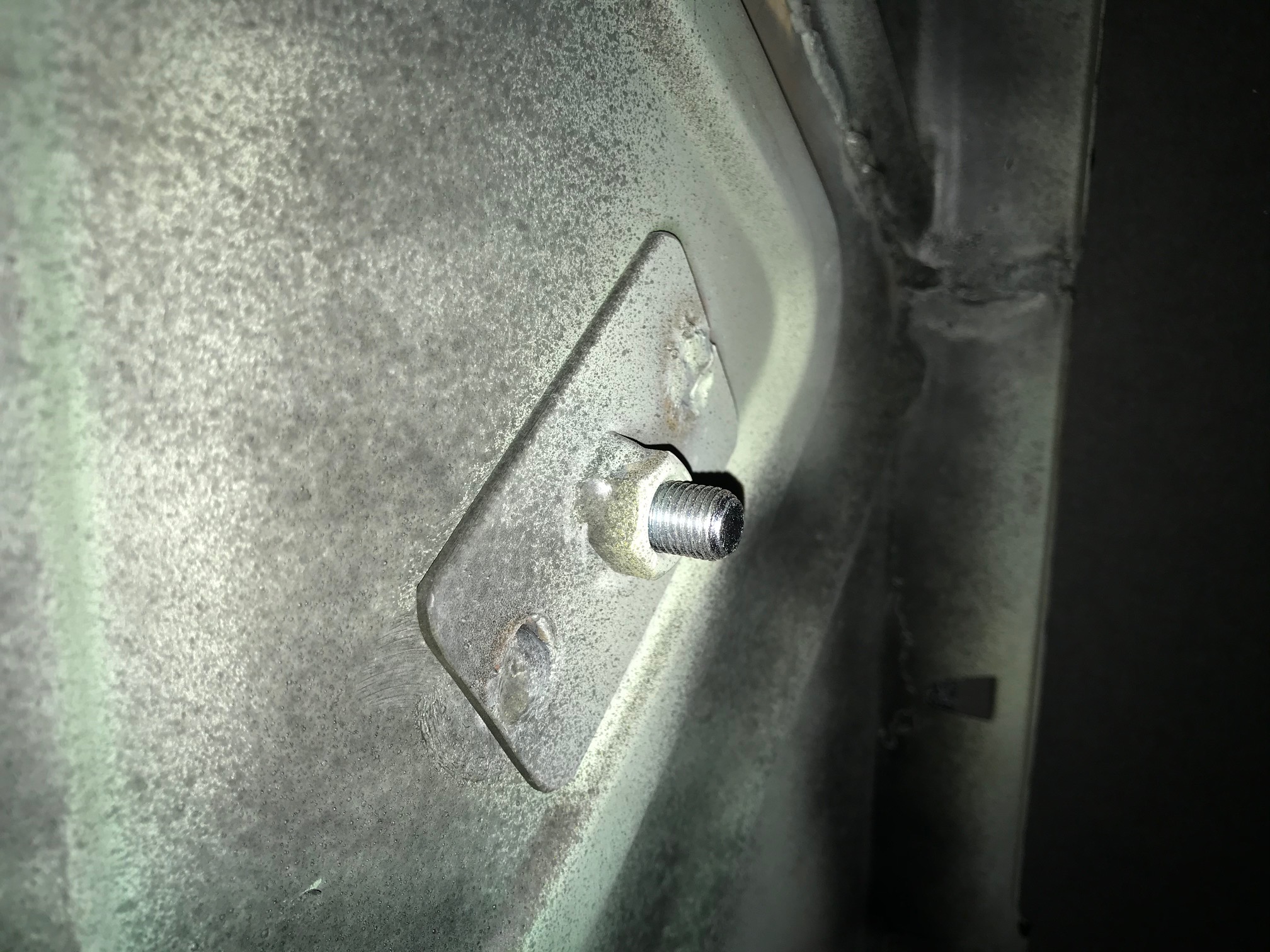

I believe this is the requirement in the West. 50 x 80 and spot welded in, 7/16 UNF Bolts
- Seat Belt Anchors.jpg (656.86 KiB) Viewed 14200 times
