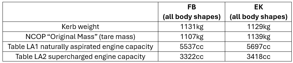

The question then becomes: what does an FB/EK weigh? From NCOP Section 2.13.1 Vehicle Mass (page 12), the mass of the vehicle is
"the original (unmodified) tare mass of the model vehicle fitted with the largest engine available for the model in Australia but without optional accessories (air conditioning, tow bars etc.). The mass of the vehicle, whether it is a sedan, station wagon, utility, etc., should be based on the heaviest sedan version of the model (not station wagon version) sold in Australia".
We will need to convert between Tare weight and Kerb weight below. Tare weight is the weight of an empty vehicle with all of its fluids (oils, coolants) but with only 10 litres of fuel in the tank. Kerb weight is the same as Tare weight, but with a full tank of fuel.
Starting with FB Holden, the GMH publication "Holden Shop Manual "FB" Series (M32614) lists the estimated kerb weight of the heaviest sedan (FB/225) as 2494lbs (1131kg). The fuel tank capacity is listed as 9.5 imperial gallons (43.2L). To find the tare mass, we only need 10L of fuel in the car, and need to remove (43.2-10=) 33.2L of fuel from the kerb mass. Petrol density is not legislated in Australia, though typical values are 0.710-0.770 kg/L (taken from Shell information here: http://www.csinfosafe.com/CSIau/SDSIndex.aspx?flag=init). Choosing the lowest figure (0.710kg/L) means that the 33.2L of fuel weighs 23.6kg. The Tare mass of the FB thus becomes (1131-23.6) = 1107.4kg.
For EK Holdens, the GMH publication "Holden 'EK' Workshop Manual (M33099) lists the estimated kerb weight of the heaviest sedan (EK/225) as 2490lbs (1129kg). The fuel tank capacity is listed as 9.5 imperial gallons, the same as the FB. Using the same argument as the FB gives a tare mass of 1105.4kg. However, there is some leeway for the EK Holden. EK Holdens were fitted with a hydramatic transmission as an option. The hydramatic is heavier than the standard manual gearbox used in both FB and EK Holdens. Given the similarity in weights between FB and EK Holdens in the Workshop manuals, it is clear that the EK Holden weight is for a manual transmission. We can thus add some more weight to the Workshop Manual Tare mass to account for the automatic. The weight of the hydramatic gearbox is not given in the EK Holden workshop manual, but can be estimated from the Holden 'EJ' Workshop Manual (M35676) as the EJ Holden had a very similar hydramatic transmission. This Workshop Manual lists EJ Standard sedan with hydramatic as weighing 2567lb, whilst manual transmission cars weigh 2492lb (i.e. the automatic is 75lb heavier). The same weight difference applies in the values listed for Special sedans and stationwagons. We can thus add 75lb (34kg) to the EK Holden tare mass, giving an EK Holden a tare mass of (34+1105.4=) 1139.4kg.
In summary: Tare mass for FB Holden is estimated at 1107.4kg, and EK Holden 1139.4kg.
Going back to Table LA1 from NCOP:
FB Holden naturally aspirated maximum engine capacity = 1107.4 x 5 = 5537cc
FB Holden turbocharged or supercharged maximum engine capacity = 1107.4 x 3 = 3322cc
EK Holden naturally aspirated maximum engine capacity = 1139.4 x 5 = 5697cc
EK Holden turbocharged or supercharged maximum engine capacity = 1139.4 x 3 = 3418cc
Some capacities:
327 Chev at 5354cc is OK naturally aspirated in FB/EKs, but 350 Chev at 5732cc is not.
202 red motor at 3297cc is OK supercharged in FB/EKs, but the LN3 "Buick" V6 at 3791cc and the Alloytec at 3564cc are not.

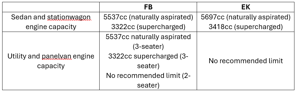

A question on the Ozrodders site made me wonder a little. With all the NCOP engine limits, I had heard a legend that you could “engineer a car as a commercial vehicle with no engine constraints”. I had always thought it was a myth (or that someone was stretching the rules beyond their intent), but decided I would see if I could understand how it works. Forgive this long-winded post as I try to put down on paper the logic. It duplicates some info earlier in this thread, with apologies.
CAVEAT: At any stage of the argument below, an engineer can say “Naah, all good, you can have a much larger engine”. The story below is not about “my engineer will approve anything”… its more about “this is what the rules give as guidance to the engineer”.
National Code of Practice for Light Vehicle Construction and Modification (NCOP) Section LA Engine Section 2.13 Engine Capacity Table LA Recommended Maximum Engine Capacity sets engine constraints for vehicles. NCOP Section 2.13 Vehicle Mass says that the mass of the vehicle referred to in Tables LA1, LA2 and LA3 is the original (unmodified) tare mass of the model vehicle fitted with the largest engine available for the model in Australia but without optional accessories (air conditioning, tow bars etc.). The mass of the vehicle, whether it is a sedan, station wagon, utility, etc., should be based on the heaviest sedan version of the model sold in Australia. We saw in the post above that a defendable set of calculations gives:
NCOP Table LA outcomes.png (22.27 KiB) Viewed 14274 times

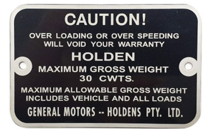

GVM is defined as “the maximum laden mass of a motor vehicle as specified by the ‘Manufacturer’.”. It is equal to the kerb weight, plus the driver and passengers, plus the load (effectively everything that the car is designed to “push down on the road with”). For the early Holden commercials, the GVM was referred to as gross weight, and noted on a tag in the engine bay. The tags look like this:
Maximum gross weight plate.png (370.12 KiB) Viewed 14274 times

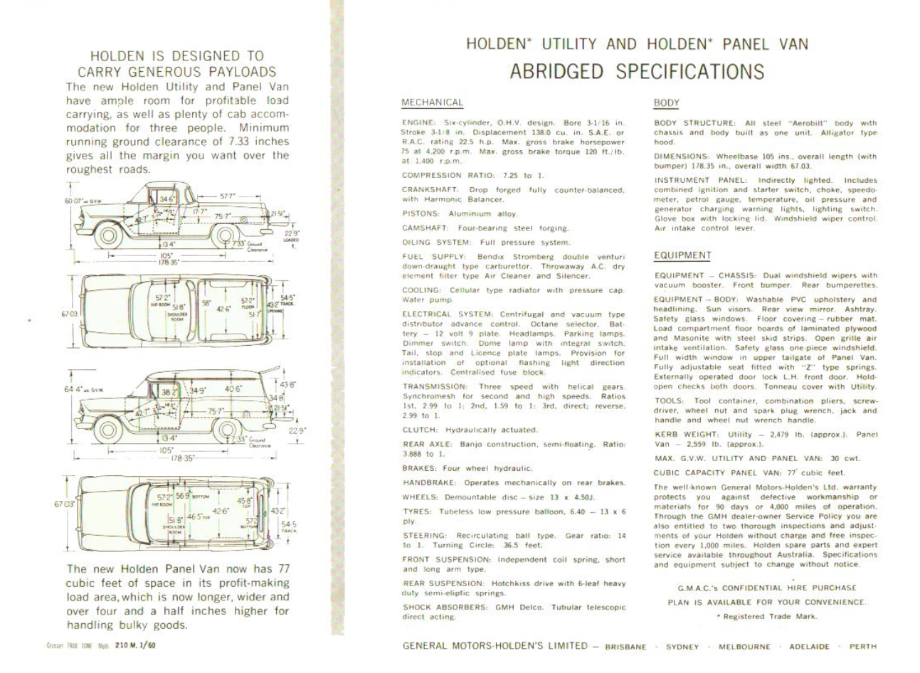

The information is also contained in the Commercial sales brochures released by GMH. The front cover and specifications page for FB commercials looks like this:
FB Holden commercial sales brochure first page.png (1.4 MiB) Viewed 14274 times
FB Holden commercial sales brochure specifications page.png (1.37 MiB) Viewed 14274 times

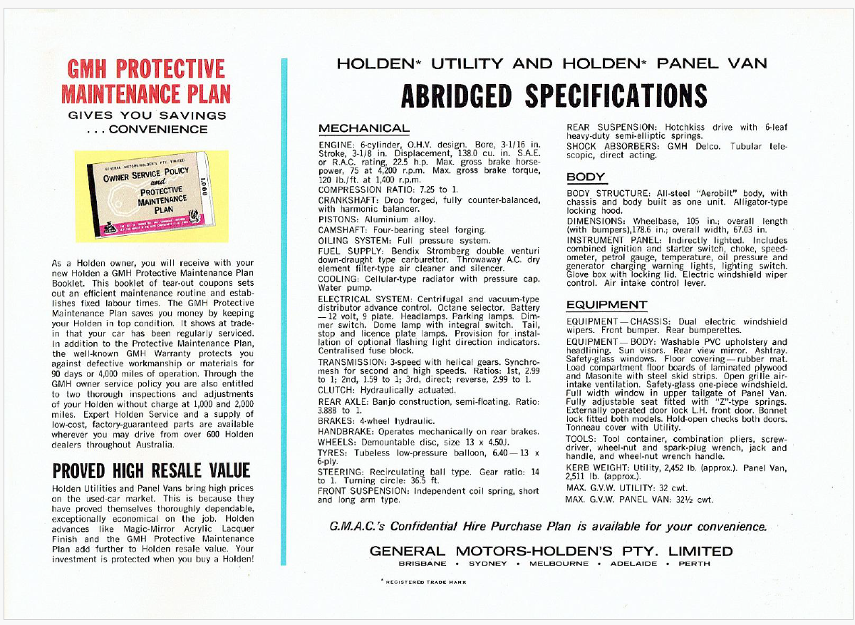

… and the front cover and specifications page for the EK commercials looks like this
EK Holden commercial sales brochure first page.png (2.05 MiB) Viewed 14274 times
EK Holden commercial sales brochure specifications page.png (1.38 MiB) Viewed 14274 times
From our early Holden engine bay tags and the commercial sales brochures:
FB Holden van GVM (gross weight): 1524.1kg (30cwts)
FB Holden ute GVM (gross weight): 1524.1kg (30cwts)
EK Holden van GVM (gross weight): 1651.1kg (32.5cwts)
EK Holden ute GVM (gross weight): 1625.7kg (32cwts)
We are also going to need the “unladen mass”. The Vehicle Standard defines this as “the mass of the vehicle in running order unoccupied and unladen with all fluid reservoirs filled to nominal capacity including fuel, and with all standard equipment.”. This is equivalent to the “kerb weight” given in the workshop manuals, though again we will need this number for both utes and vans, not just “the heaviest sedan version of the model”.
From the factory workshop manuals for our early Holdens:
FB Holden van unladen mass (kerb weight): 1160.7kg (2559lb)
FB Holden ute unladen mass (kerb weight): 1120.4kg (2470lb)
EK Holden van unladen mass (kerb weight): 1139.0kg (2511lb)
EK Holden ute unladen mass (kerb weight): 1112.2kg (2452lb)

In summary:
NCOP provides engine guidance for modifying FB/EK Holdens. There is significant flexibility in what an engineer can approve. A defendable, NCOP compliant position for engine capacity is shown in the table below:
NCOP Table LA and commercial outcomes.png (30.57 KiB) Viewed 14274 times

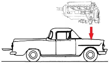

HHHHHMMMMMMM- is it time to measure up the ute for a merlin conversion ???? :ebiggrin:
Posts: 5749
Re: Maximum engine size for FB/EKs Holdens under NCOP
Blacky wrote: Sat Aug 30, 2025 11:04 pm HHHHHMMMMMMM- is it time to measure up the ute for a merlin conversion ???? :ebiggrin:
It's like your reading my mind...Grace's ute still has the motor in it with zero oil pressure.
This is (roughly) to scale:
merlin into an FB ute.jpg (29.74 KiB) Viewed 14249 times
Must...... resist..... temptation.... need..... to.... sell..... ute..... no.... more..... projects.... :lol:
