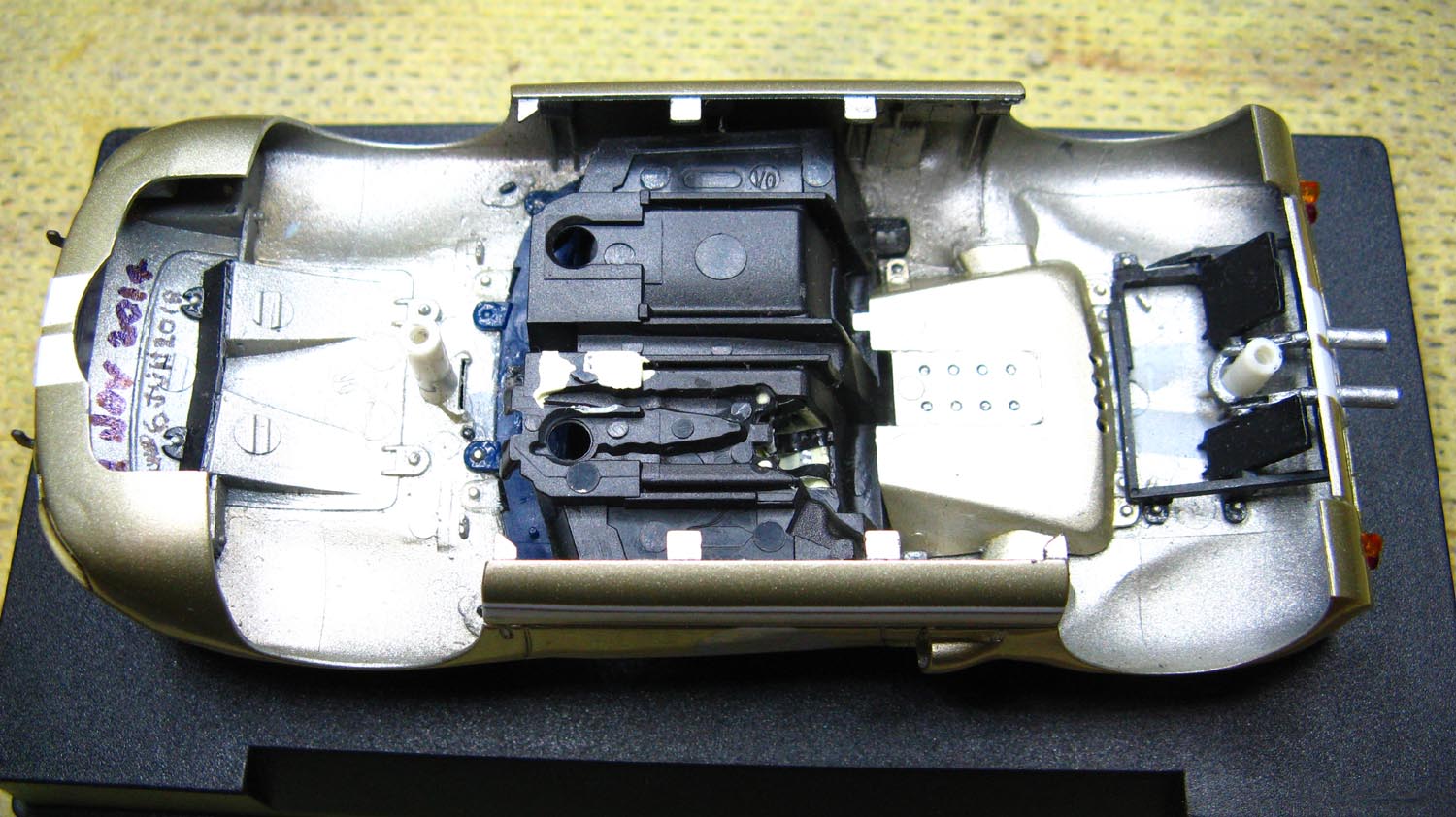

There has been a lot of work done in here... the body has been "gutted" - scalloping out weight from different places to better balance the model.
Strangely, the cabin interior "meat" was in exactly the right location (Slot It got this right) and reducing body fat from the surrounding body areas achieved the best end result....
006 Godzilla body internal mail.jpg (193.14 KiB) Viewed 14934 times
