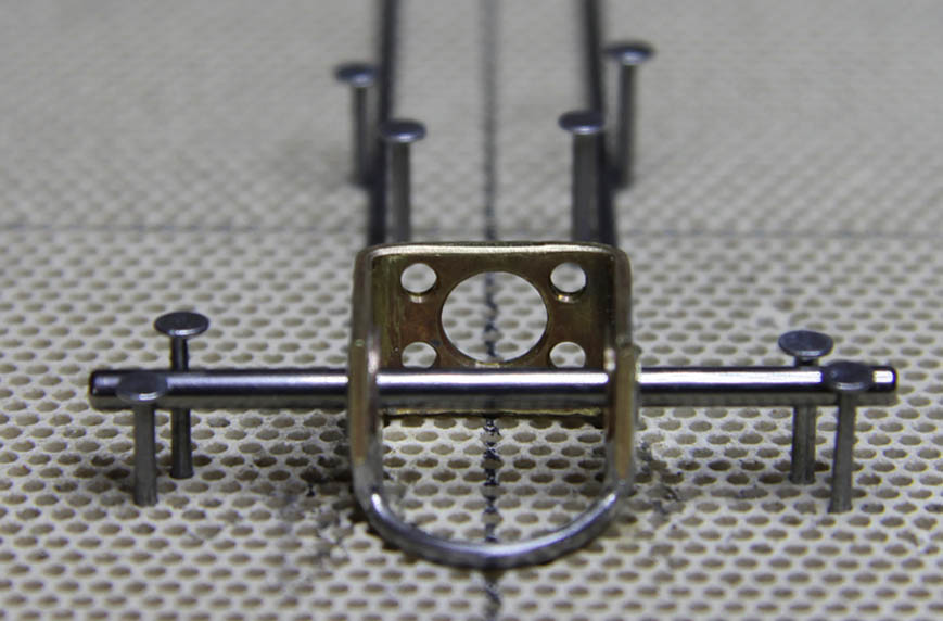

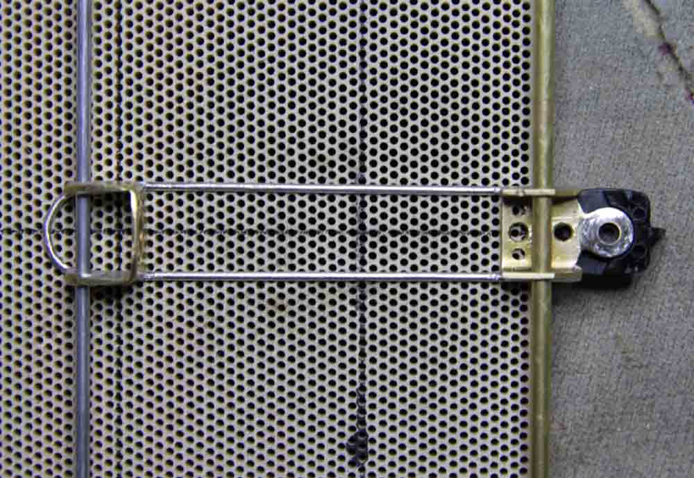

This is where it started out... on a ceramic tile - brass rear axle bracket and piano wire set in place ready to solder.
Measurements had to be pretty much within 1 mm either side of scale prototype for the series (Tasman proxy).
Cooper 1 rear bracket 002 mail.jpg (85.51 KiB) Viewed 10897 times
Then the front axle mount and guide bracket were positioned... keeping everything in exact place until soldered was a challenge.

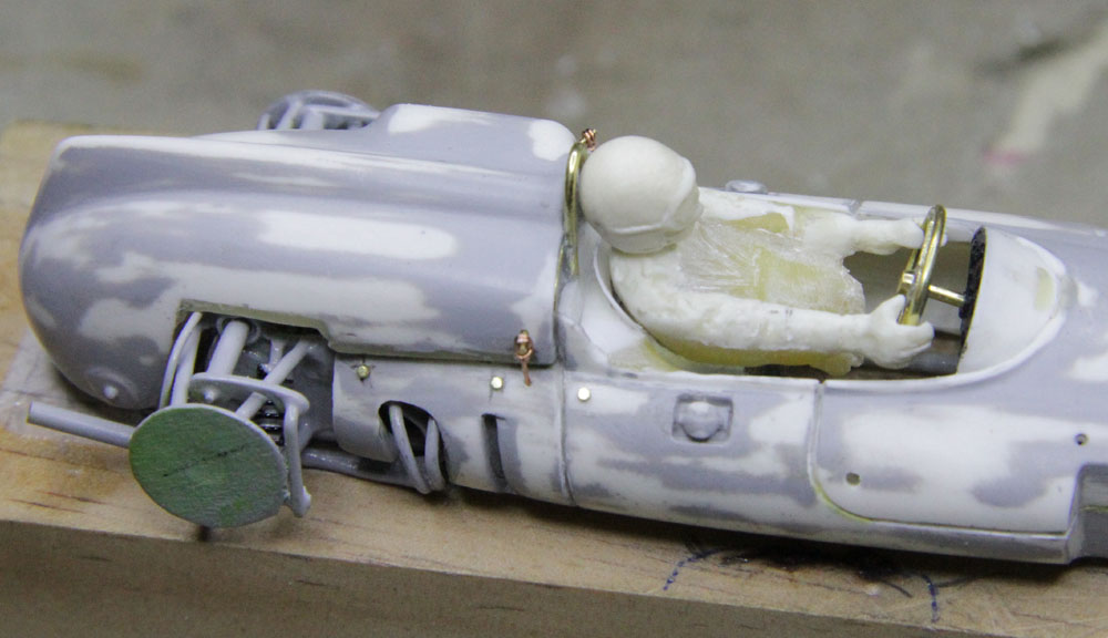

Ok - we better get to the body... most of the chassis was done by now.. but it needed more added and adjusted to get a "floating fit" for the body.
Slot cars go an awful lot quicker if there is "float" between the body and the chassis... even just 1/4 of a turn of one mount screw can mean 1 second to a 7 - 10 second circuit... this is all done when tuning the car... and there is an awful lot to learn about getting the most out of every bit of it.....
The body - detail.... when you first look at this little car, you'll be forgiven for thinking this was how the resin cast came.... trust me, it didn't.
I spent nearly a week on it with a dremel and files... getting as much "weight" out of it as possible, it was almost paper thin in some parts where there wasn't any concern for stress... the section which needed beefing up was the mount post.. just forward of the windscreen... I had to build a lot of strength into that, without adding too much weight... the sides were scalloped out to remove "fat"... vents were made open...
Then came along my need for detail... you can probably pick up the rear hood as being a separate part from the front.. I cut the body in half at this joint.. that's where the prototype did - it pivoted on a rear axle lifting upwards from behind the driver. I made this pivot plate out of brass and drilled out the five bolt holes.. then filled them in with brass rod... the spring loaded "catch" at the front of the hood was also made and fitted.... I wound the spring "coil" around a brass rod and soldered the catch mount and retainer to it.. drilled out the body - then fitted it....
I also drilled out the body where the button panel retainers were and fitted brass rod into those...
What you can't yet see, is the four ram intakes for the carby's.. they are hiding under masking tape beneath the cowling... we'll see the effect these make to the look of the model later...
Also, Bill's car had a unique extra fitting - a vent in front of the windscreen... I made this out of brass... we'll see a pic of his car at Longford in 1964 a bit later on in this thread...
Pic.. it's been etch primed, primed and rubbed back to get all the little imperfections out of the finish... it's identical to what we do with our full size FB's and EK's.. takes nearly as long.. but the process is all in "miniature".. no dust mask required.. and much less mess to clean up.

Next, we needed to put everything together - before committing to paint.... I fitted Bill before I painted him along with the steering wheel.... Bill sitting on the motor and the chassis in position under the body... we haven't yet set the single body mount screw ... the two sides of the body and cockpit were made to nestle down over the motor.. to centralise it on the chassis.... once that was done, the mount post could be drilled and tapped for the single brass counter-sunk retaining screw... as mentioned, the body has to "float" on the chassis to get the best out of it...
cockpit 001 mail.jpg (100.42 KiB) Viewed 10894 times
Speaking of Bill.. we'd better show what I did with him..... the body which came with the resin kit was pretty ordinary... looked like a "chimp".. I spent about a day re-profiling it to get it to look almost human... then set about making up a helmet and goggles which were close to what Bill wore.... I painted his flesh and used Aquadhere to fill in the goggles... giving a clear finish.... this I learned from making headlights on model locomotives... I then hand painted the frame of his goggles with flat black using a tiny brush...
Bill 001 mail.jpg (102.34 KiB) Viewed 10894 times
