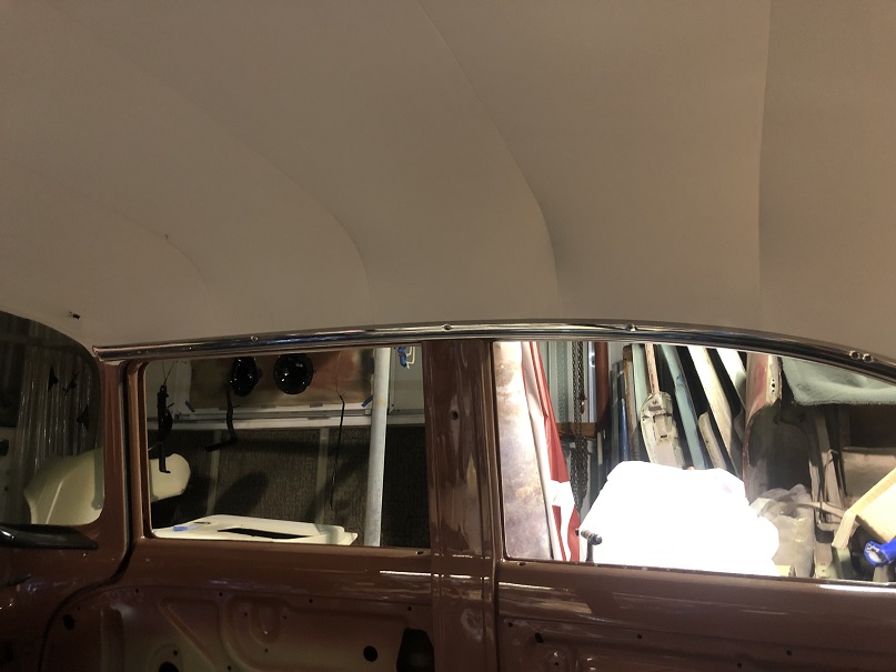

Headlining in, bugger of a job !!! A couple of wrinkles which should come out in time and its the best I could do considering.

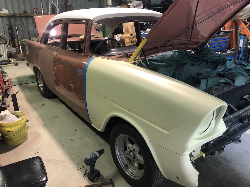

Started wet sanding for a couple of hours, more door and guard work tomorrow !!!

Don't fret about those wrinkles... you haven't fitted the trim yet - they will pull a bit more out of them....
I have been led to believe that using a hair-dryer carefully will "shrink" the material..... there have been posts on this somewhere in this forum, fair while back, from memory.

Get yourself a little karcher steamer - they are perfect for that - some clothes irons can be used the same as well - it really makes a big difference to go over the lot with a steamer - it relaxes and sets the fabric if that makes sense - we use them al the time in textiles retailing.

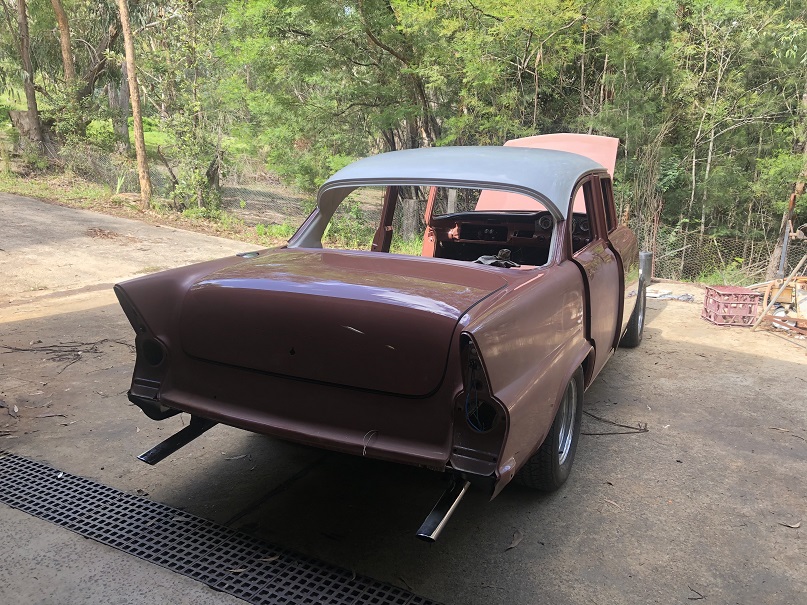

The exhaust is hanging low at the moment as the bumper irons have tags welded on as hangers, they have been painted but I'm waiting on the tail light chrome to be done (second time around) so cant put the bumpers back on. You know how it goes !!!
Thanks for the comments guys, will try the steaming on the headlining if it doesn't settle in the next week or two.

let the headliner hang where it is for now, heat gun only on a headliner, nothing else.

Headliner is coming good !!

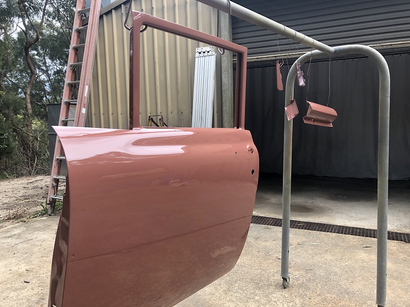

Painted the front passenger door and its got shit in it everywhere, Just had one of those days !!! All the wind has blown all sorts of stuff onto the roof of my spray area, as soon as i turn it on dust gets sucked in and across the paint. I'll have to clean it before anymore painting goes on. The door is straight but I'll have to do it again, oh well what can you do !!!

Has to be done, Greg.... that would drive me nuts if I didn't rub it back and respray it.... nuisance, yes - but it won't happen again.
If it is of any help, if I'm spraying on a concrete floor - I sweep out, blow out and then throw a couple of buckets of water across the surface of the floor... just before I spray. The water tends to attract and hold heavy airborne dust that gets thrown up with the air from the gun... it comes out of anywhere... unless you have a sealed booth - there is never a guarantee that you won't get dust in the air.
We're a bit lucky with acrylic - it dries pretty darned quickly..... 2K is a nightmare - seems to take yonks before the paint stops being a magnet for anything attracted to it...
The openings in the apex of your roof are a trap for crap like that too.. one gust of wind and stuff which has been up there for years can break away...
I fitted rolled up insect screen to the openings under the metal cover sheet in my shed.... stops a lot of tree crap getting into the shed...
Door, glovebox, quarter vent covers and ashtray all look pretty darned good to me.. but, I'm not 2' away from them... I feel your pain, but - it's just a nuisance - not a biggie...... like dropping a door onto the ground....

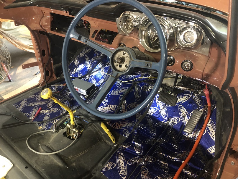

Bit of dynamat down late this arvo.

Anyway you're getting there. Good progress. What is the steering wheel, HKGT?
