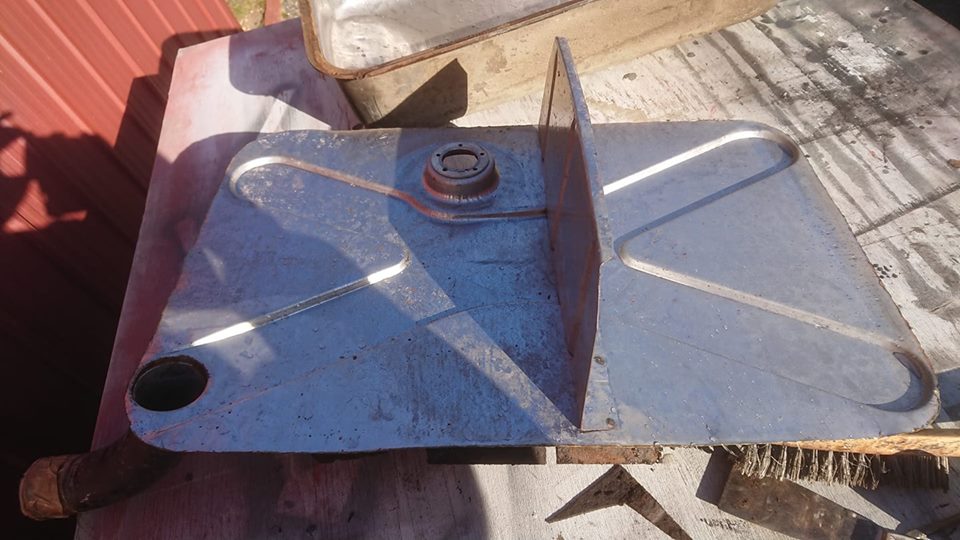

Same top will be Tig welded back in place.

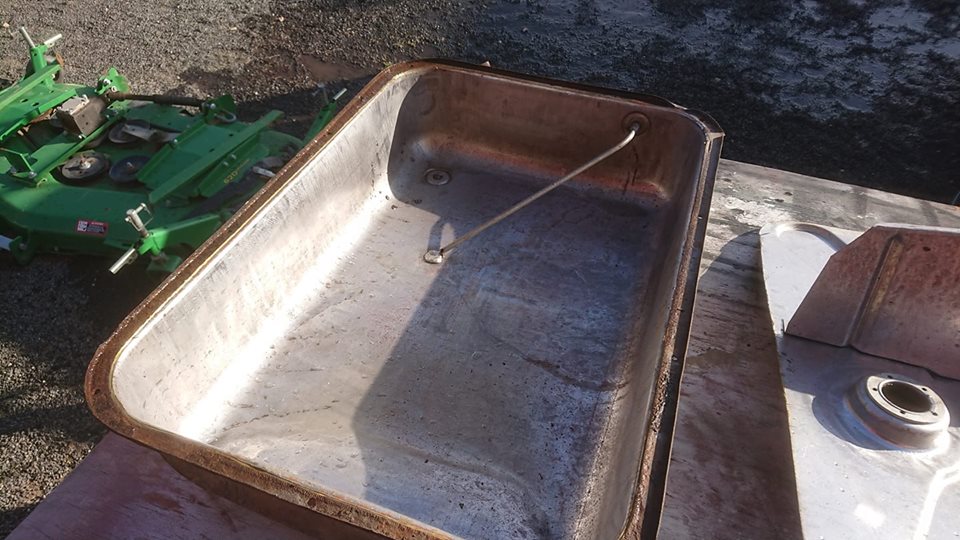

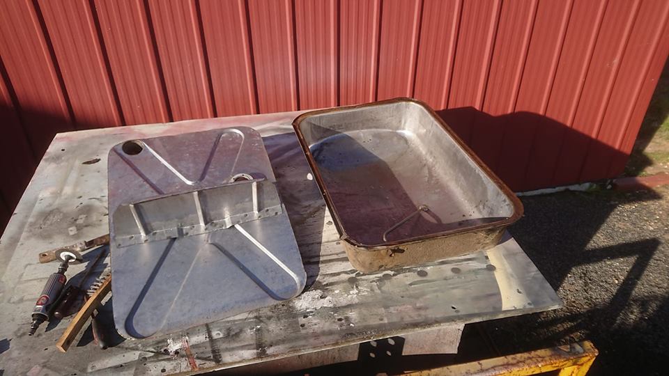

Re: Seagull Grey EK 2106
Opened and looking ok. Just some dent work to do.
Thanks for showing Craig. Never seen inside one of these. It looks spotless, like it has just been galvanised. Have fun putting it back together.
Nice work Craig. How does the lid come off, is it soldered so you can use a gas torch, or welded and needs cutting and grinding, or a bit of both?
I think they are seam welded i.e. similar to spot welding. Lid section has been cut out just on the edge of the welded seam joint.59wagon wrote: Mon Aug 27, 2018 3:58 pm Nice work Craig. How does the lid come off, is it soldered so you can use a gas torch, or welded and needs cutting and grinding, or a bit of both?
I could be wrong, but I suspect that they are mild steel which is then tin plated. Once the tin is damaged (say a heavy scratch that exposes mild steel), they set up their own electrochemical rust cell (two dissimilar metals). The bottom of the tank is usually dry (no electrolyte, little rust), but the topside is often moist (leaking boot) and rusts out first.
Yes Harv I suspected similar. I'm reading that the material that may have been used is called Terne metal. This was a common fuel tank material with lead content. I was always worried about disturbing the corrosion protection (what ever it ruined out to be) and think I will have to do some acid washing after the lid is welded back on the seal the tank internally with POR or something similar. I'm wondering if I could get it re-dipped (galvanised) after I've done the work as an alternate option.

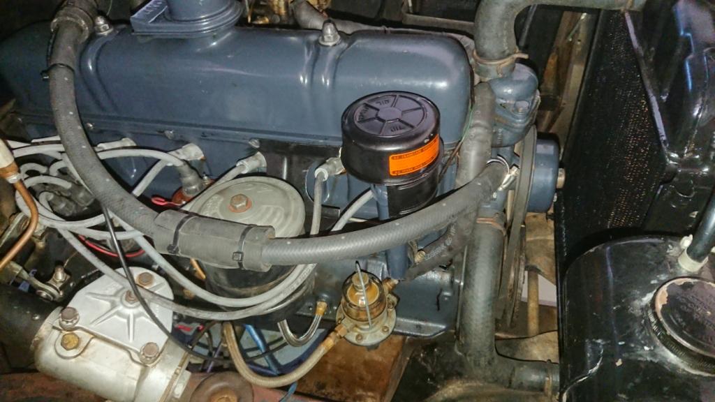

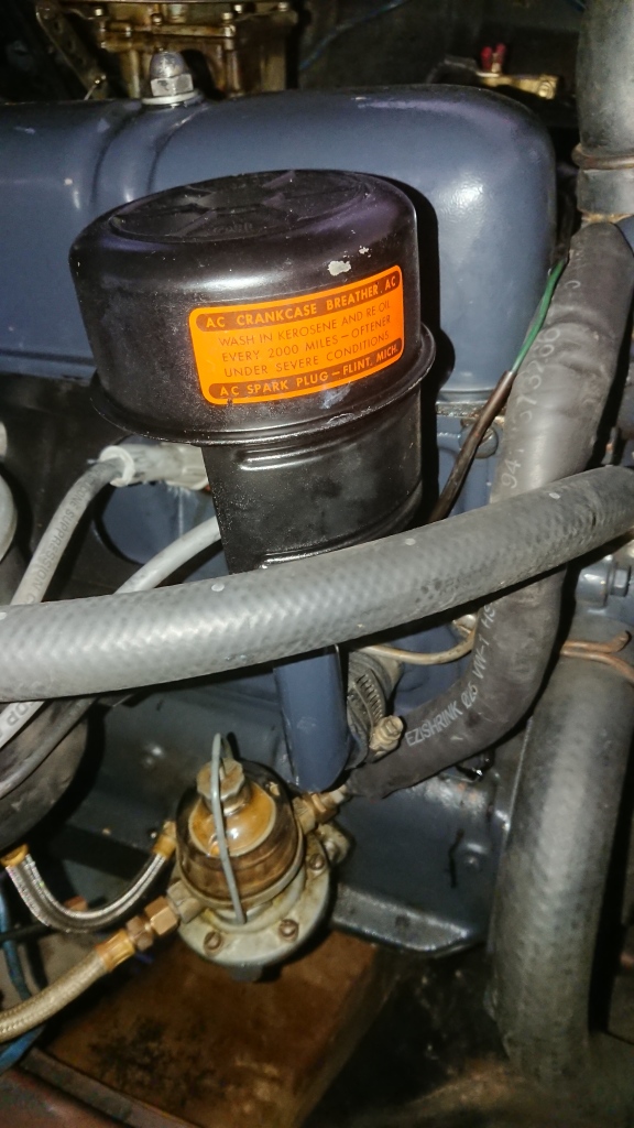

One more oil leak to master after this solution.
