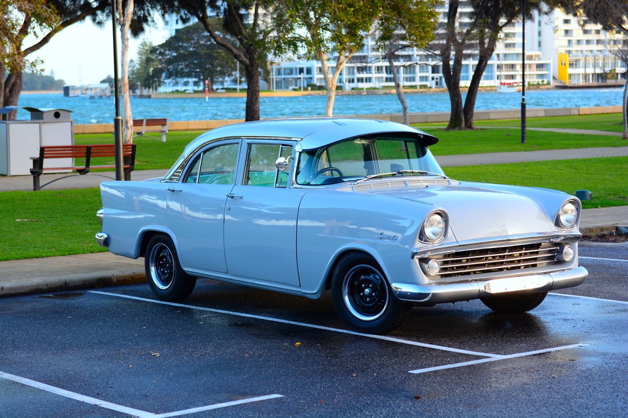

but here's a little one from the Nats carpark in the mean time

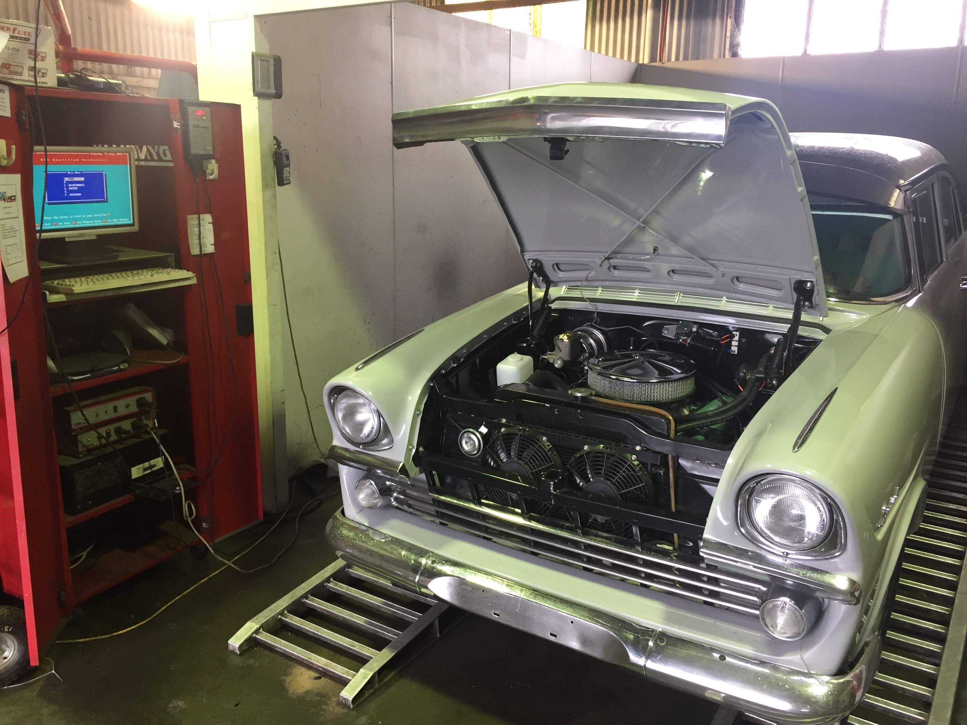

However i did get my Dyno reading and tune that's required... can't recommend Brendan at HBS in Byford enough.
the numbers for those interested... ignore the right column, the red line was the off the trailer at 120, the blue was the 4th pass off memory after a few tweaks here and there

Pretty good for a mild 253 😎👍 looks like you will be ready for our next cruise night on August 3 !!?
Re: NoMAD's Kustom FB Sedan
Gotta be happy with that! Now hurry up and get it regoed so you can lower it properly.... :mrgreen:
