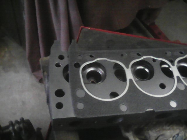

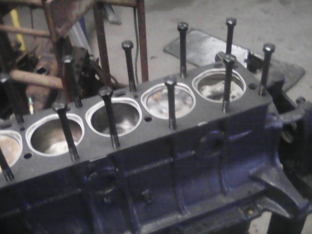

Compeleted the re work of the block and head for the new improved head gasket. For anyone about to do this makes sure you use sufficient dowels or head bolts to set the head gasket in place. Once thats done and the gasket is in its best possible position, ensuring even alignment over all holes, go and mark the areas over the back two coolant passages.You will see the new gasket is a really good fit on the block, but the head is another issue. I think this would be due to casting inaccuracies. What all this means is that I had to use a die grinder to enlarge the holes in the head due to a slight offset needed at both holes. The block was fine with no offset needed for either hole. I also found it was better using the die grinder and a vacuum rather than a drill that would cause larger casting chips and would tend to chunk out the casting inside the block. Also didn't out of preference go to the max on sizing out the larger of the two holes due to its proximity to the combustion chamber seal. There's not much meat there between the coolant passage and chamber which could be a path for cumbustion leakage and pressurisation issues.
