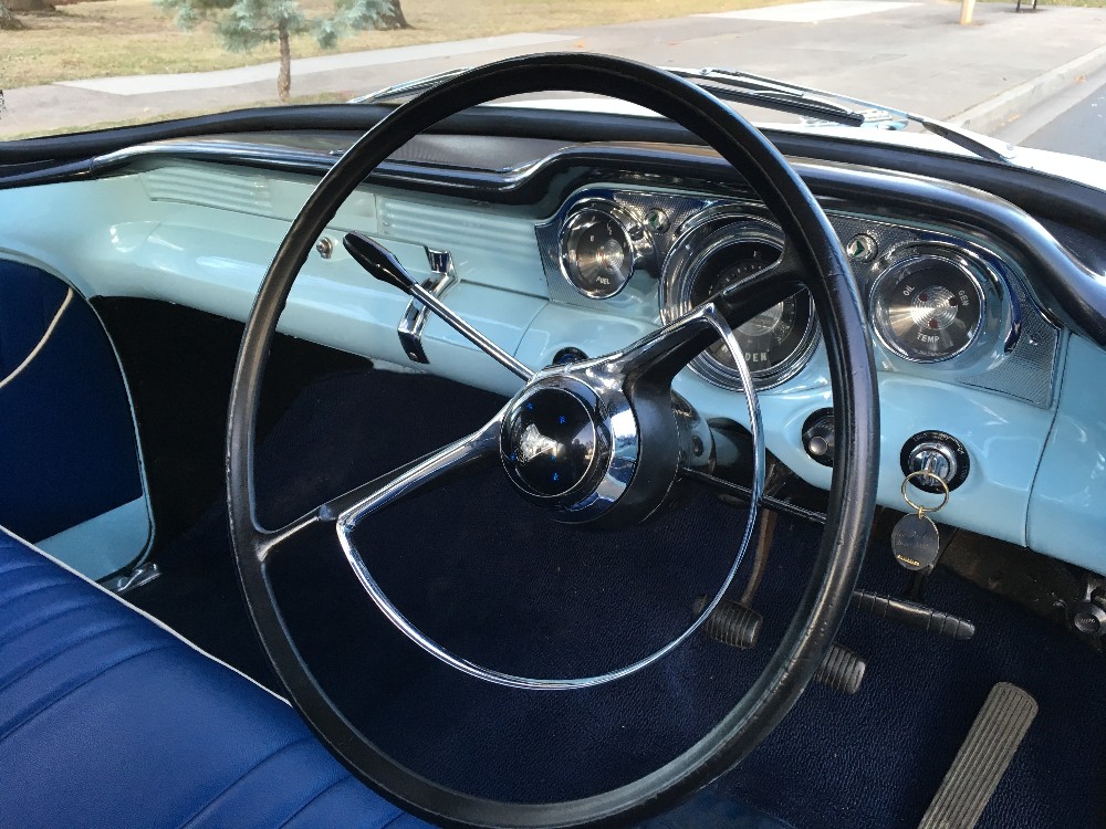

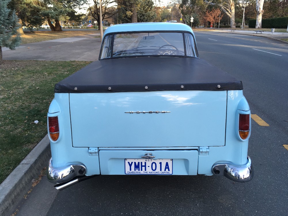

And "AP's Ute/Pa's Ute" is finished AP Parker! Registered during the week and took the old man to the ACT Holden Day today. Huge thanks to Mario for days on the welder. Special thanks to Gavin Lockwood for the interior, Glass 4 Cars, John Res Auto, ACT Brakes, Phillip Radiator Service, Electroplating Technology (chrome work), and many members from the FB-EK Holden Forum (Blacky, Greg etc.) and Facebook pages. And of course to my old man for 10 years of hard work and for my wife for putting up with my tantrums and poor bank balance. 17 years not being driven ... time to make up for it.
Posts: 14320
Re: Pa's Ute
awesome news mate 👍👍😎😎
It's all worth it the first time you hit the road with a fresh set of plates screwed too it 😎😎😎
