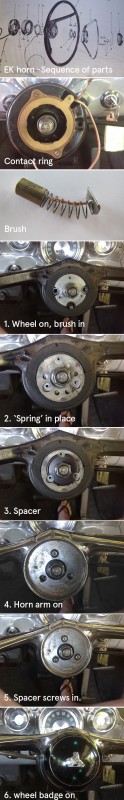

Hi all,
I am having trouble with the horn assembly on my EK. Got a New contact ring (original) and Brush ( rare spares) and the manuals sequence of order placement. I have all the parts but no success making it feel right. No springy-ness to it like it should.
This post by Roscohttp://www.fbekholden.com/forum/viewtopic.php?t=6054
is very concise and thorough, but i am still not having much luck.
Posting these images up to show the parts and how I am doing it - if anyone can see whats not right here pls let me know.
cheers
Gossy

I seem to do this too every time I put the horn back together. From memory it's either the spring and spacer in the wrong order, or the spring is the wrong way up.

Thanks Harv,
Will try it out.
