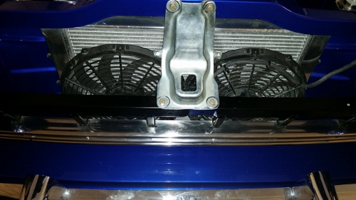

Not sure if this will help Nathan but its a pic of how I did mine, I also used the SPAL fans, recessed the radiator into the support and welded on locators to the bonnet striker, and the bottom locators on the fans fitted perfectly into holes in the stone guard (or what ever its called) that the grill bolts to. Works a treat for my 308 (stock as a rock).
Cheers Mark

cheers marko... thats something to consider the ac condenser throws a spanner in there so what other people have done definitely helps when looking at it.
which fans did you use if you know the model no's... would just be curious is all.
